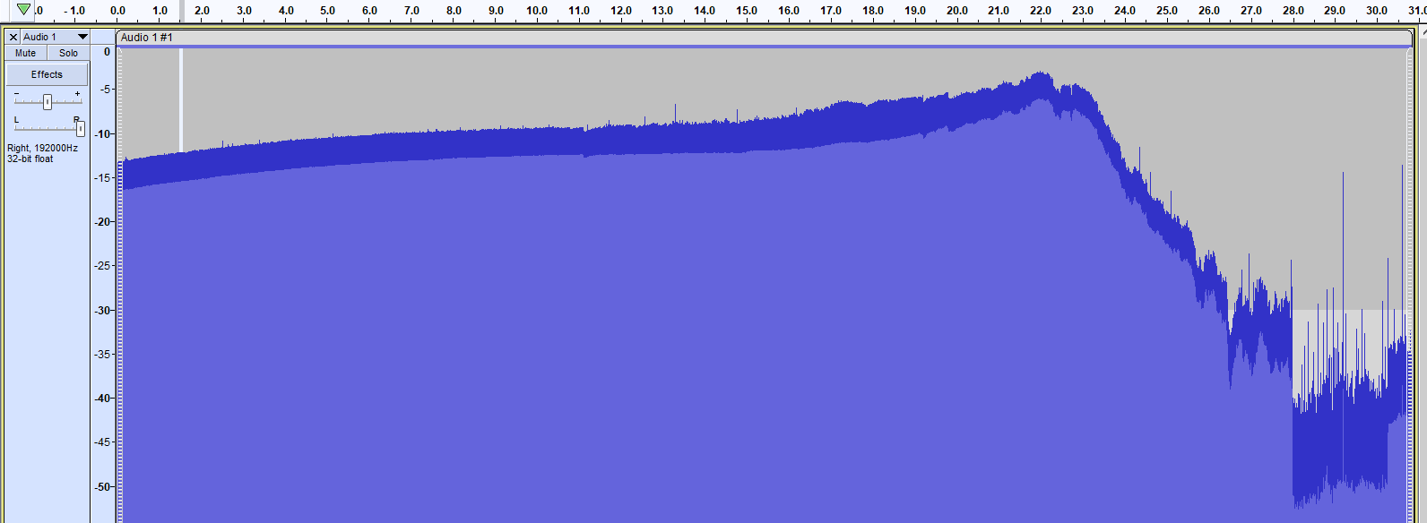

Sweep recorded with linear preamp (192kHz SR)

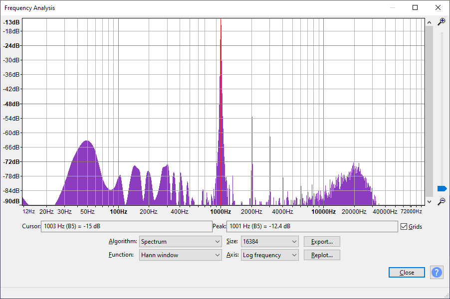

Let's take a pinch of it, select ~100ms somewhere and use Analyze -> Plot Spectrum feature in audacity:

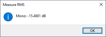

Peak at 1001Hz suggests this is the part of the sweep around 1kHz. Now let's use Analyze -> Measure RMS option.

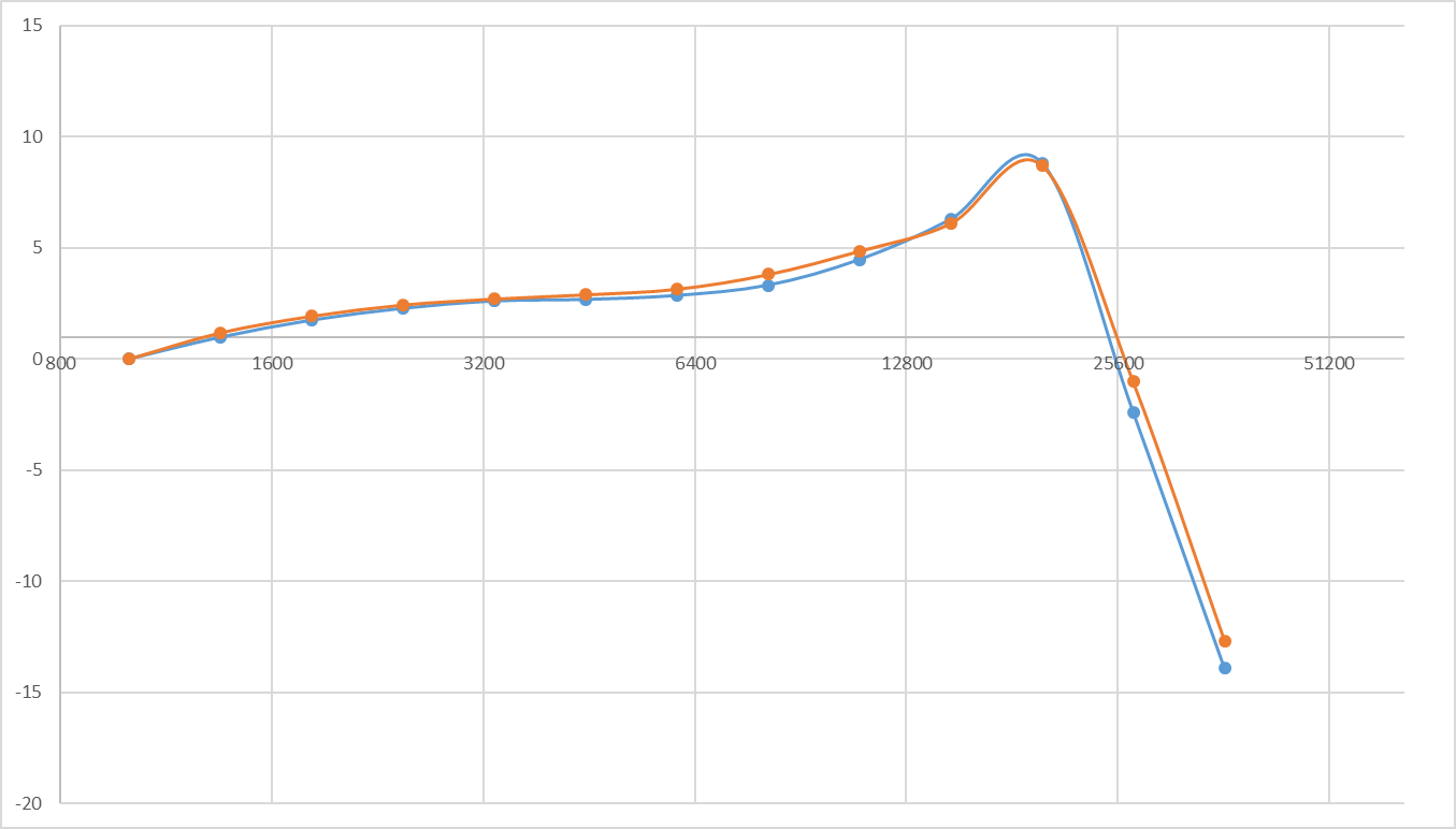

Write down (insert in spreadsheet) that value. Then continue doing the same in other parts of the sweep. With 10-15 evenly spaced measurements one can make a decent plot. Here is one made with 56k || 22pF + 110pF(cable) input impedance with a linear preamp (Left blue, Right red)
What surprises me the most is the deep below 2kHz. I don't know what causes it.
I have to clarify, the sound from LP I perceive as a kind of dull-ish when compared to CD. But it is evident only after comparison. Maybe this recessed mid is the cause of the subdued presentation.
Sorry for my late response but what puzzles me in the spectrum analysis plot is the increase in noise starting around 10kHz and peaking around 20kHz.
What causes this?

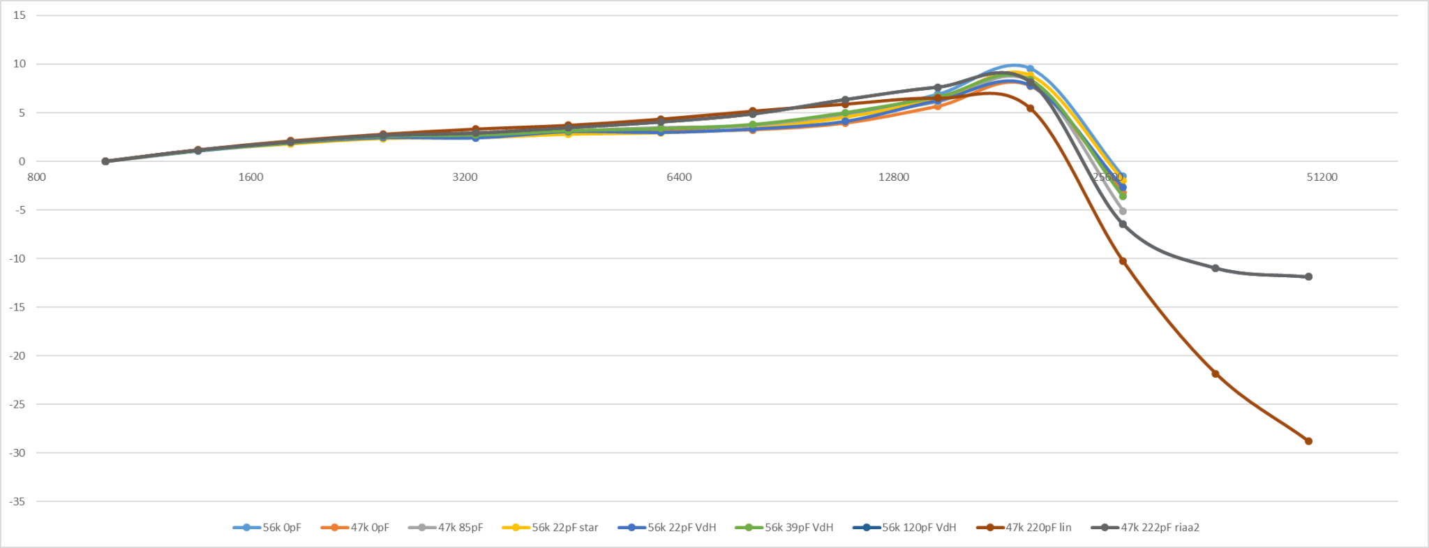

This chart includes old and some new measurements for comparison. Input load is stated in the legend. Capacitance values are without cable capacitance which is additional 100pF. Lower resistance/higher capacitance load reduces the peak @20kHz and fills the 5-10kHz region and subjectively is more balanced (I have in mind 47k 220pF curve). Cartridge is Goldring G1012GX.

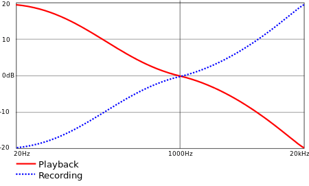

In other words, it is not recorded to be replayed correctly by RIAA equalisation. RIAA replay equalisation effectively adds a step equaliser (318us to 75us), plus low frequency cut (3180us) to equalisation of a velocity transducer. Why do this? Because it avoids record/replay RIAA errors and allows you to easily see what the cartridge response is.

Actually, it will only be 12.5dB higher. Remember that the RIAA replay response also includes compensation for a velocity transducer. What's on the record is constant amplitude, other than the modifications caused by the 12.5dB of the 318/75 step equaliser and the 3180 time constant. But you're right to say that the RIAA characteristic could cause high frequencies to be cut at such a level that replay could be problematic.
All the descriptions of record cutting and playback are confusing, using the term constant velocity and such rather than typical signal processing terms, like high pass, low pass, integrator and differentiator. I've spent the past month researching and modeling the RIAA EQ, cutting amp, cutter, cartridge, preamp, EQ signal path. My GNU Octave math model is still pretty crude, but I can take a line level signal, run it through all the models, RIAA pre-emphasis, cutting amplifier, cutter, record, cartridge, preamp, RIAA deemphasis and get a line level signal back out that matches. The Cutting system after the RIAA EQ acts as a band limited integrator, 20 dB per decade. The Cartridge acts as a differentiator 20 dB per decade. So there are 20 dB gains and cuts or more at each end of the spectrum at each stage. There isn't a true 'constant velocity' on the record as the RIAA curve isn't a constant slope with frequency. I will post the code here eventually when I get it sorted out so it is useful.
