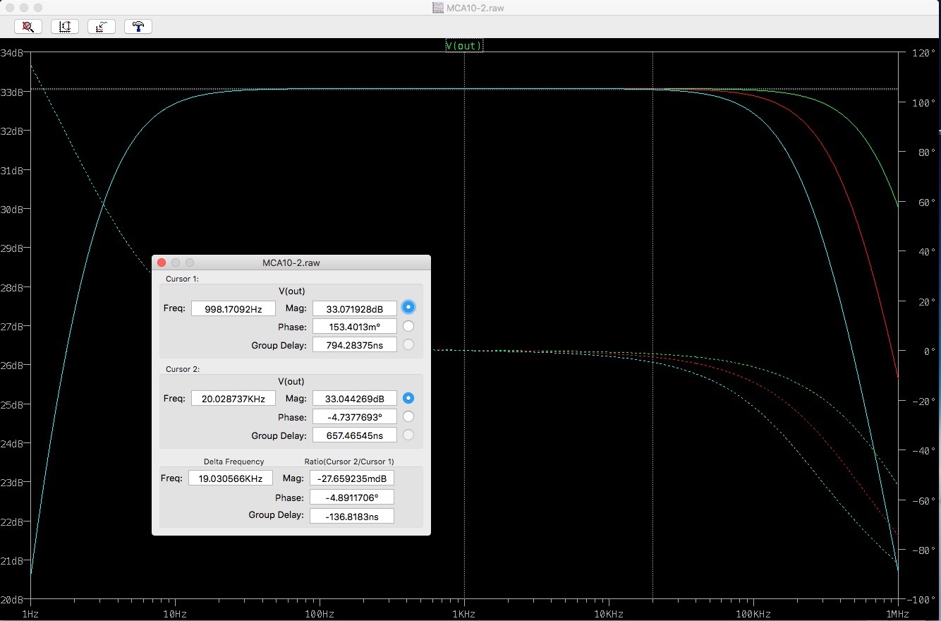

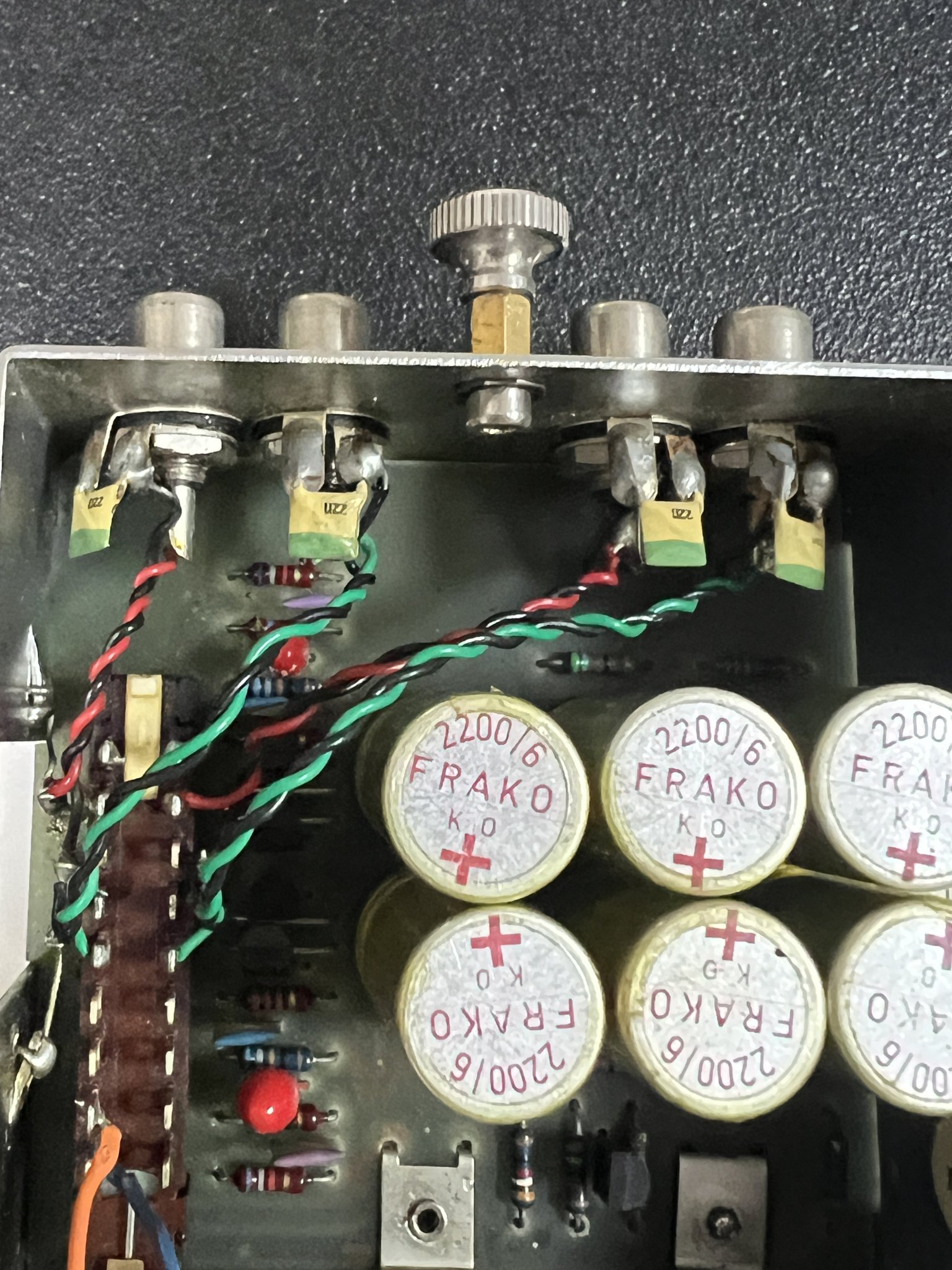

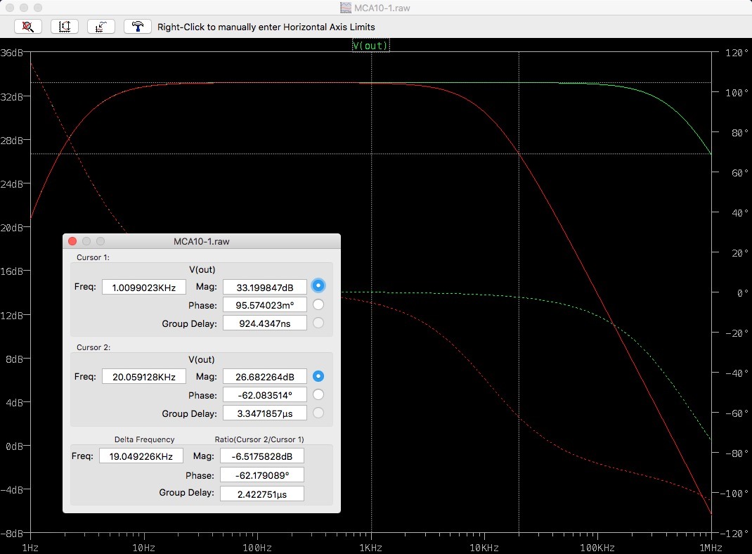

😵 Got English?感谢你做技术验证,22NF消减了高频,原始的MCA10在输入和输出的RCA连接器上都并联了22NF的电容器。这也是重建它的原因之一,重建的PCB适合任意修改,我附上一些原始的图片。
@zincho Please post in English and/or use a translator if necessary,
Thanks for the technical verification, 22NF attenuates high frequencies, the original MCA10 had 22NF capacitors in parallel on both the input and output RCA connectors. This is also one of the reasons for rebuilding it. The rebuilt PCB is suitable for any modification. I attach some original pictures.
