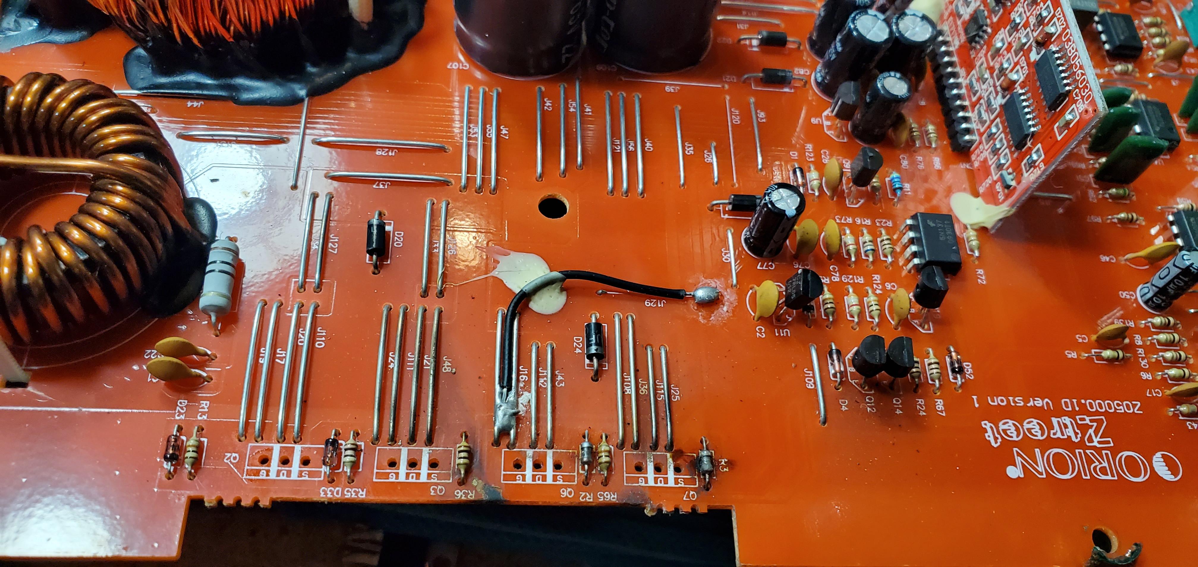

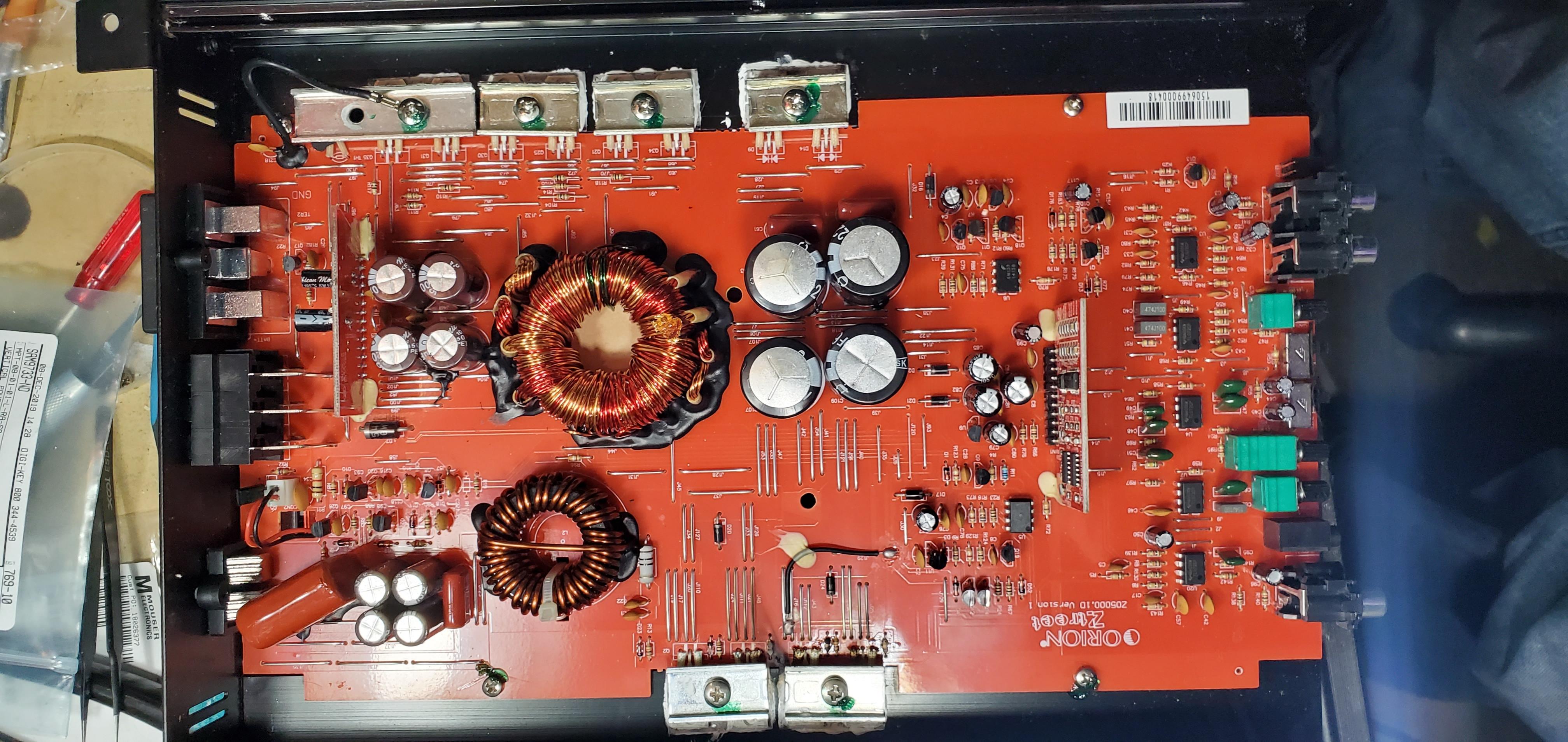

I have not seen one of the these amplifiers posted on here so I figured I would post some photos and hopefully get a question or two answered.
This amp uses P65NF06's in the power section and 10ohm Gate resistors.
Can I use IRF3205's as subs?
The audio section uses FQP19N20C with 10ohm gate resistors in the audio section.
Can I use IRF640's or IRF640N? I have both.

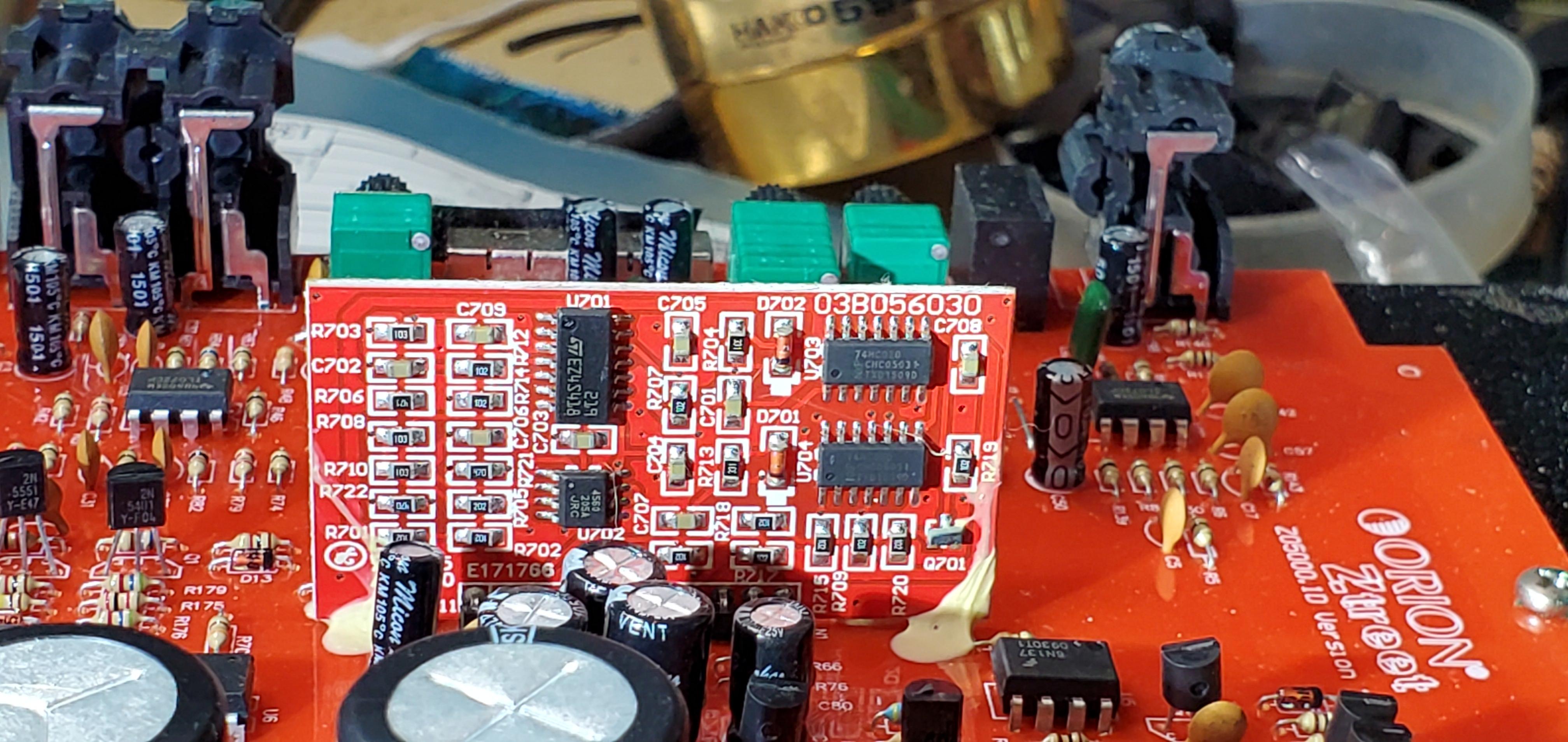

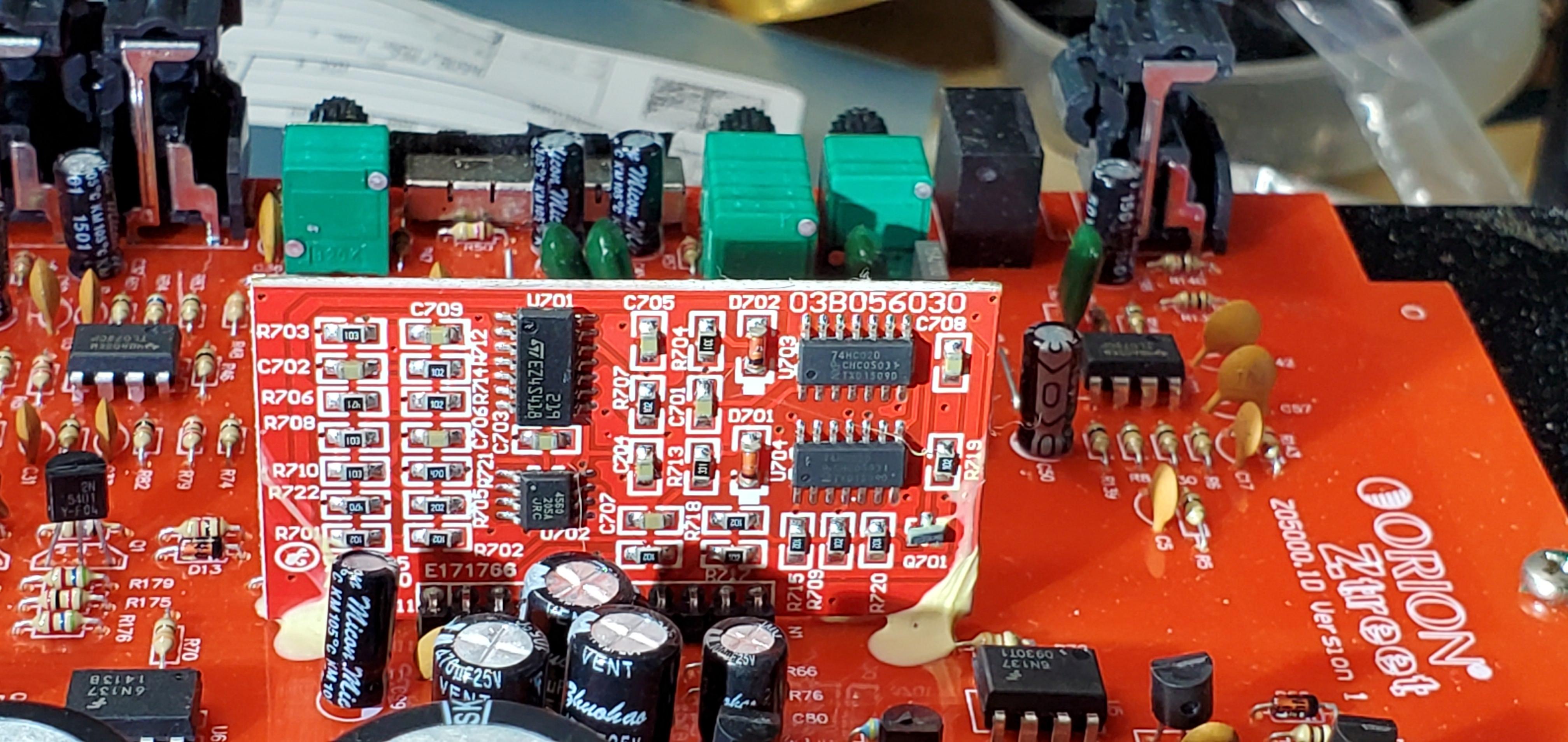

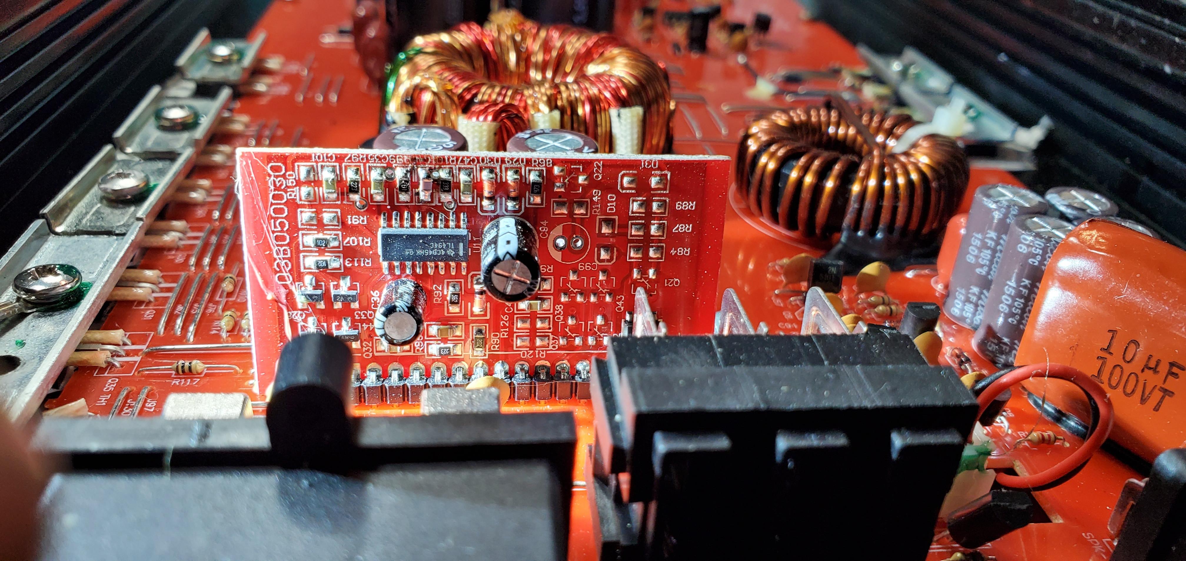

I have a batch of MM74HC02M from a JL1000/1 I had worked on. Would this work? I am unsure which one to order I have attached a photo for comparison. I am unsure of the difference between the 3.

The part numbers are similar but different and the comparison tool on Mouser is showing different specs. I am referencing the photo attached.
No. of input lines and No. of output lines. 74HC02D, 662 is showing 4 output and 8 input. I assume it is different than the other 2 I am not sure.
The one I have is a MM74HC02M.
I dont have any experience with this IC and the last batch I ordered I copied from the part number taken from your JL 1000/1 page.
I have minimal experience dealing with logic level stuff. Most of my experience has been with the Generic Class D Type 3, Type 7, and 8 as that is what I encounter most.
I apologize for wasting your time i should have checked the datasheet. The only differences i can find is the manufacturer, The ON Semiconductor max operating temperature is lower (85° vs 125°) and different packaging tube vs cut tape.
