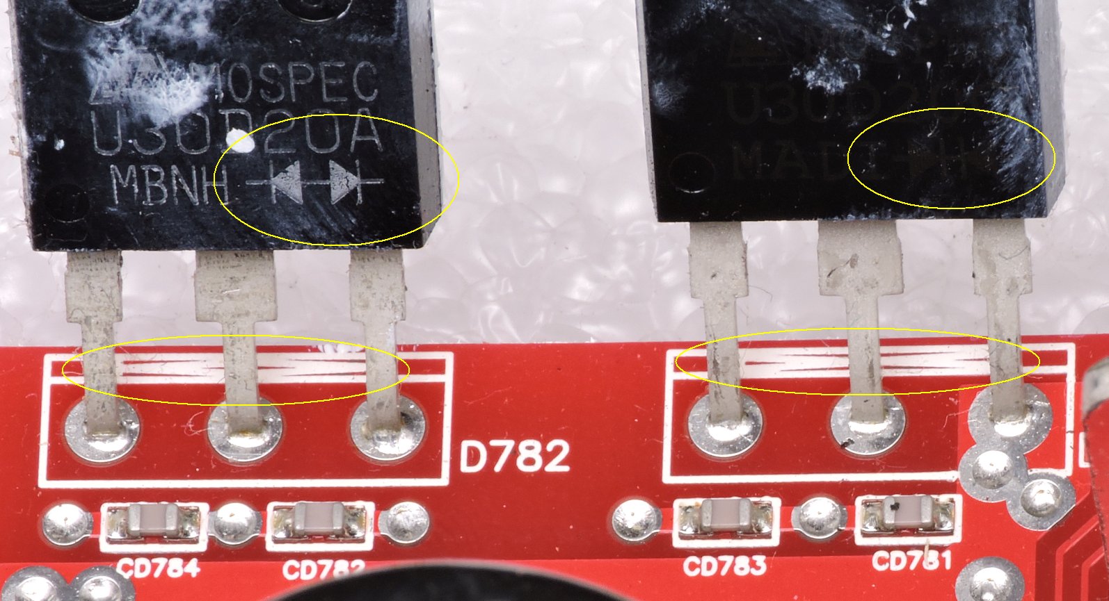

the board wasnt marked but thats what it was it had 2 of the mospec C Rectifiers, and needed a The A version, The owner must have removed it. It also does use 270R Gate resistors (Odd)
Anyway i got the amplifier up and running, replaced the output transistors as well.
After I fixed the rectifier, I just reinstalled them. A friend looked inside of their amplifier for me and took a picture of what's factory.
Previously, you had the rectifiers out when you couldn't get a good drive to the PS FETs.
