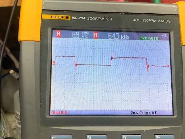

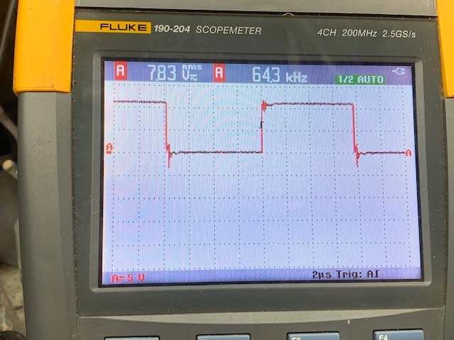

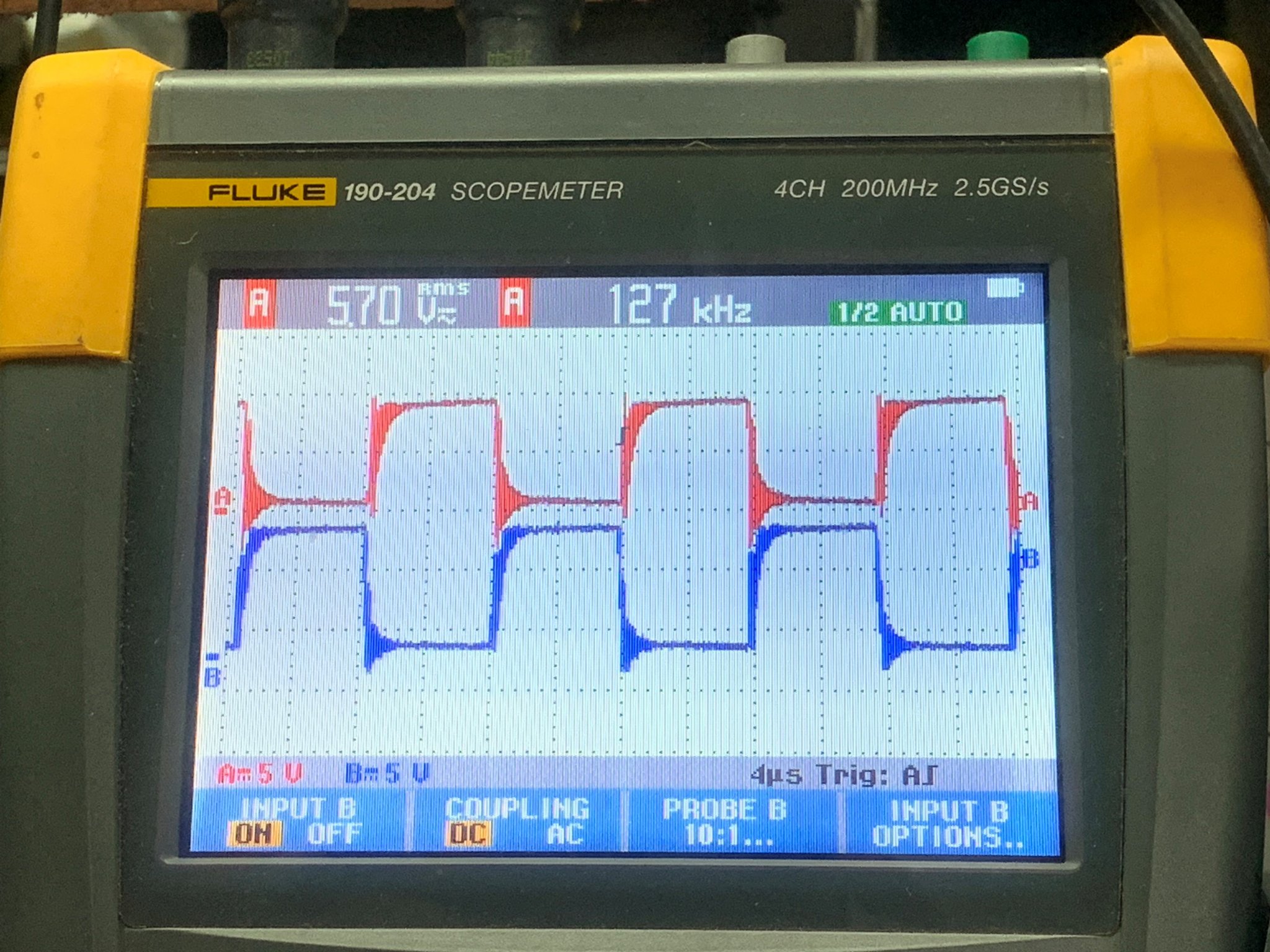

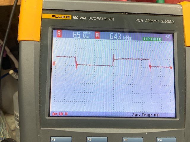

I got in an Orion XTR 2200.1D with blown output filter caps (electrolytics), replaced those with new. Amplifier powers up, good rails and reg LV supplies, passes clean audio.
I've noticed however without audio and a 2-ohm load connected if left connected at idle the heatsink gets hot to touch (after ~15mins). I did some probing around and found some ringing on the output FETs gate drive.
The output section appears to be original, how can I go about to reduce this?

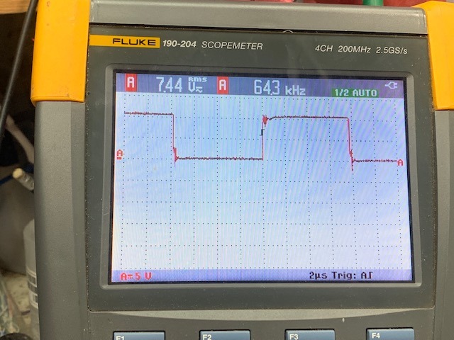

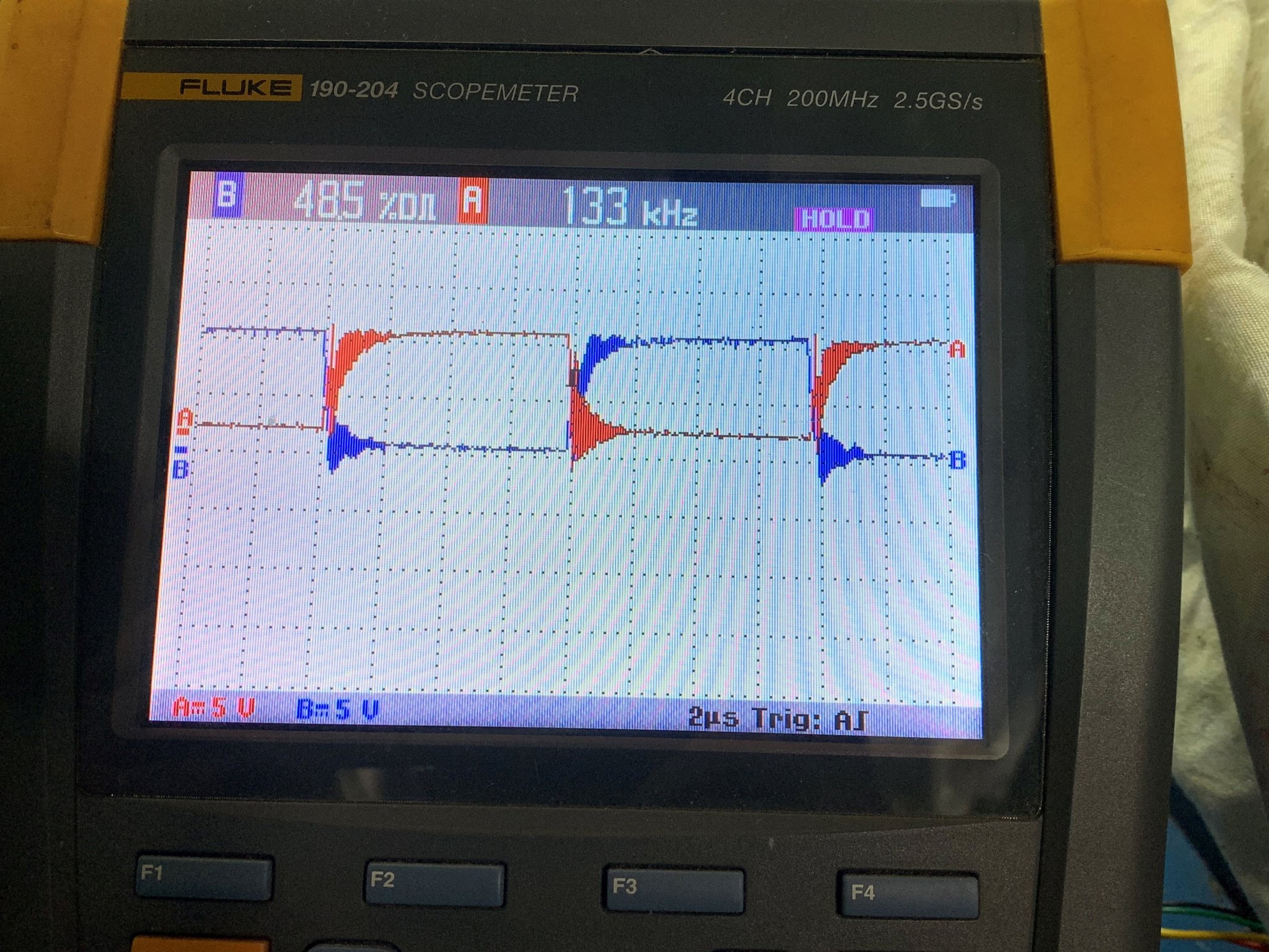

There's little ringing on the emitters. the measurements were taken with the black probe on the source of each respective bank of FETs.

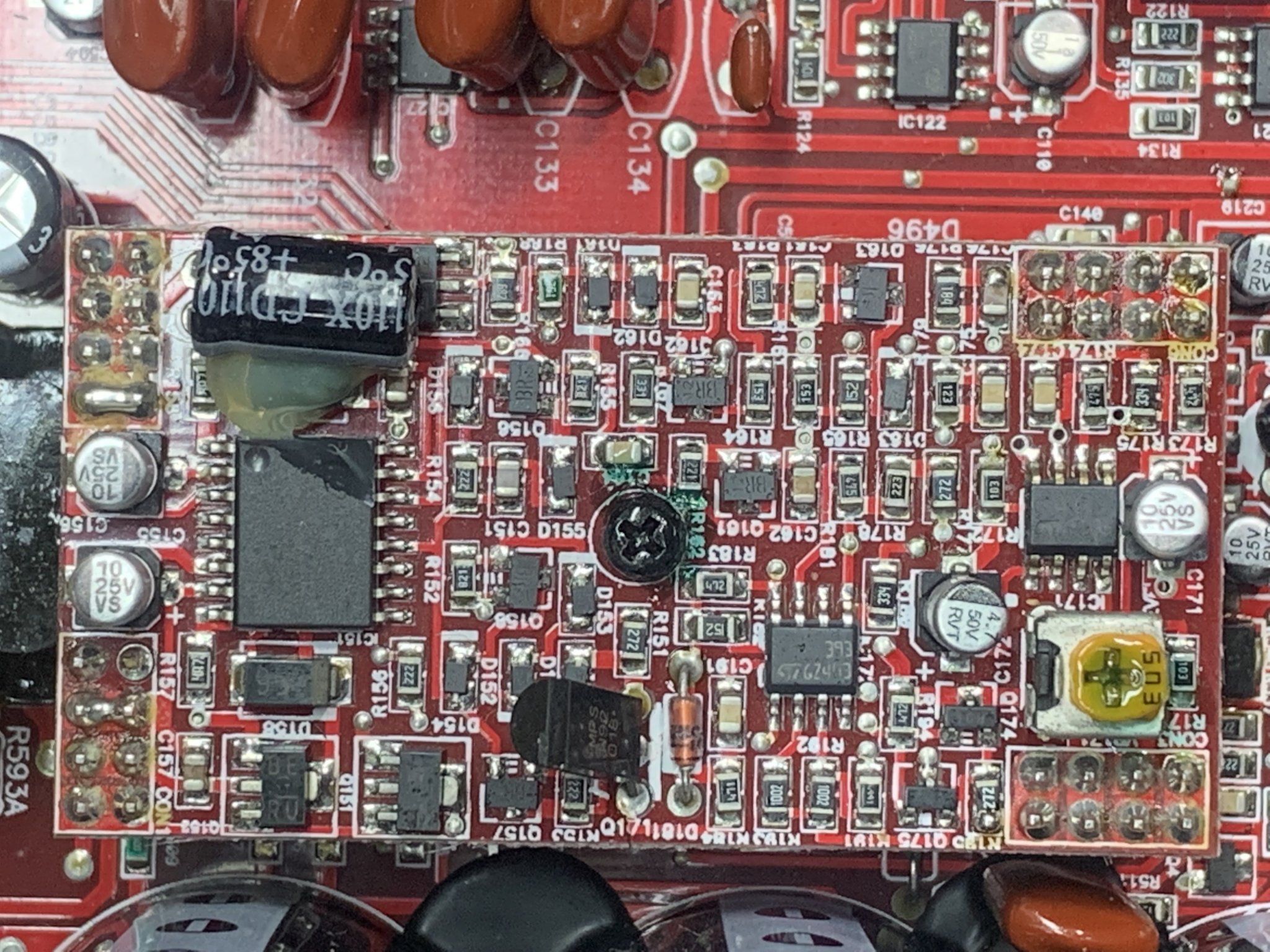

Previous to creating this thread I replaced the driver chip (IR2113) and both caps C155/156 on the driver board. the output FETs (IRFP4868) and gate drive resistors( 5.6-ohm) appear to be original/untouched.
