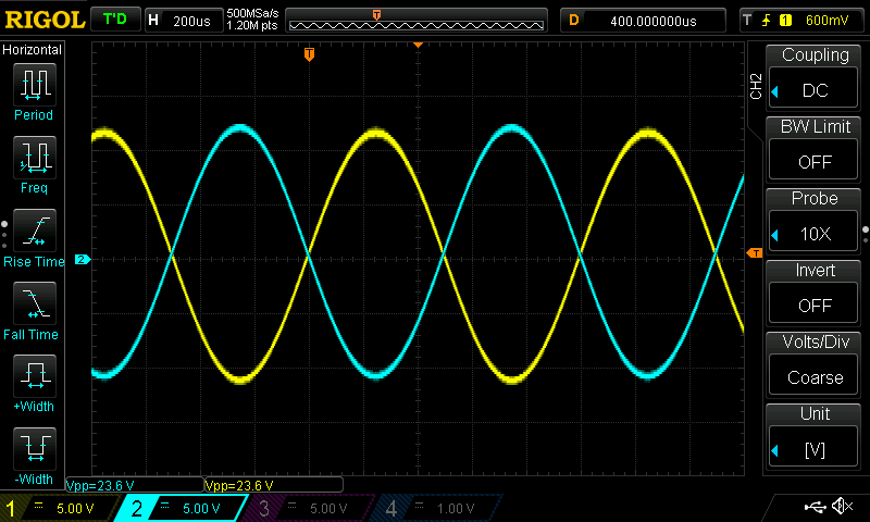

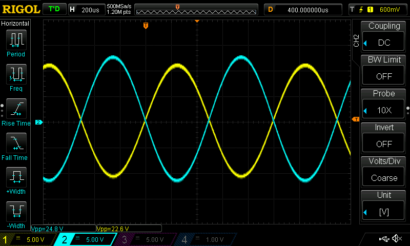

I was buttoning up the second one and getting ready for burn-in when i noticed that the two channels are not perfectly level matched in stereo. I've been through the pre-amp with a fine tooth comb. I hopped it was a dirty pot, but no such luck. I've installed fixed resistors with no change in behavior. I've replaced all the wet caps in the audio path and meter checked every single resistor. Any odd readings and i lifted a leg and rechecked. All are in spec. The input signals are within a few millivolts of each other until the inverting op-amp. At the output of the inverting op-amp the left channel is about 200mV lower than the right. By the time it goes through the poweramp there is a bit more than 2v difference vpp. It's not much, but it's triggered my OCD and I've now dug in for two days straight trying to find the cause.
One of the first things I did was pull the muting JFETS. They tested fine, and the problem was still there with them out of circuit. I have also replaced both the gain op-amp as well as the inverting op-amp.
The clincher on this whole deal-- when the amp is in "mono" mode with the inputs summed the channels are dead nuts equal. Attached are screenshots of the scope. 1kHz function generator, both channels driven separately. The first shows the out of balance channels. The second shows the amp in mono mode.
I think its unlikely to be audible, but at this point I really want to know what is causing it.

Did you use a multimeter and measure both channels from the RCA input to the output to see where the difference came in?
Did you try swapping the inputs since they were not precisely the same?
If there are EQs or Crossovers, are they all set to flat/full range?
I'm not entirely sure I understand the first question. Multimeter from RCA input to poweramp output? If that's what you meant, no I didn't do that.
I did swap inputs, there was no difference, the issue stays with the left channel. I also drove the amp with the balanced inputs instead of the single ended inputs on the din connector. It behaved the same way with balanced signal.
There is no eq or crossover in the amp and I'm driving it from an arbitrary function generator, so nothing hinky with the source.
The signal does not get out of balance by any significant amount until the op-amp that inverts the left channel for bringing. The left signal drivers the inverting input of an op-amp while the right channel drives the non inverting input of the other channel of the op-amp. The left signal goes through a 10k series resistor, while the right goes through a 1k series resistor. I'm thinking this might be where the slight imbalance comes from, but since the op-amp requires very little current to drive, I'm kind of surprised that the series resistor could cause this difference. I may just experiment with the values a bit, but I was hoping someone more familiar with these old Orions would have seen this before...

Start at the RCAs and calculate the difference in dB. Do this at every stage to see where it changes the most from channel to channel.
