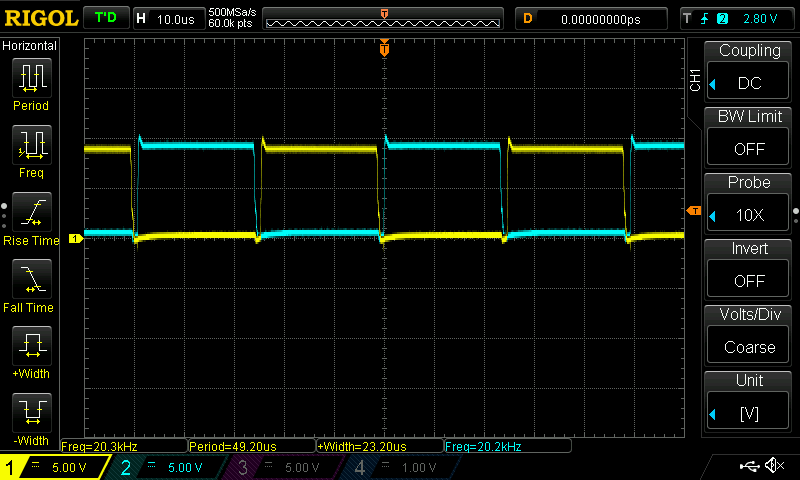

Anyhow, my shop is cold and they don't exhibit these symptoms, even after several hours. I believe the highest idle current I saw 2.2-2.6a. What's odd is that the transformers in both amps get much, much hotter than I would expect. I saw temps as high as 90°C. The only other thing that gets even remotely warm at idle are the driver transitors. I've tried twisting and manipulating the transformer, and current draw doesn't change. I've checked the pwm on the ps transistors and they have a good square wave with adequate dead time. At this point I'm thinking that the rail caps are bad, especially knowing the reputation these amps have for cap failure. I'm open to any other suggestions though.

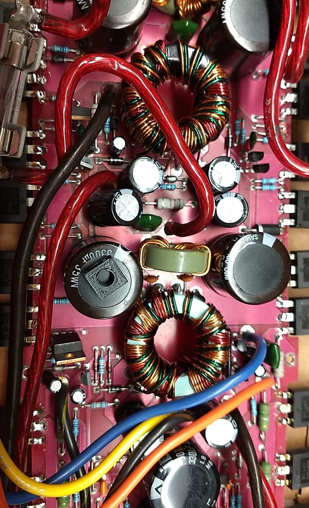

90c at idle is very hot. Since the frequency isn't extreme from what is expected, I'd guess that they used the wrong cores when the transformers were wound. Sometimes when cores overheat badly (there is almost always evidence of it due to discoloration), the core properties can change but since you didn't mention that, I doubt that's what happened here.

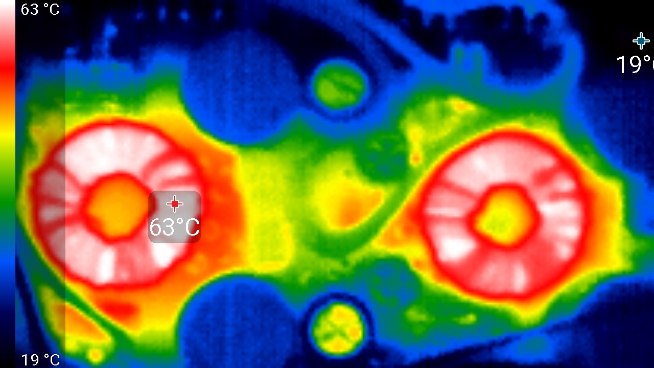

The amp I measured is the cooler of the pair. I'll check the other in a moment. the PS fets do not seem to get hot, but the amp with the hottest transformers was still in the heat sink. After idling for more than 2hrs though, the heat sink a still cool. The a1306/c3298 driver pairs are the next hottest things in the amp, coming in right around 50 degrees C. The two cores are different colors, but it looks to be factory, not due to heat. I'll edit and attach pics in a moment. they do not appear to have been rewound, or even touched for that matter.
The other XTR 200 is the exact same frequency as the other one, 20.3kHz and 20.2kHz. I'm going to let this one idle for a minute, then I'll take a thermal image of it. I can actually smell the enamel on the transformers on this one...

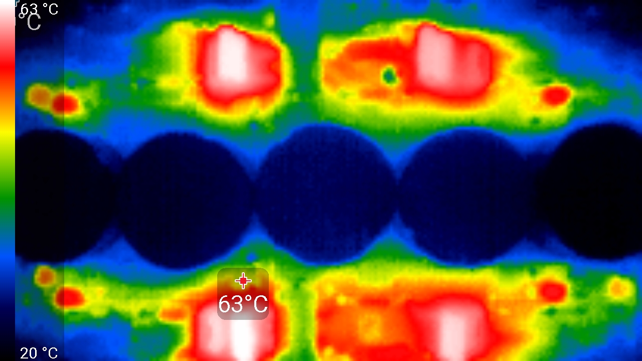

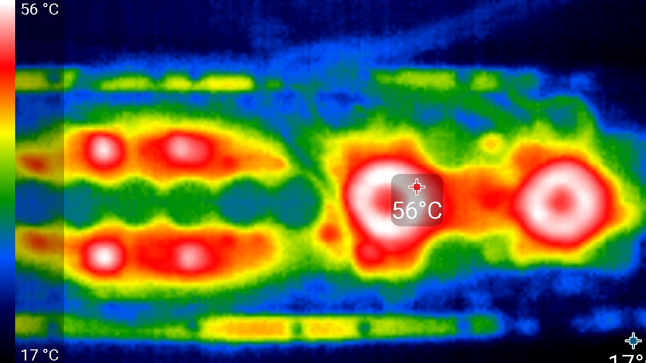

Here are some thermal images of the one in the sink still. It had been idling for about 10 minutes. Shop ambient is probably around 20°. Current draw started at 1.6a and is up to 2.3a. transformers are already up to 65°. Second picture is the overall amp, the last picture is the driver pair.

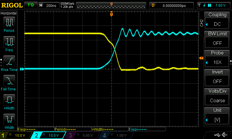

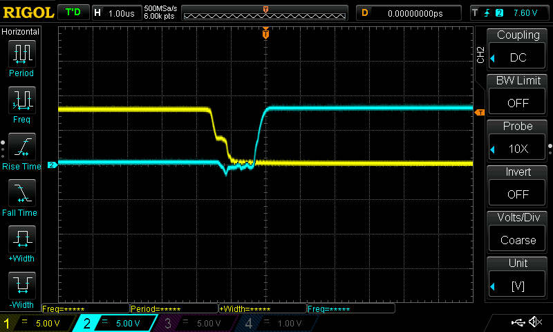

I believe I may have found the issue. Attached are the waveforms first taken at the mosfet gates, then captured at the primary transformer windings. Not only is it ringing like an old church Bell it also appears that the fall time is to long. I'm going to check for defective pulldowns as well as possible a defective snubber network...

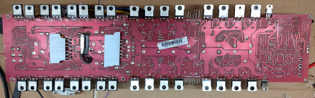

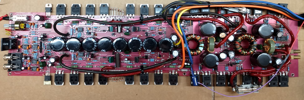

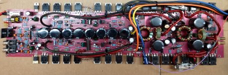

Perry, the resistor in question is directly across the emitter if the driver pair. It is 39R, 1W. I'm attaching some pictures of the board and the driver area. I apologize, I should have done this sooner. The amplifier looks to be virtually identical to the xtr 100 in the Orion folder.
