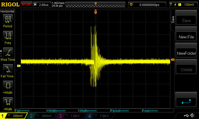

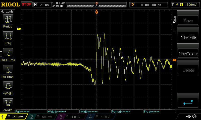

Do you see any sort of oscillation on the output transistors for the channel drawing excessive current?

The reason that I'd remove it if I had this problem is to see if the problem is due to a biasing problem or the high frequency noise. It will also allow you to check the signal feeding the op-amp and the supplies for the op-amp (assuming that the current draw is reduced without the op-amp).
5534 pulled.
pin 6 on the board looks the same as it ever did.
current draw is still there.
It does take longer, maybe 3 or 4 times longer, but coil still whines, and still draws full current (which im still force limiting to 4 amps)

That means that a problem outside of the audio section may be causing your problem and that problem may be causing additional problems when the audio circuit is active.

Some amps require that you keep eliminating various parts until you find the actual fault or faults. If the current is no longer flowing through the output transistors, the fault would seem to be in the power supply.
does the whining toroid give any clues as to what to look at next ?
guess i should look at the 494 wave forms.
