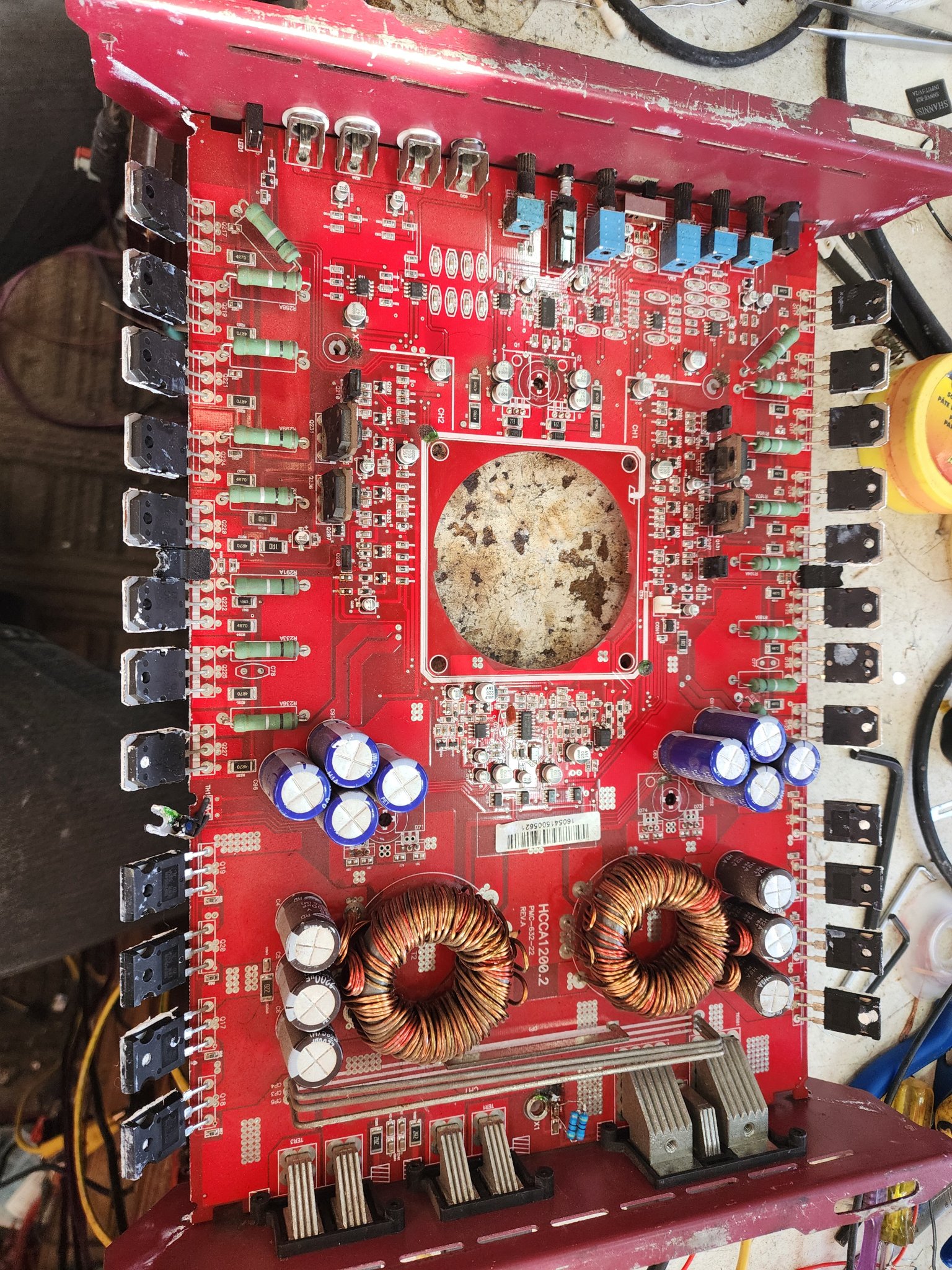

Orion HCCA1200.2
Hi
Attached are the output signals of two channels. One channel side, bottom wave clips and other channel top wave clips. Amp goes into protection. I removed the protection to get the waveforms.
All the rail voltages positive and negative are similar in value and low voltages are also good.

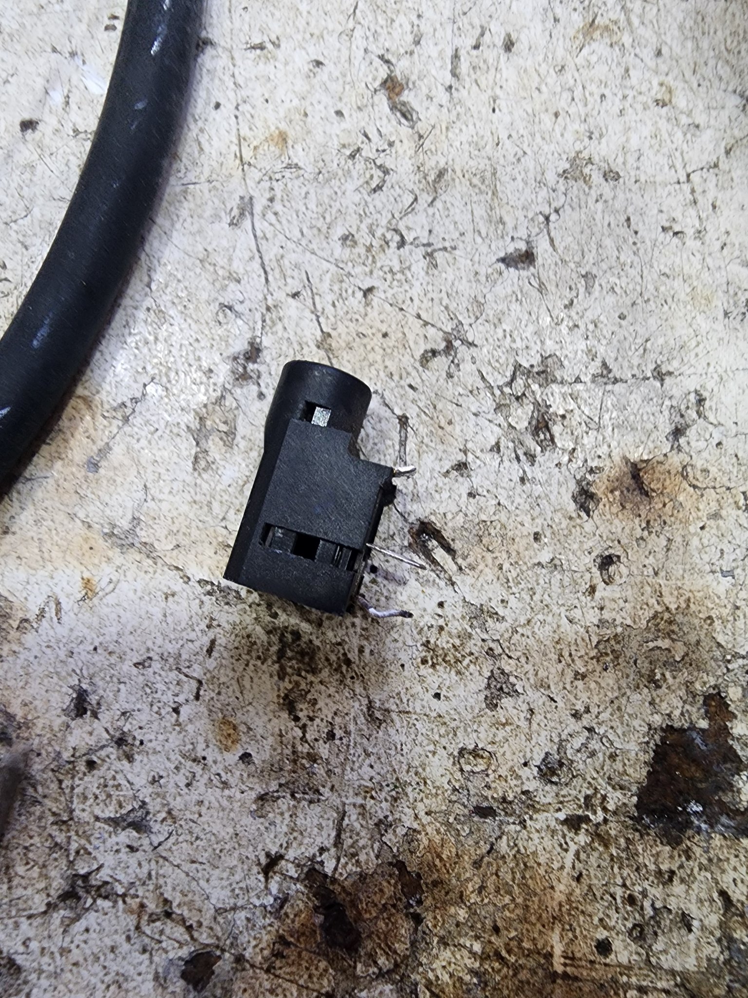

Pins 1 and 16 voltages os not constant. I traced them and reached to this attached picture which is remote controller switch. Once I removed it amp is functioning normal. All the 3 pins of this jack are showing shorted.
