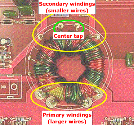

Can you post the voltages again on the outputs. This time, place the black meter lead on the secondary center tap of the transformer for the channel you're measuring.

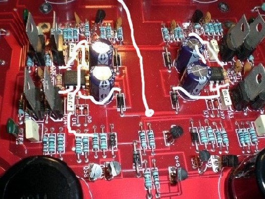

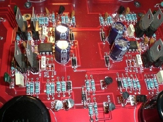

Ok I don't know if this answers your question but this board if you draw a line down the middle it would almost be a mirror image from left to right side, Their is a burr brown on both left and right channels or sides and they are a OPA134PA single amp chip.
Now as far as tracing the #7 pin, It goes through a diode and from the diode it goes to a 2N6488 NPN 3rd leg that has been soldered to the underside of the board to be against the heat sink also trace divides and goes to 2 MPSA06's 3rd leg's. I hope this helped. heres some pic's
Perry Babin said:Does pin 6 go to to the center of the 4 diodes in series?
If you are talking the same one's pin 7 goes to, no.
Pin 6 goes to a 2.7ohm resistor right next to it, Then goes to tiny glass diode which is in series to the one next to it then hits a trace that branches off 3 differn't ways. all stay in that little area. 1 goes across to the small white box capacitor and another goes to blue resistors and another to the mpsa06.
Anyway I traced a picture for you. Hope it helps.

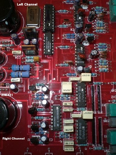

It took me awhile but here it is. In the top two OP's I left the 0 voltage pins out. Also I took a picture and numbered everything.
I wanted to tell you also the 2 Big blue resistors in the picture started to smoke after a couple of minutes being on testing and those century's got so hot you could smell them. Let me know what you think.

Email me the best photos you can get of the top and bottom of the board. Take two that cover the area of the 14 pin op-amps, two that cover the area of the regs (6488/91 under the board) and two that cover the area around the 134a (one each area from top and bottom). Send them at the highest resoultion. Please zip them.
babin_perry@yahoo.com
The voltage on the 14p op-amps looks OK. There must be a DC blocking cap in the board somewhere.
I posted a link for #6. It's not likely to be causing the problems here. #7 is a microcontroller. It doesn't do much. When the amp powers up, the IC sends a signal to the digital pot telling it to go to 'full volume'. After that, it doesn't do anything unless you use the remote level controller.
