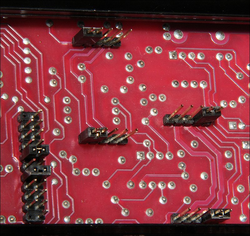

I removed the transistor that I suspected to be the bad one and tested. Results are 0.000v on all resistors. I tested with the resistors all tied back to the board. So am I to assume that this is the culprit, or is there more to test?
Here is the crossover and bypass.
Ok, I have it hooked up to my full range speakers but all I am getting is lows coming out of amp. This makes since, since I believe I had it set for a sub. But I just looked for my book and cannot find it. I was going to try and set it for full range. But there is sound out of both sides, I just don't know if its clear until I can set the crossover to full range.
