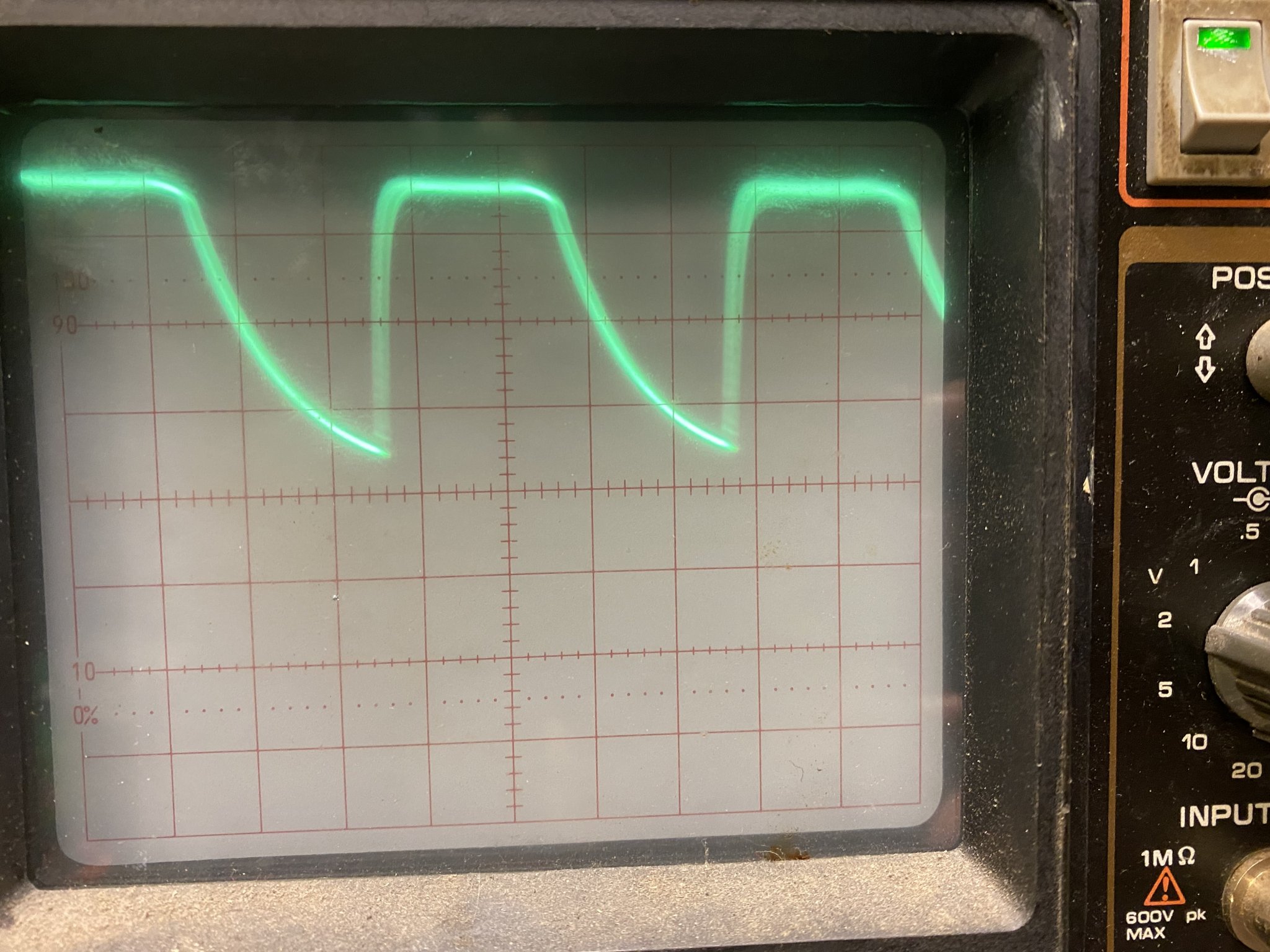

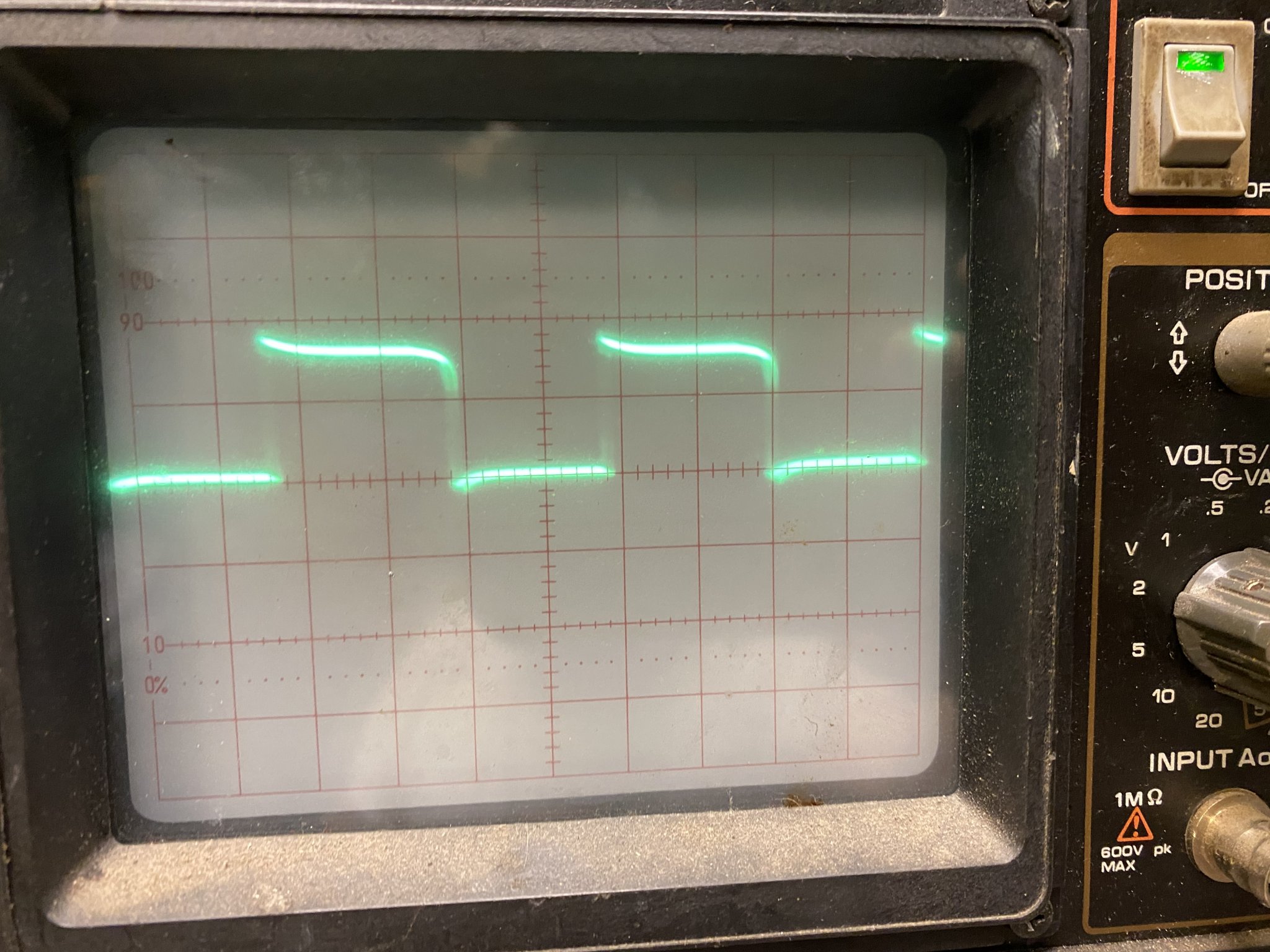

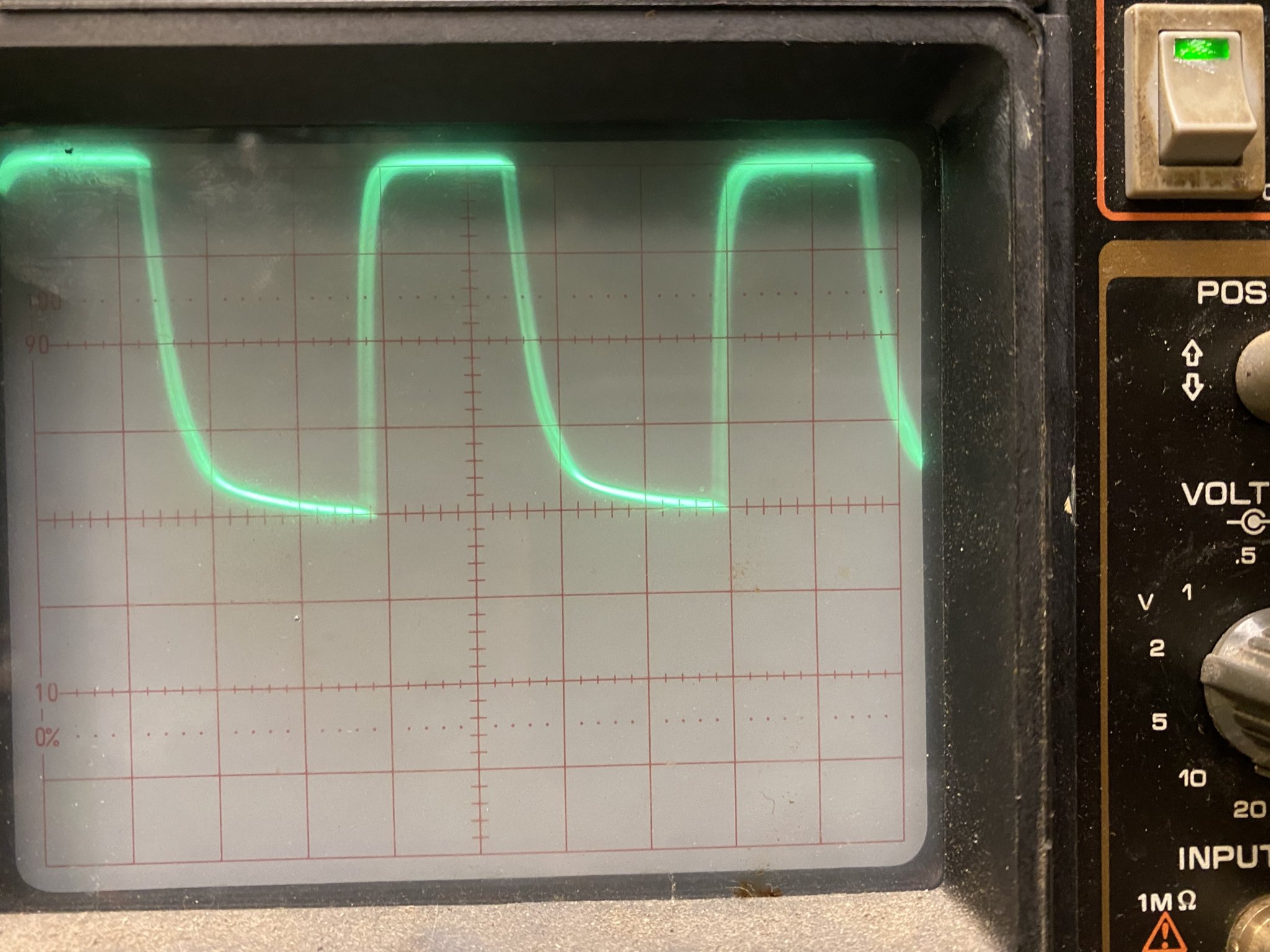

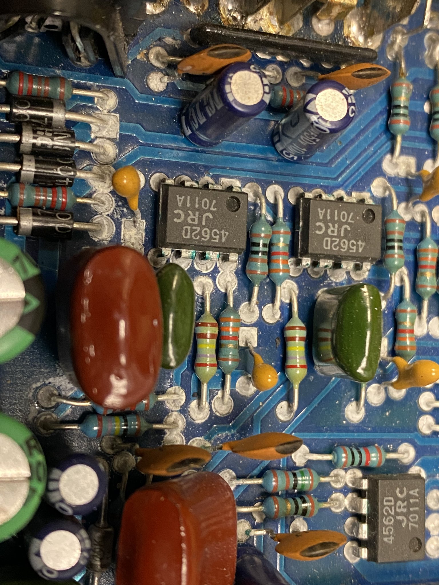

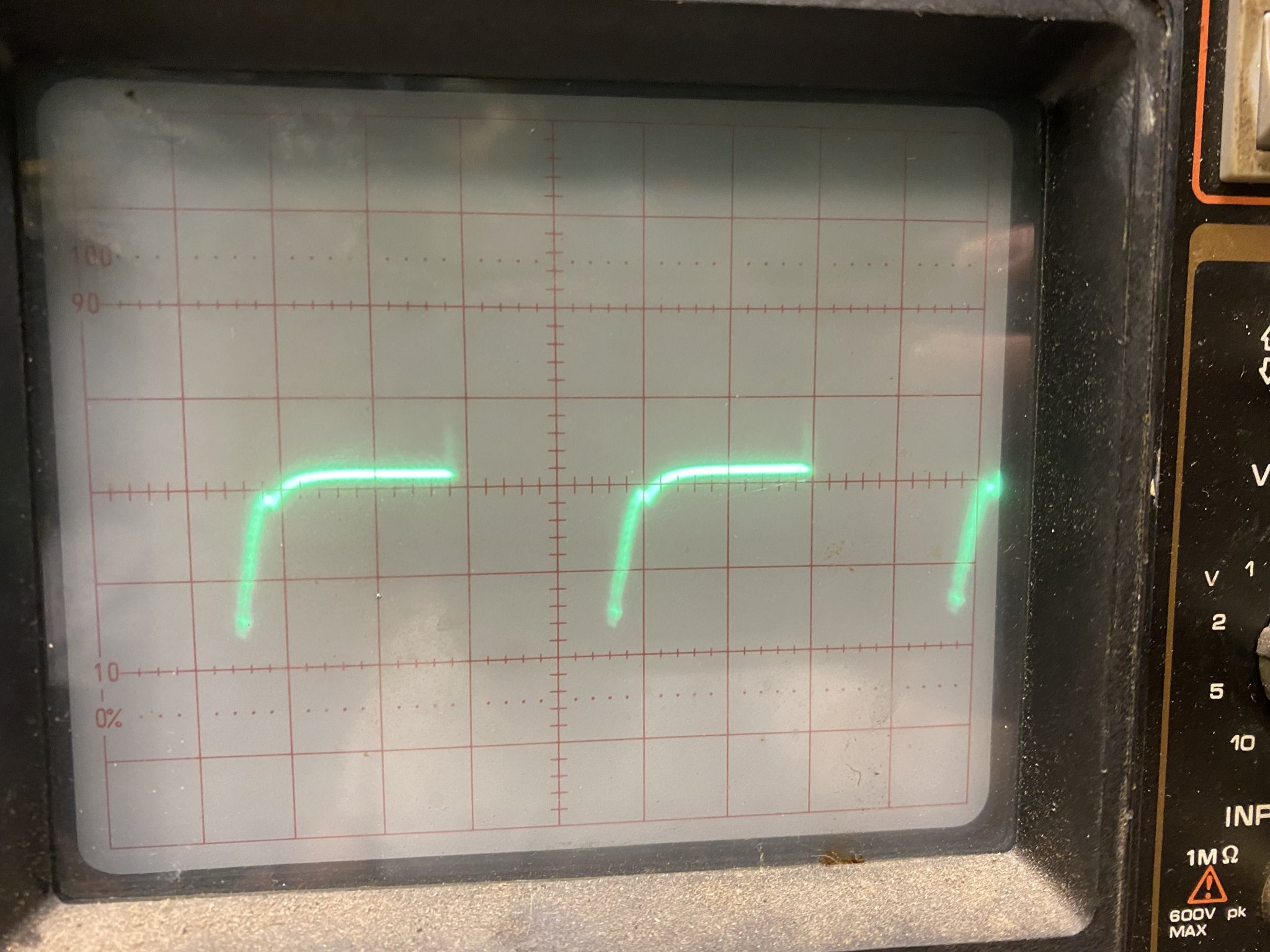

I replaced the power supply fets , gate resistors,drivers and all the outputs were new in the amp . Have it back to the guy and a week later it’s back he said he had it running at 2 ohms stereo and it blew the fuses again .
Any ideas as to why the fuses blew ? I do t see anything wrong with the amp everything is checking fine
