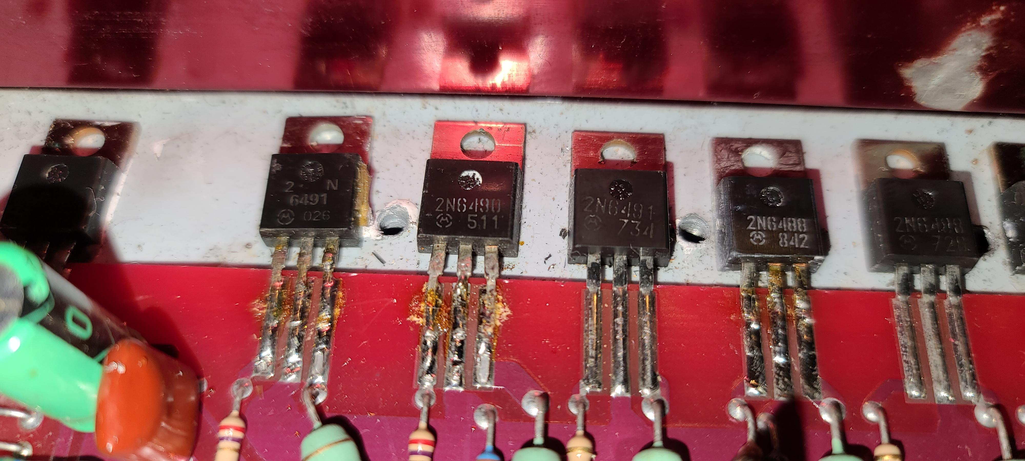

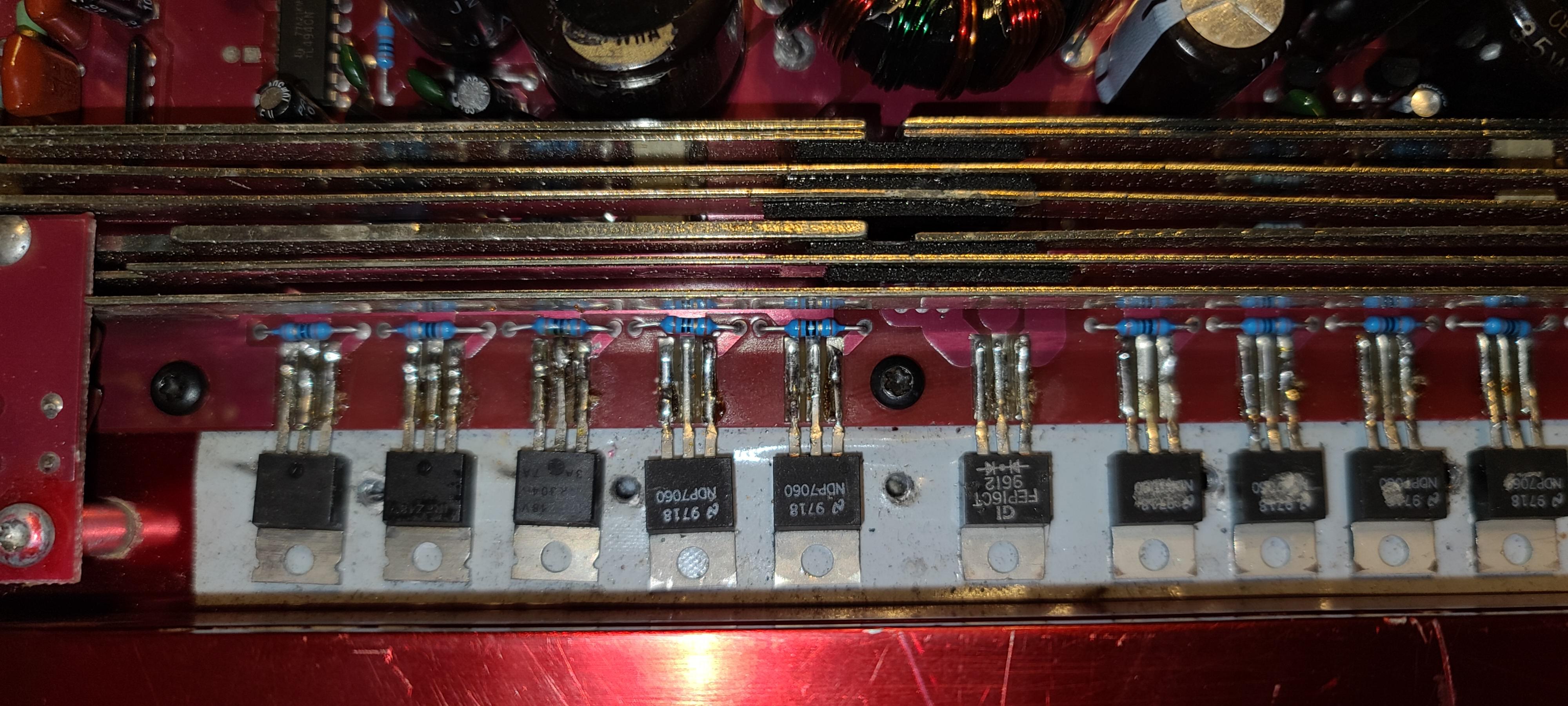

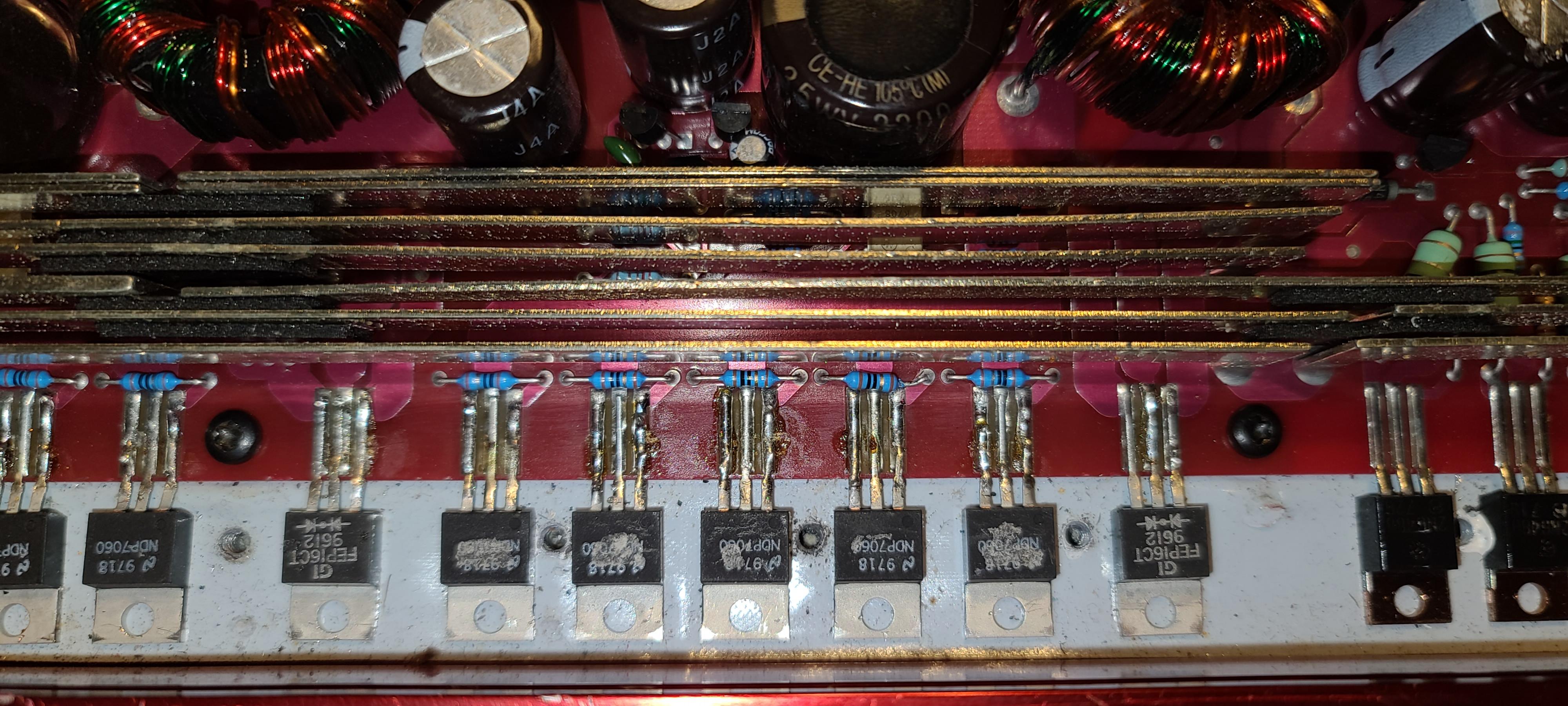

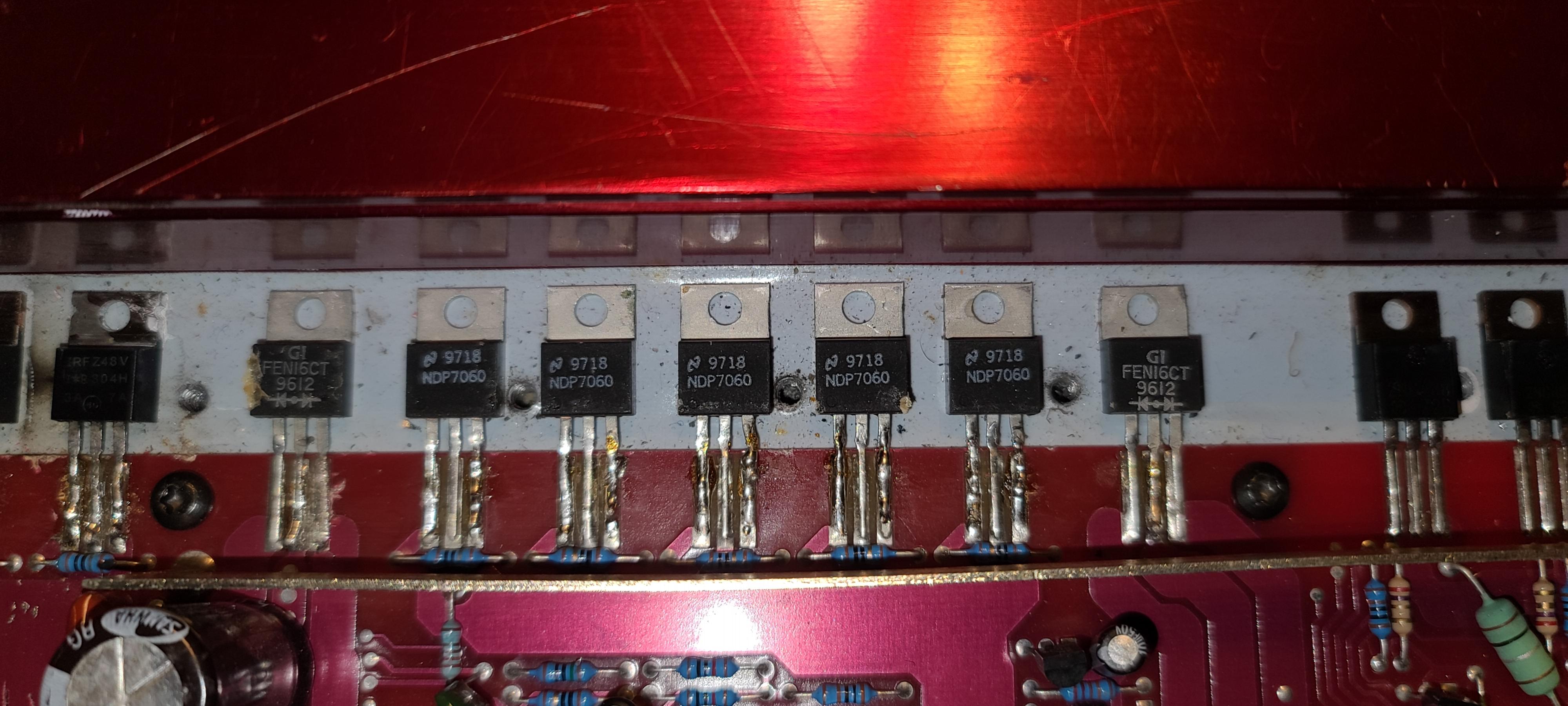

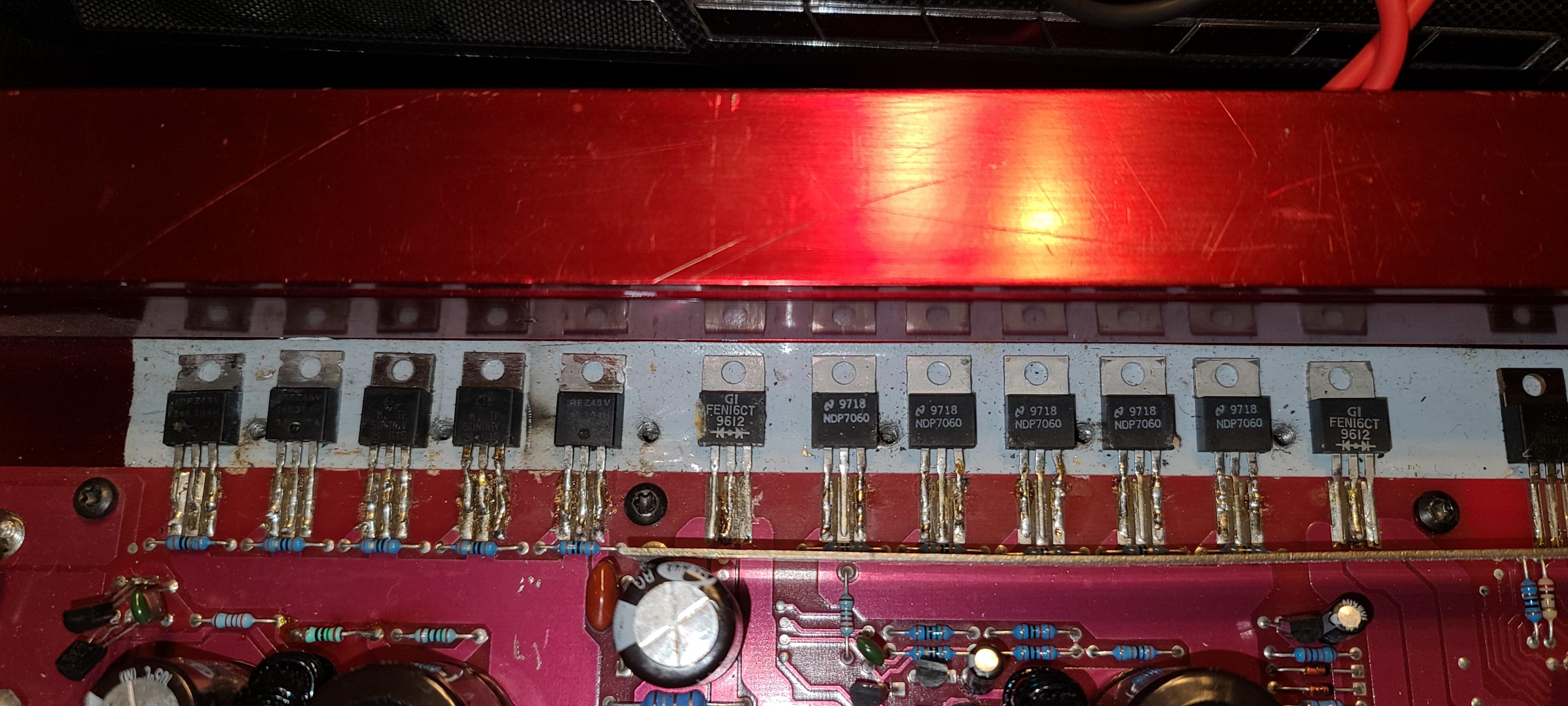

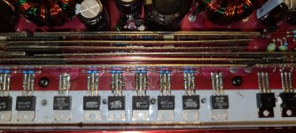

Top right of the datasheet explains the suffix. Look just right of the giant picture of the part and you'll see the pin configurations and suffix.
CT = Center Tap.
The replacements you order need to have both Kathodes on pin 2 for the FEP and both Anodes on pin 2 for the FEN.
MUR1620CTRG = FEN16CT
MUR1620CTG = FEP16CT
The old marking gave the polarity in the prefix FEP = positive, FEN - negative). The newer markings have the prefix of all, the same (FEP), regardless of polarity. The pin configuration is determined by the suffix (xT, xTA, xTD, positive, negative and doubler, respectively).

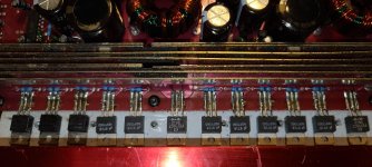

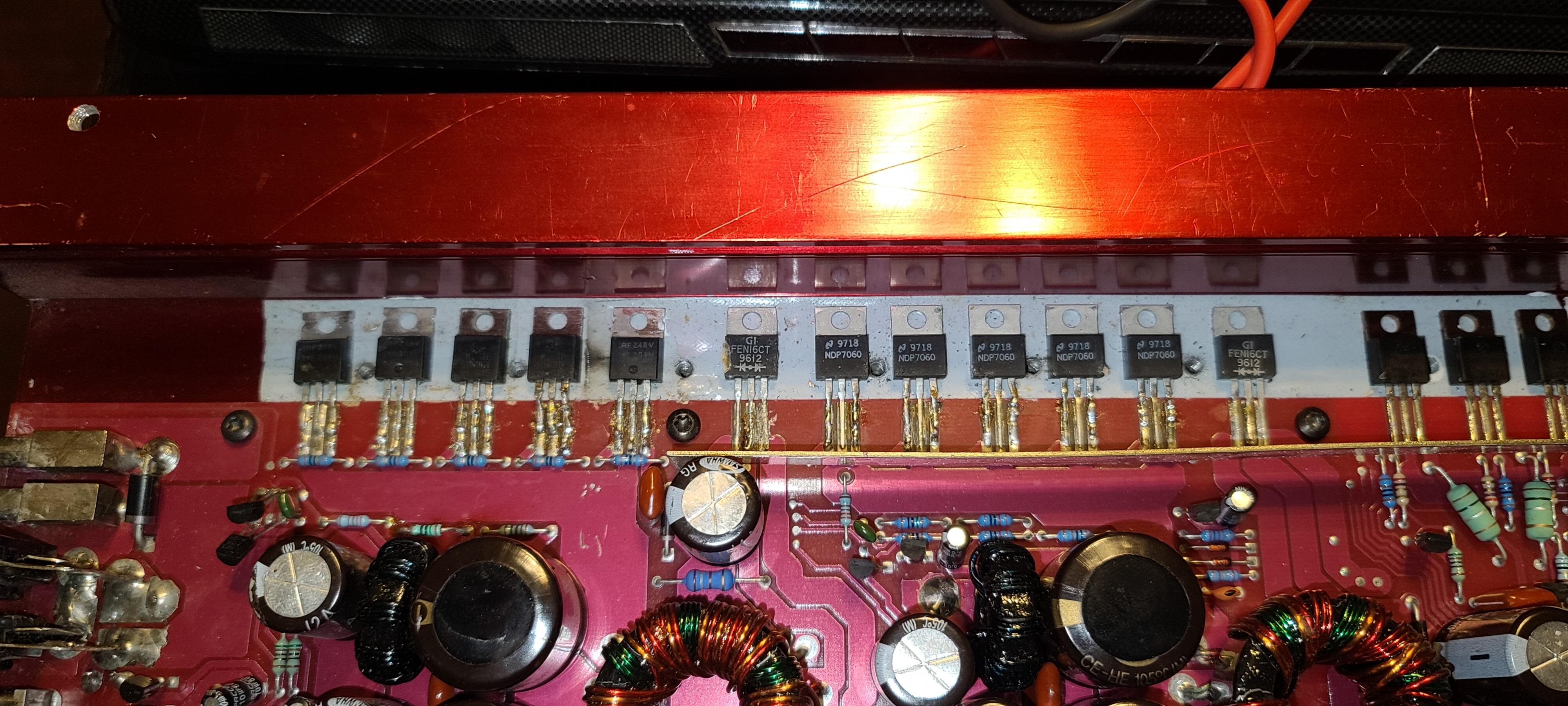

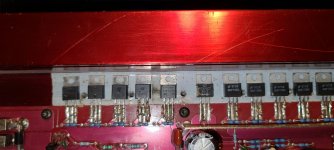

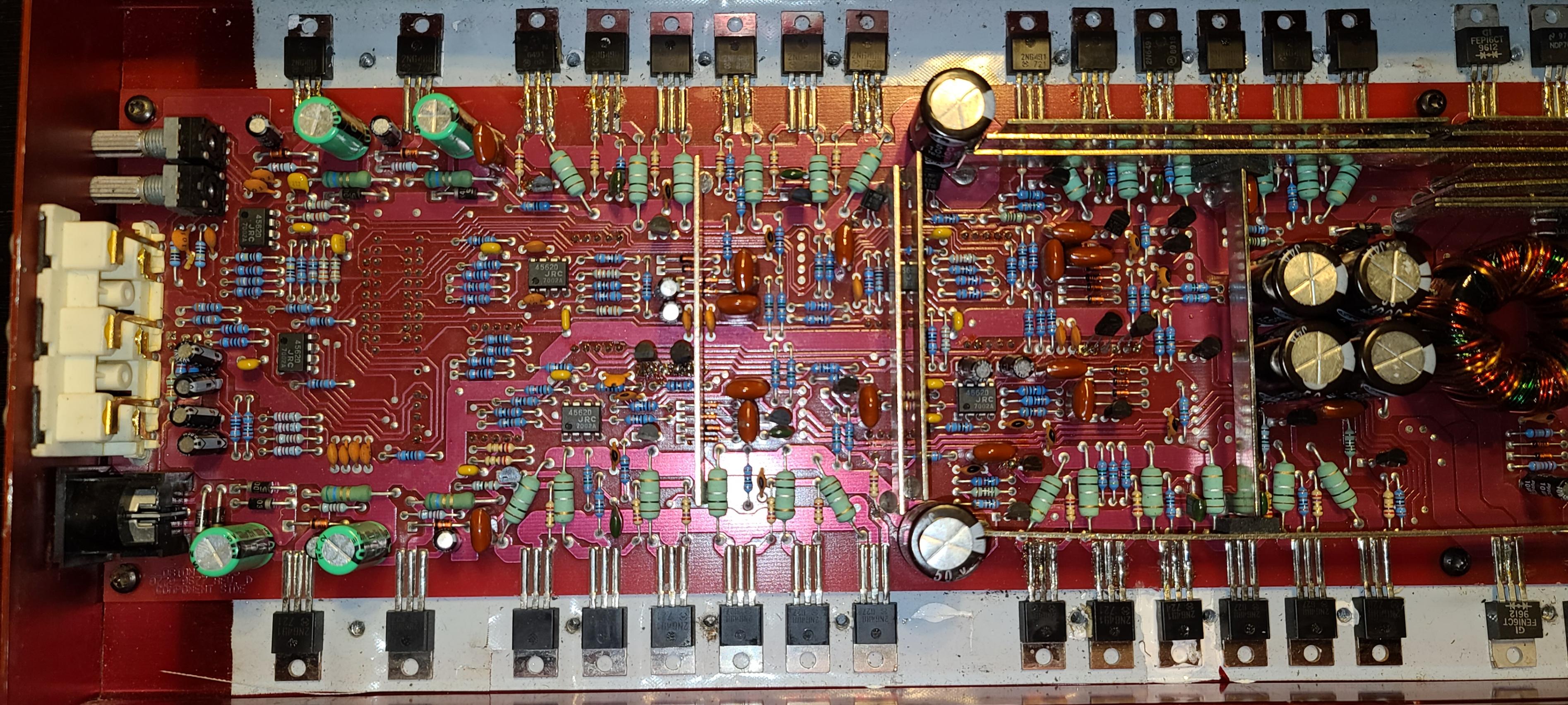

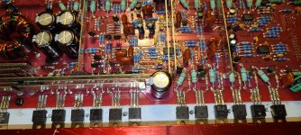

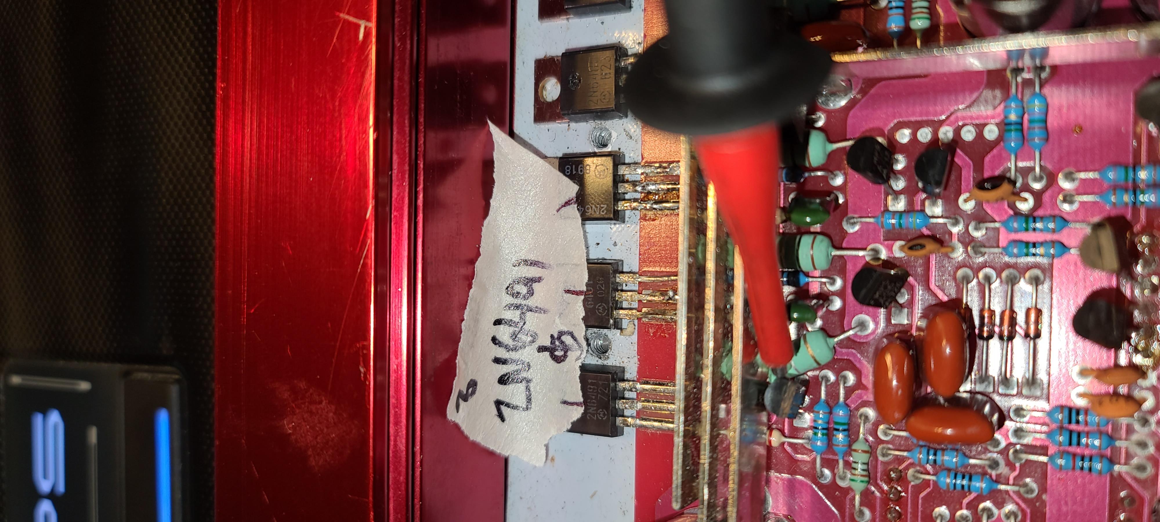

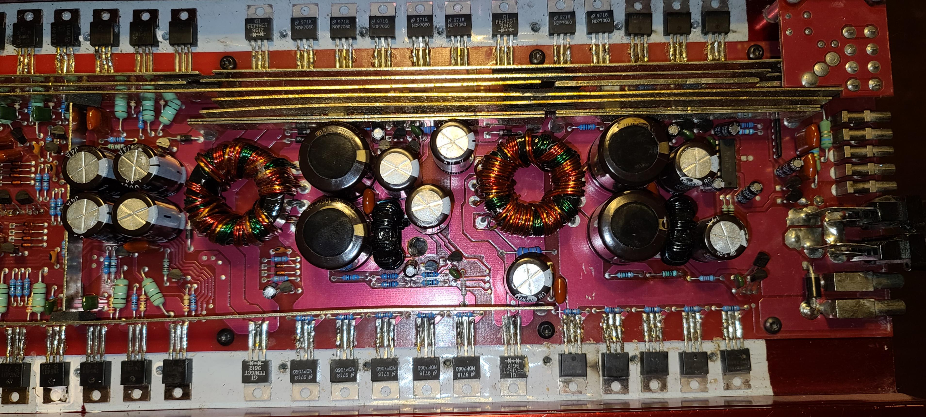

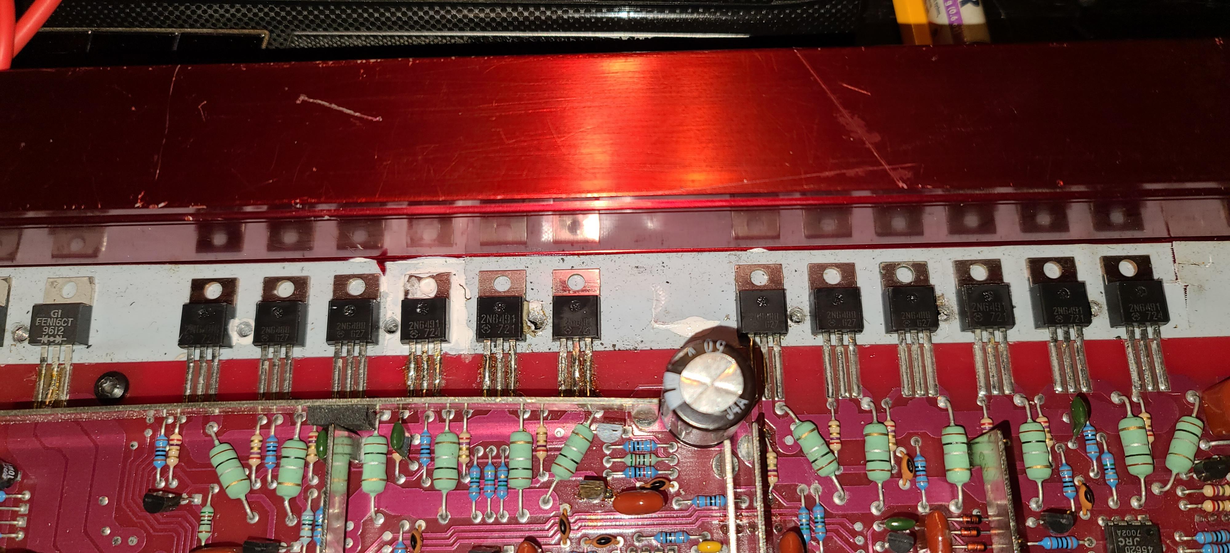

Ok ... This thing is up and running like a champ, all of the sides were changed out ( PS FETs , Diodes/Rectifier's and output transistors) THANKS PERRY for all the great help 👍
