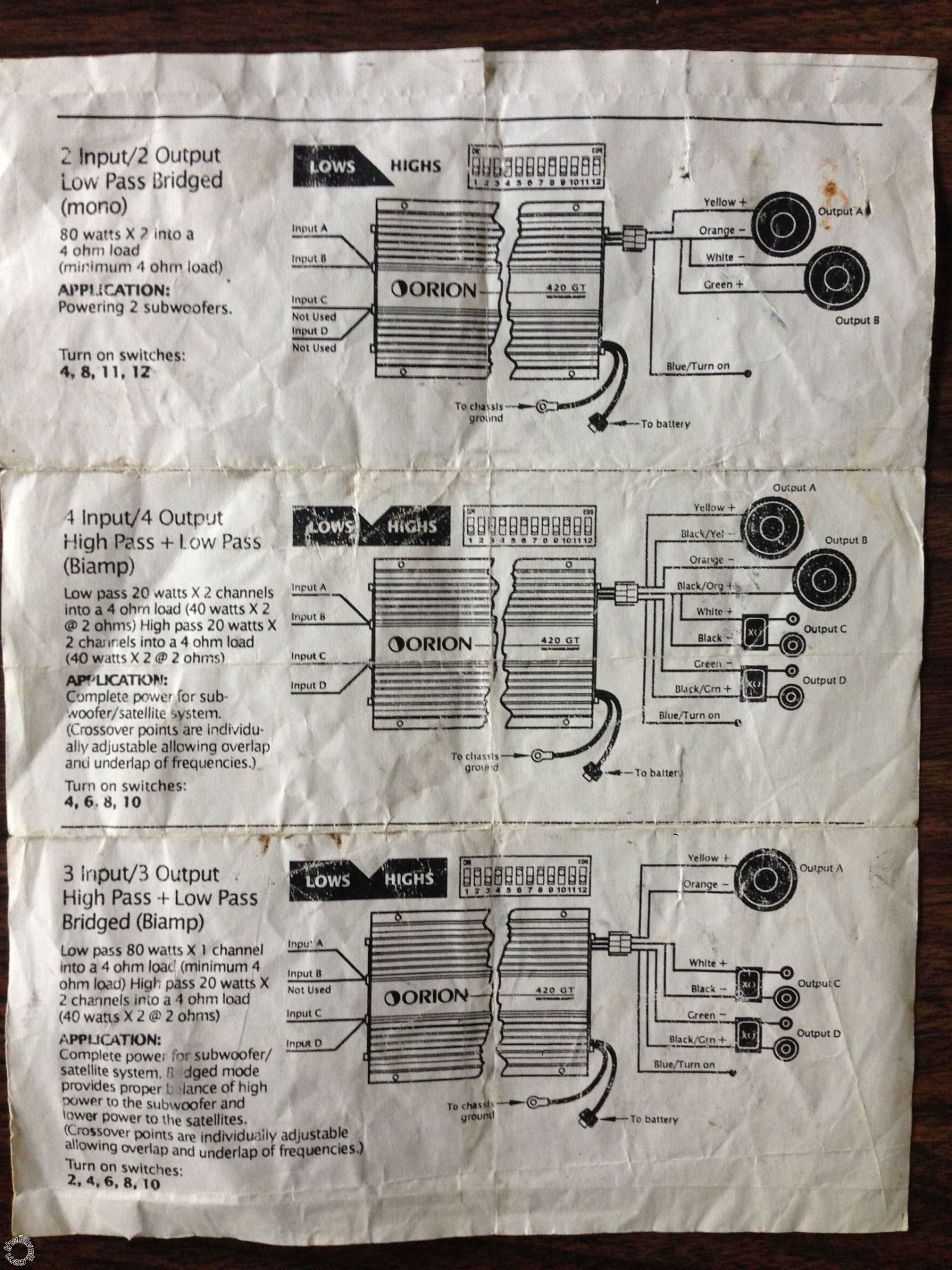

Orion GT420 missing rectifiers and a transistor in the power supply section. I could not find service manual.
Any help would be vastly appreciated.
