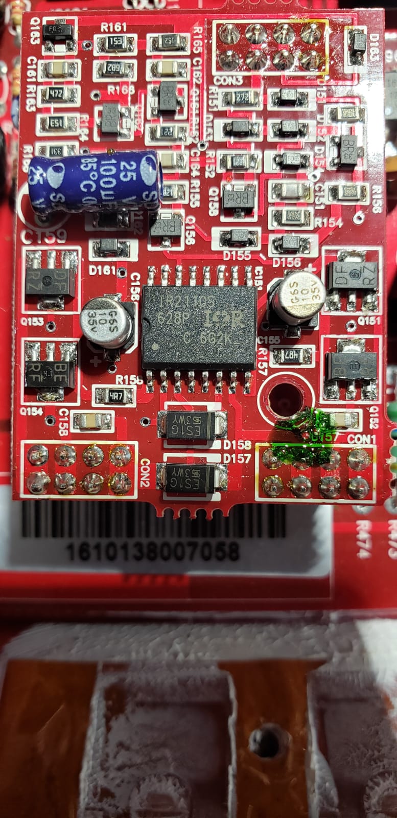

J jorge s Member Joined 2020 2022-09-13 6:10 pm #1 2022-09-13 6:10 pm #1 could anyone give me some assistance on identifying these two transistors marking be/ rf and df/rz on the driver board ? thanks ! Attachments IMG-20220913-WA0000.jpg 228.9 KB · Views: 92 P Perry Babin Member Joined 2003 bcae1.com 2022-09-13 6:36 pm #2 2022-09-13 6:36 pm #2 Transistor marked DF - 2sd1898 Transistor marked BE - 2sb1260 J jorge s Member Joined 2020 2022-09-13 7:18 pm #3 2022-09-13 7:18 pm #3 Perry Babin said: Transistor marked DF - 2sd1898 Transistor marked BE - 2sb1260 Click to expand... thank you mr .Babin ! You must log in or register to reply here. Share: Facebook X (Twitter) LinkedIn Reddit Pinterest Tumblr WhatsApp Email Link
