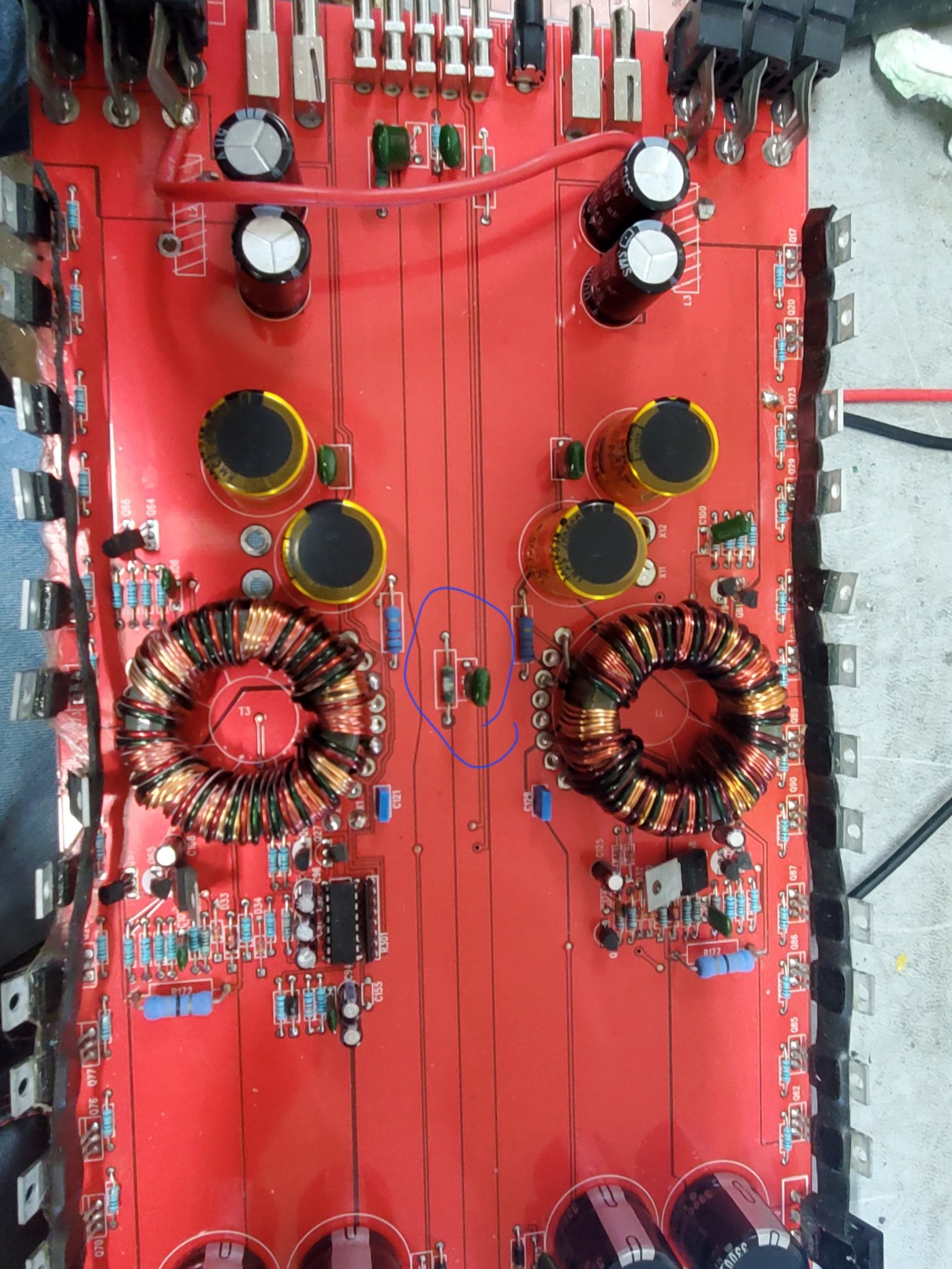

Never seen a PIC16 damaged this bad. I suppose this is going to be non repairable unless someone has the firmware laying around? Another DIP16 blown to shreds. Not sure what it is.
Not familiar with the old school stuff but I do know how to program and have the tools to do it.

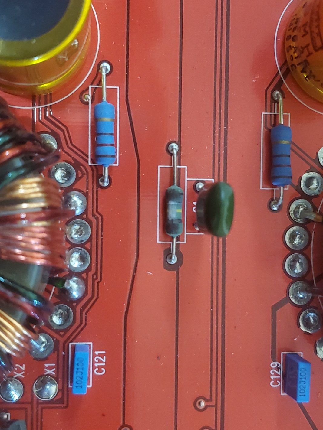

@Perry Babin do you know the value of the resistor in the attached photo?

180 ohms on an extreme 1200. The board number is 0770-5110. The boards look similar.
