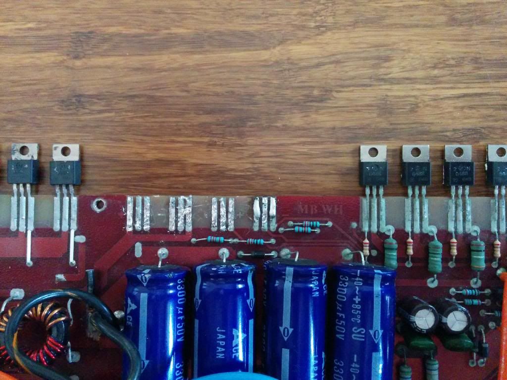

1) Its missing the four TO-220 parts that are between the power supply and output fets. There is no silkscreen but there is + and - markings. I think these are supposed to be voltage regulators but I don't know what the part numbers are since they are missing.
2) Its missing some parts on the opposite side of the board that were removed. I'm guessing diodes. I need part numbers for those as well. I wish there was a silk screen with part designations. Its the two diodes that reside next to the remote turn on wire.

The 4 missing components on the top of the board are likely two rectifiers and to the right of those, two voltage regulators (LM317 and LM337?).
I don't know what the other components are.

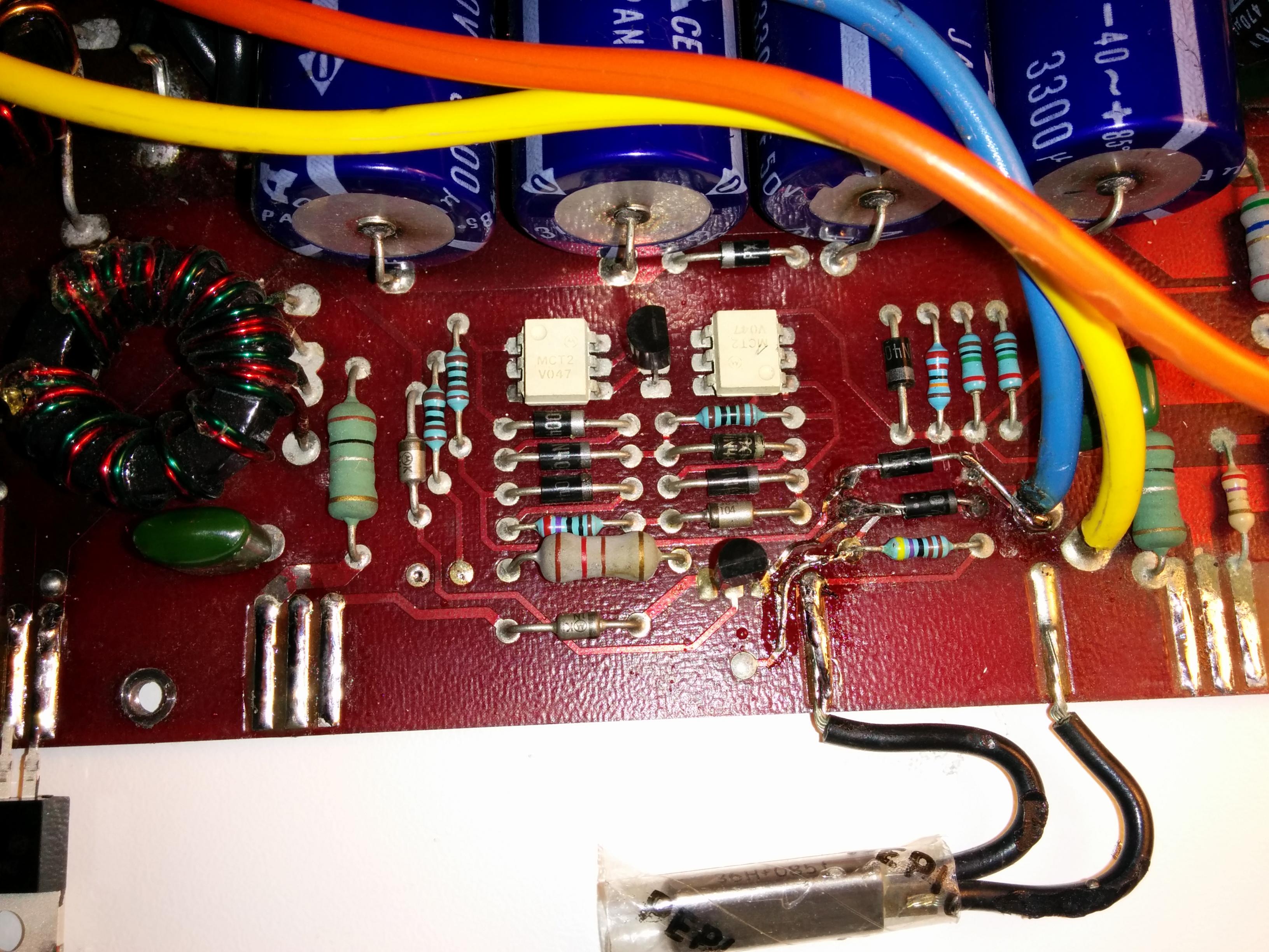

Looking at the second pic, it looks like the first two spots are for the rectifiers (MUR1620CT/CTR) and the second two spots are for the voltage regulators (7815/7915). Again this is just what I believe goes in those spots, am pretty sure someone with one will confirm the components.

The reason that I assumed that they are the 317/337 is because there are adjacent resistors. If they are 7815/7915s, the center leg of the positive reg will be directly connected to the first leg of the negative reg.

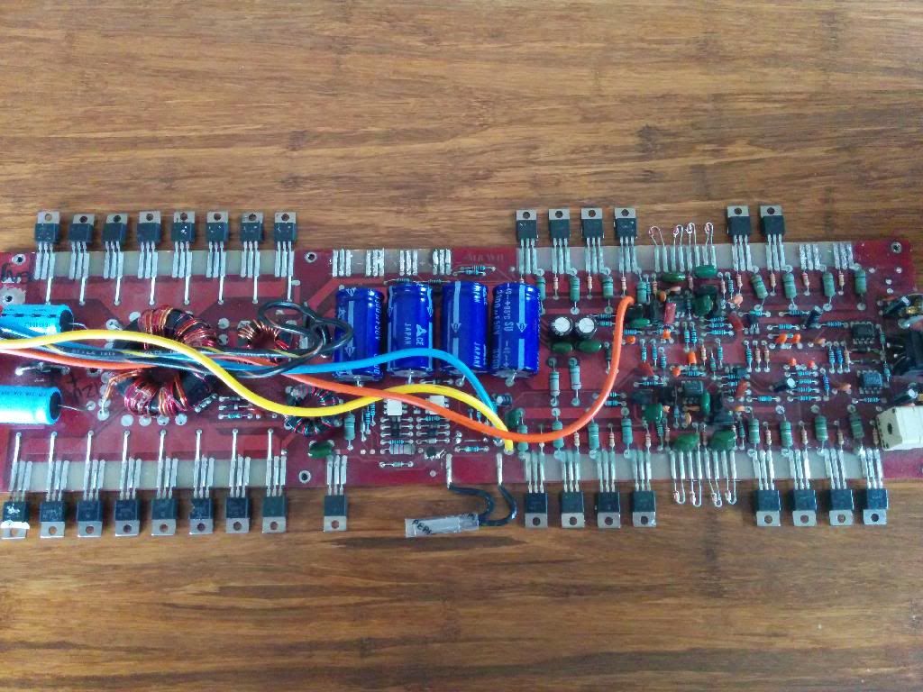

OK so I made some progress.
1) Replaced all 16 of the 2N6488 in the power supply section
2) Populated the 4 missing locations (left to right) with U1620G, U1620RG, LM317, LM337
3) Replaced all 4 of the PNP 2N6491 on one of the channels
4) Populated the two missing diodes with 1N4007. Polarity is per image found online.
5) Replaced visibly dead reverse power protection diode with a 1N4007 (probably need something bigger for this application)

no component designations to help but a bunch read >0.000. I got everything from 0.000 on some all the way up to .12V on others. A few of the 2N6491s also show voltage on their emitter resistors. I have the parts on hand, maybe I should just replace all of the transistors that I haven't yet replaced?
The ones with more than 0.000v are the ones passing current and causing the high current draw. I'll need a photo showing the voltage on the ones higher than 0.000 to be more precise.
OK so I removed all the output transistors and was able to get the thing to power on using a limiting resistor. Still draws 6 amps. Noticed that one of the power supply transistors (a 2n6488 seperate from the rest of the PS) was getting hot. I removed it and voilla I get a stable power supply drawing only .04 amps when idle. This is with the outputs still removed. So I replaced that transistor and again it shorting out. So something connected to this transistor is drawing current. But what?
Here is the picture of the circuitry in question. Do I need to remove the large resistors to test for a short?

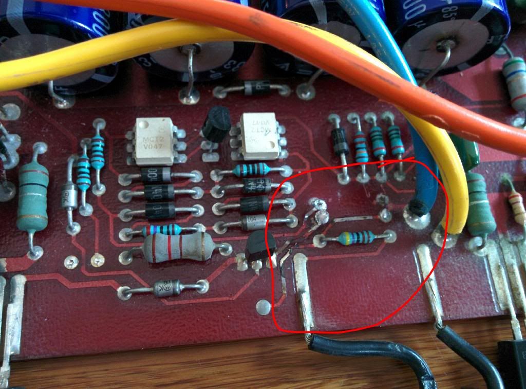

Note that I had to work with lifted PCB traces shown in this pic. I'm not sure if this is due to the original damage or if this was due to the previously attempted repair.

I'm suspecting the MPSA06 between those white op amp looking things and the other shown at the bottom of the circuit board next connected to the zener can.

Nope, 3904s didn't fix the problem. I replaced the MPSA06s with 2N3904 and replaced this questionable transistor and it draws 6 amps at idle again.
