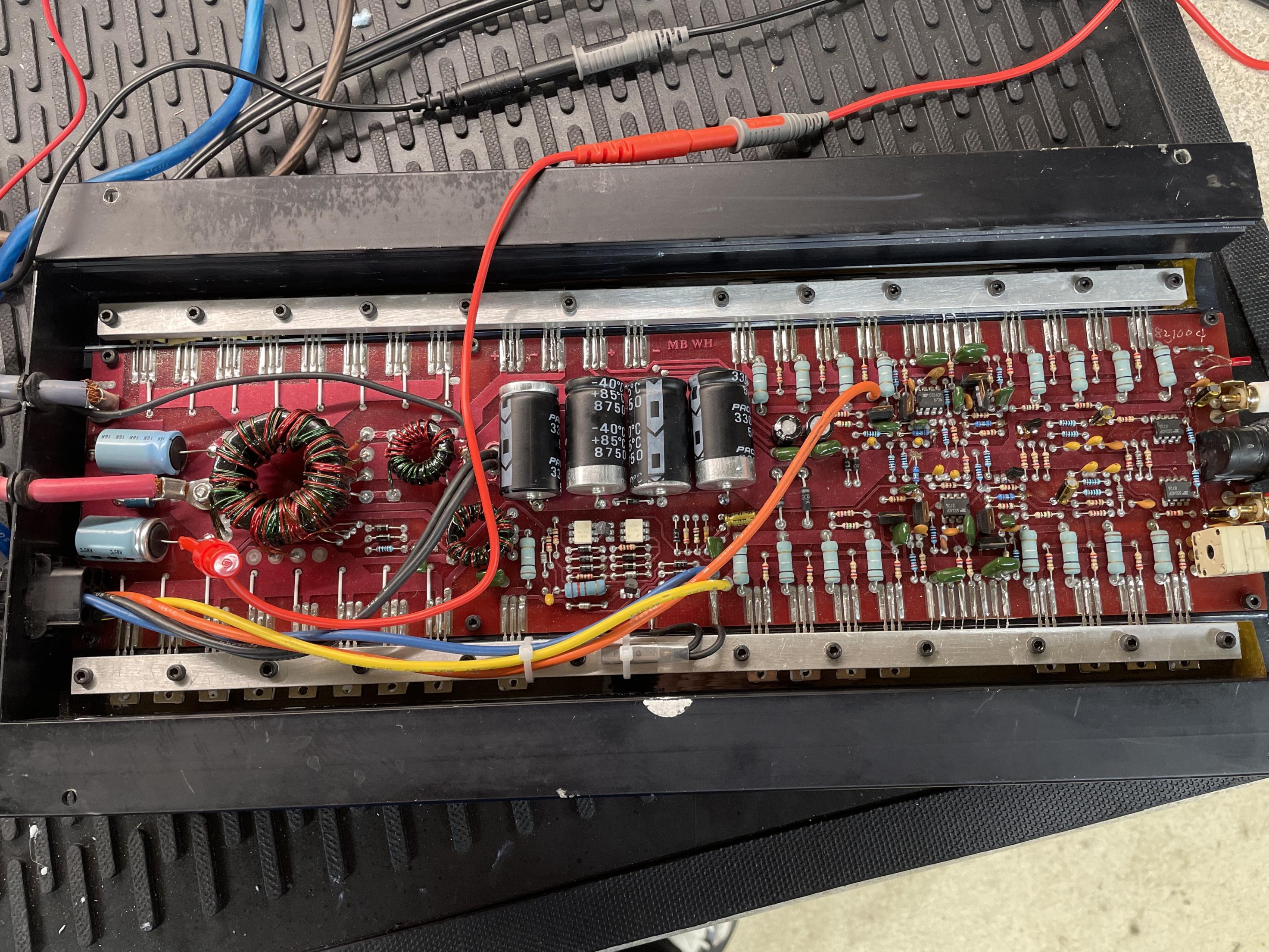

Another weird thing is, someone ran a wire to the outside of the amp, which is secondary center tap. Do I need to have that hooked up to the negative terminal during operation? Don't want to fry this old beast or anything. Photo coming.
Photos

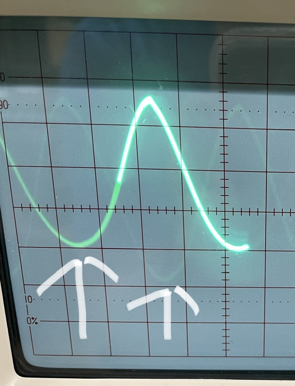

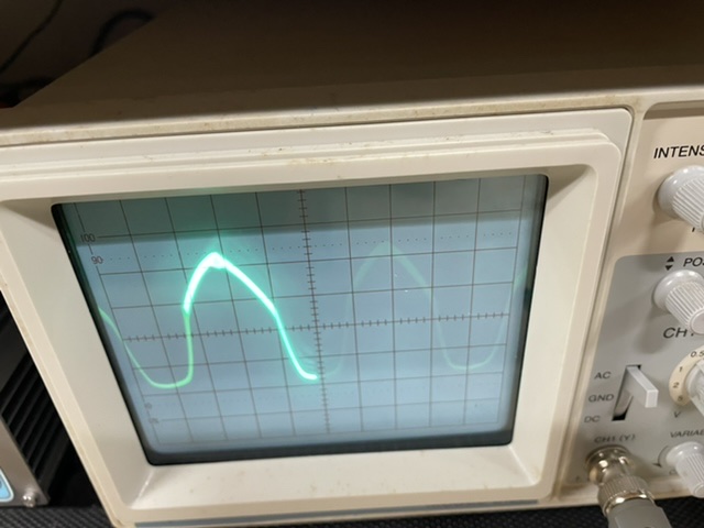

I think I did find another fault which may be causing this. The right channel (Yellow wire side) has a problem with reproducing the lower part of a sine wave. Its slightly deformed where where the Left channel looks perfect. Perhaps if I clear that up the amp will run with stable rails.
Tracing from rcas through to the opamps, the opamps nearest the rcas are looking clean on in/ouput pins, but the opamps nearest the driver transistors look like this with a pure sign wave input. Not good at all. Both channel opamps are showing this, and to be honest I'm not 100% convinced the left channel is perfect when loaded down either.
If I set my function generator to triangular wave it looks even worse than this photo. Even more crooked.

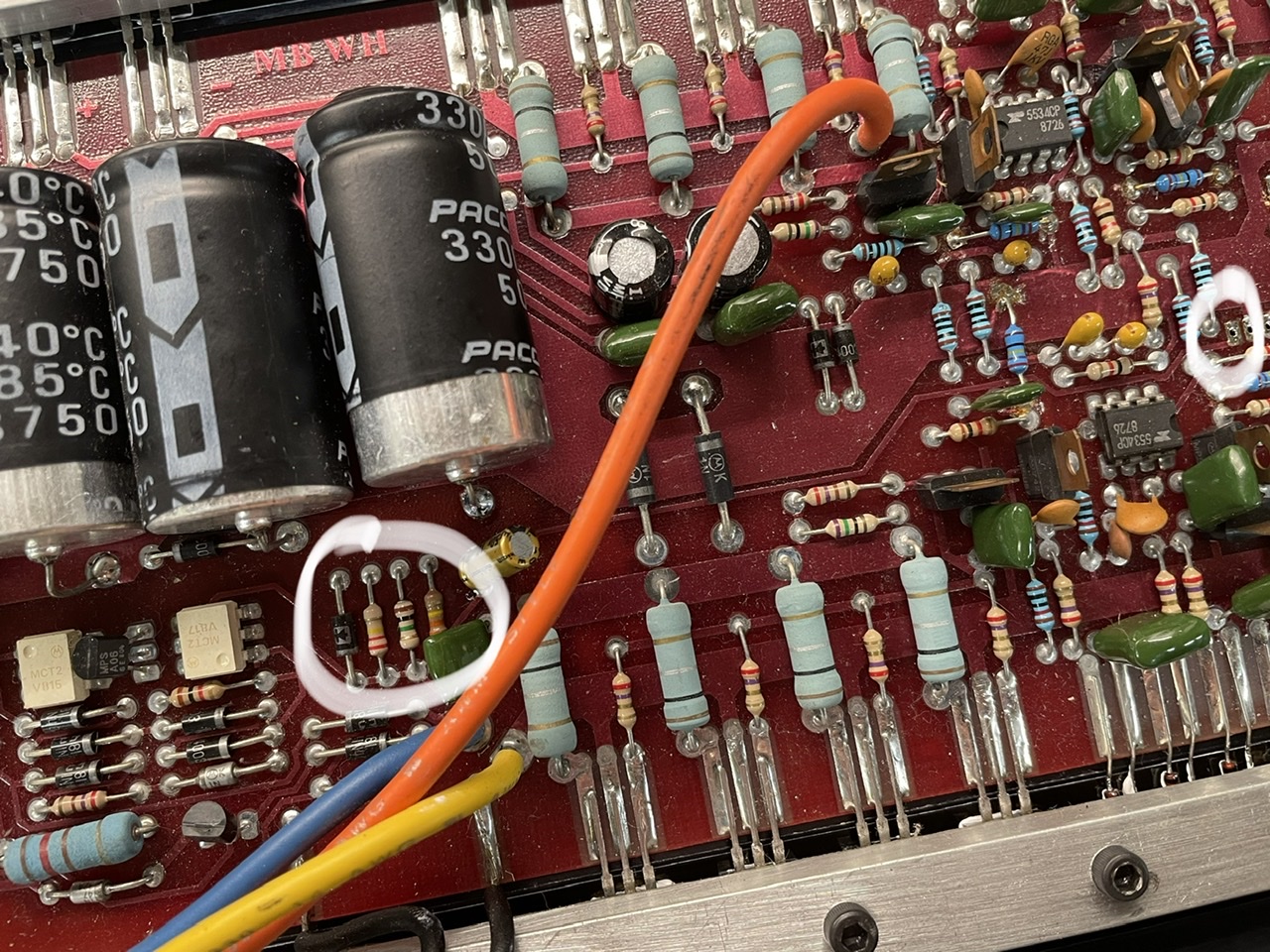

Which transistors are muting here?
Got it.
Leg 3 is gate of those and there are 2 of them, thats 1 per channel.
1: 0
2: 0
3: -3.250vDC <--
Then under load/draw, the left channel 2N5639 stays the same, but the right channel's drain rises up to +0.25vDC. Still -3.250vDC on both muting transistor's drains.
Pulled both not to difficult. The pads are still measuring the same, -3.25vDC, 0, & 0.
The 2N5639s themselves are measuring 33 ohms between source and drains.
Surprisingly, the amp seems to be producing clean audio now, and no DC on the outputs - almost like its fixed without the muting circuit.
Theres a diode in the center of the board thats connected to the gates, measures -3.25vDC on one side, and -40vDC on the other side. Diode check on the PCB passes with fluke.
