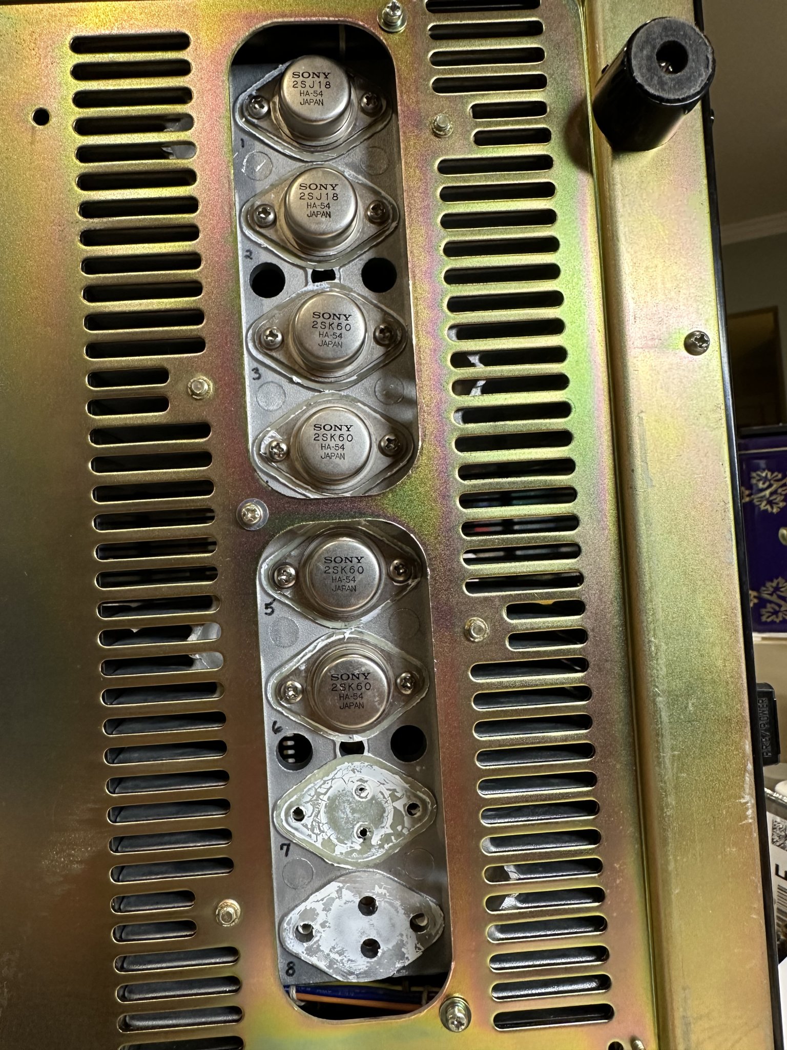

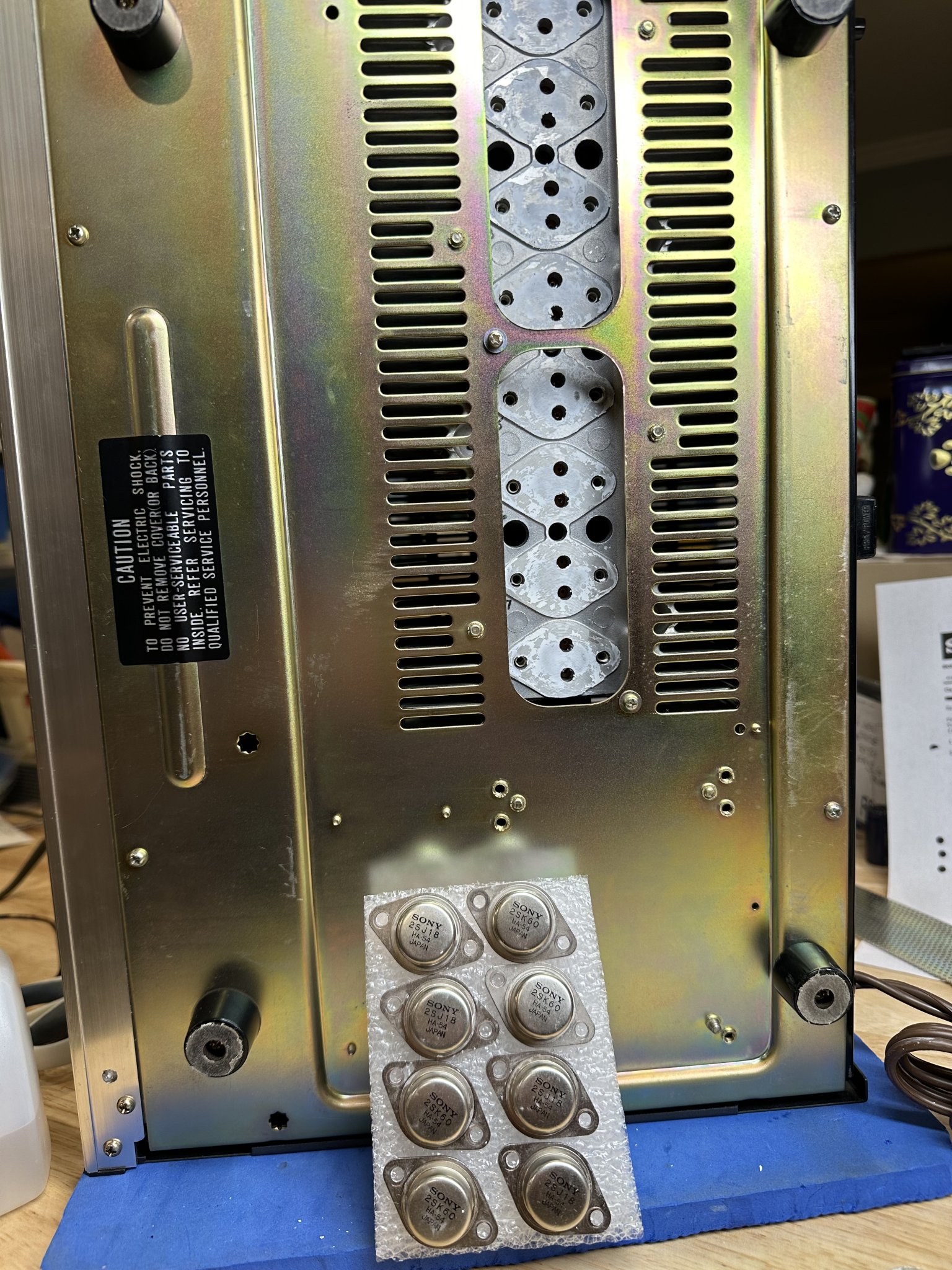

Unpacked the TA-5650 today and was very impressed with the overall cosmetic condition. The wood side panels look pristine!
But, what’s the condition of he most important parts….the VFET’s!
I removed them and followed the procedure outlined in SB#62
All tested good for the diode check.
Resistance ranged 1R6 - 2R1 for all.
I’d say the VFET’s are good and will proceed with full RestoMod🤩.
