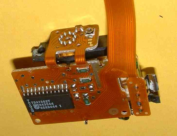

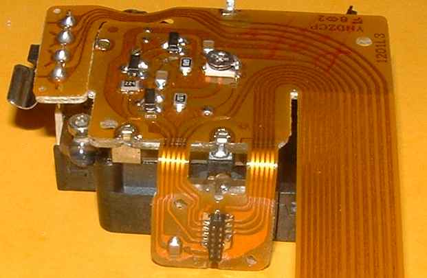

Which devices are on the foil PCB of your new optical pickup?
In those days there was only three kinds of foil PCBs:
1) with TDA1302T (i. e. integrated RF amp section and APC) mostly CDM12.4 - and VAM1205/VAM1252 with brushless disc motor (spindle motor)
2) discrete solution (discrete APC and without RF amp section)
3) with TZA1022TS (successor of TDA1302T, CDRW compatible - mostly used in VAM1250, not compatible to CDM12.4 head - check out picture number 7 by post #10 about
http://www.diyaudio.com/forums/digital-source/118902-stripdown-clean-cdm12-4-a.html
For your Meridian I think, the best solution is to order the VAM1252 head (professional version of CDM12.4) from the Marantz CD Player model CD7. Unfortunately the cost therefore is at least ten times higher, but you will get perfect NOS quality standart.

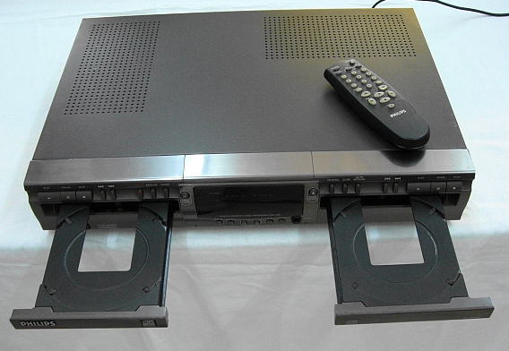

P. S. A cost effectice burner/player, where the CDM12.4 is in use, is the model CDR765 from philips. For checking the RF signal and other measurement places is the service manual from this model helpful (check "hifi engine" or "hifi manuals").

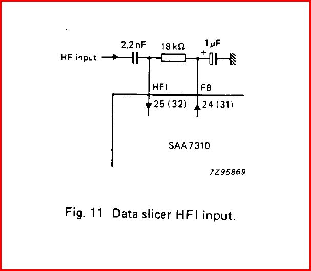

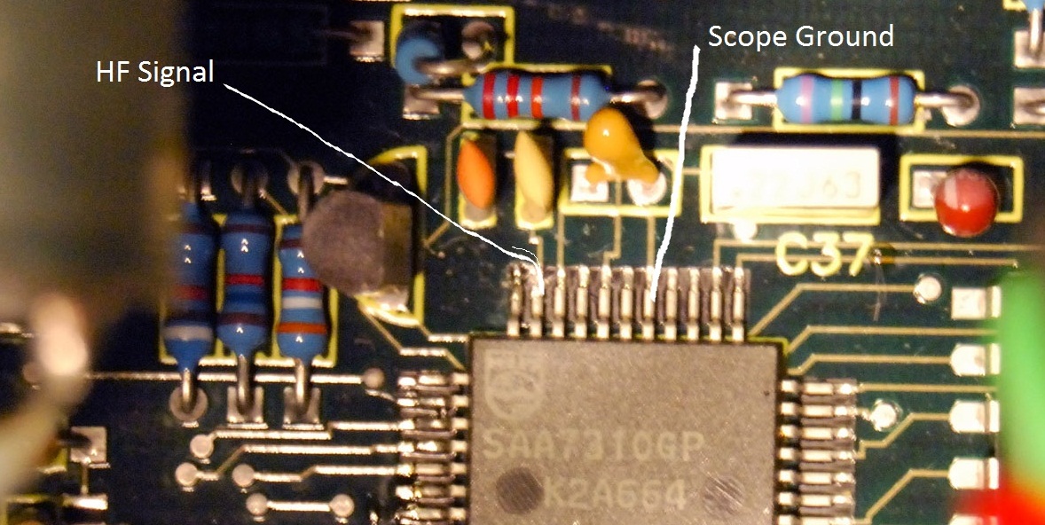

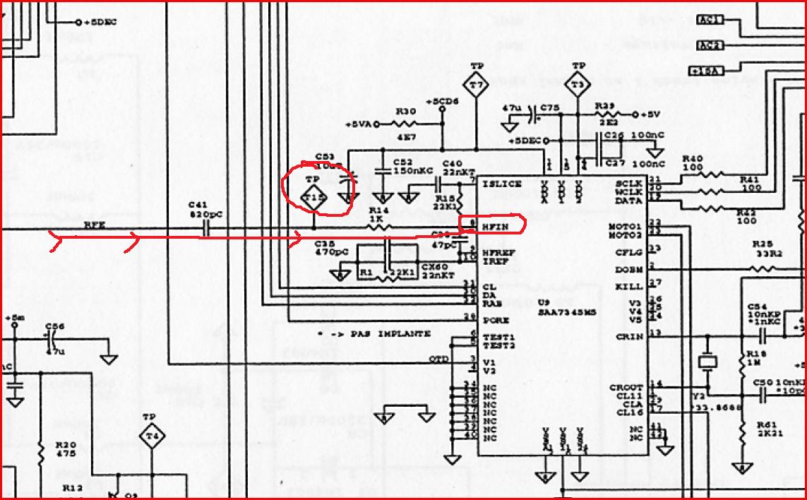

When using the scope it is important to use the correct ground for these high frequency signals and also to use a proper probe, preferably a "divide by 10" as that raises the loading and reduces the capacitive load of the probe.
These are the pins for the SAA7310. It might be worth reading to the "left" on the 2.2nf cap. Use the same ground as the 1uf cap goes to. Note the absolute value of these parts may differ in your player but they will be present. The alternative pin numbers depend on the type of package, SMD or DIL

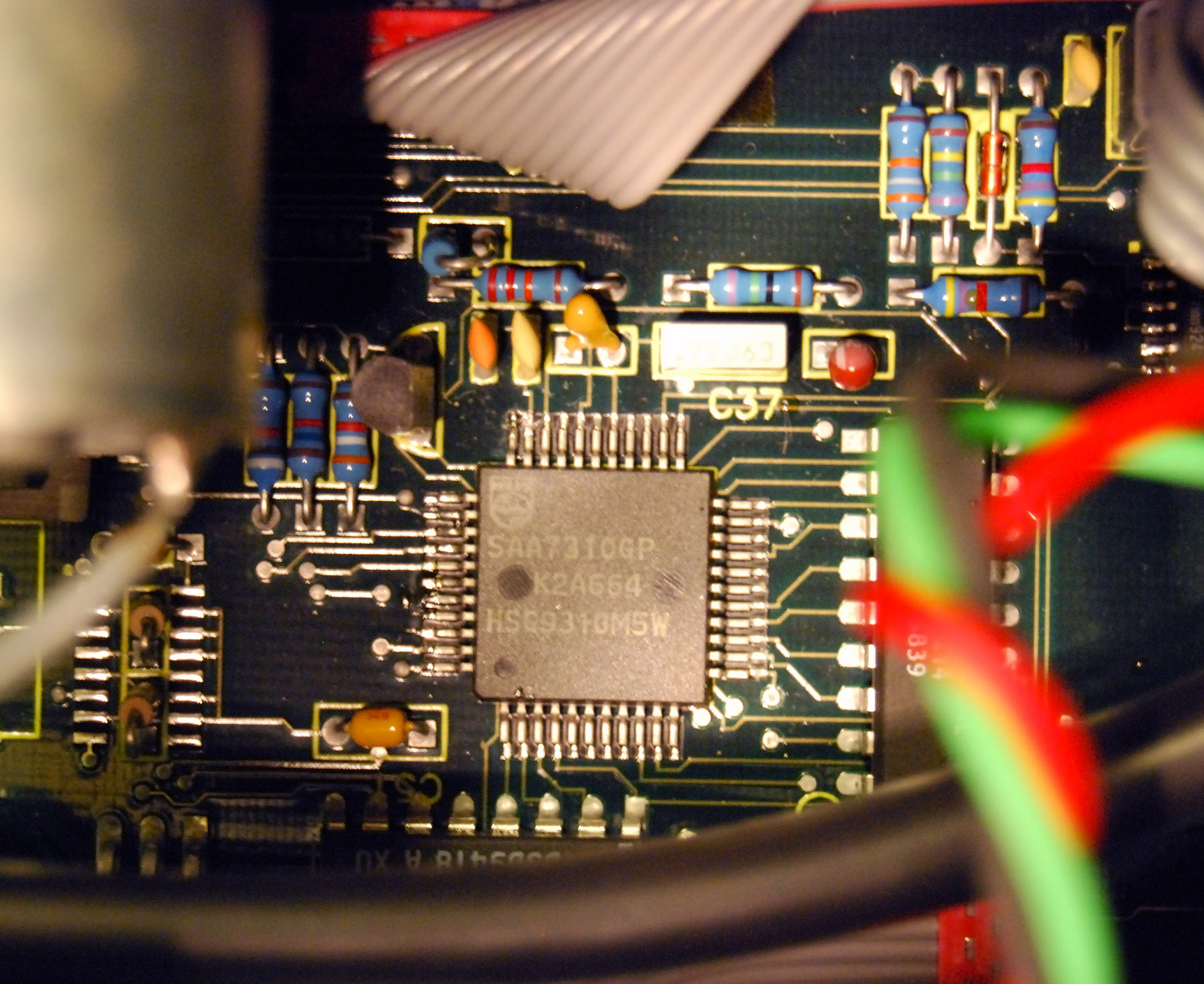

Finally finished those speakers and am back to the Meridian. The "new" laser didn't work and so I put the old one back in. Seems like the reading issue is worse. I didn't check the caps, but the values are no too common and didn't have any replacements on hand so I wanted to try to properly scope it to see if the laser is still at fault.
I'm attaching a photo of the chip and surroundings. Mooly, I followed your schematic a few weeks ago when we started this chat. I didn't get anything like the images you attached, but didn't feel like I could get a good ground and trace around that capacitor. After seeing the chip itself, do you have any recommendations?
at best you order the CDR765 mentioned about post #20.
You will find presently one device in used and working condition by ebay - go to
Philips CDR765 CD CD Recorder | eBay
Then you can replace crossover both the complete mechanism and the laser heads only and you will see, what happens (please note, the laser head you need is in use only in the replay-section and not in the recorder section).
This means, you have good conditions for your troubleshooting.
Without a second cd player unit for checking the optical pick up/mechanism stuff it is very difficult to obtain a clear statement concerning the right error-causing device.

Thanks, Mooly. Like I mentioned I don't know much about using the scope (and mine is very simple), but I did try the spots you mentioned and got a fairly good wave. Seemed when it skipped, the wave lost focus...I feel like I'm letting down the folks that contributed to this chat, but I'm going to have to take it to a pro. There is a tech near me who owned his own high end shop and repaired the gear he carried. He has done some nice work for me in the past and I hope he can get it going. I'll let you all know what he says. If he can't fix it, you all may hear from me again.

Another thought if you are interested in narrowing down the problem is to monitor the DC voltage across the sled motor as a disc is playing. The voltage is normally very low as the motor is "shuffled" along. If you watch the worm gear while playing a CD it almost trembles to and fro advancing a few degrees at a time. If the sled is sticking the voltage will suddenly start to rise until there is enough force to overcome the friction and the sled jolts forward and which you hear as it jumping.

Next step would be to see if the amplitude or quality of the RF signal looked different between CD's it plays and those it has problems with. I would imagine you would see around 1.2 to 1.5 volts peak to peak as viewed on the scope.

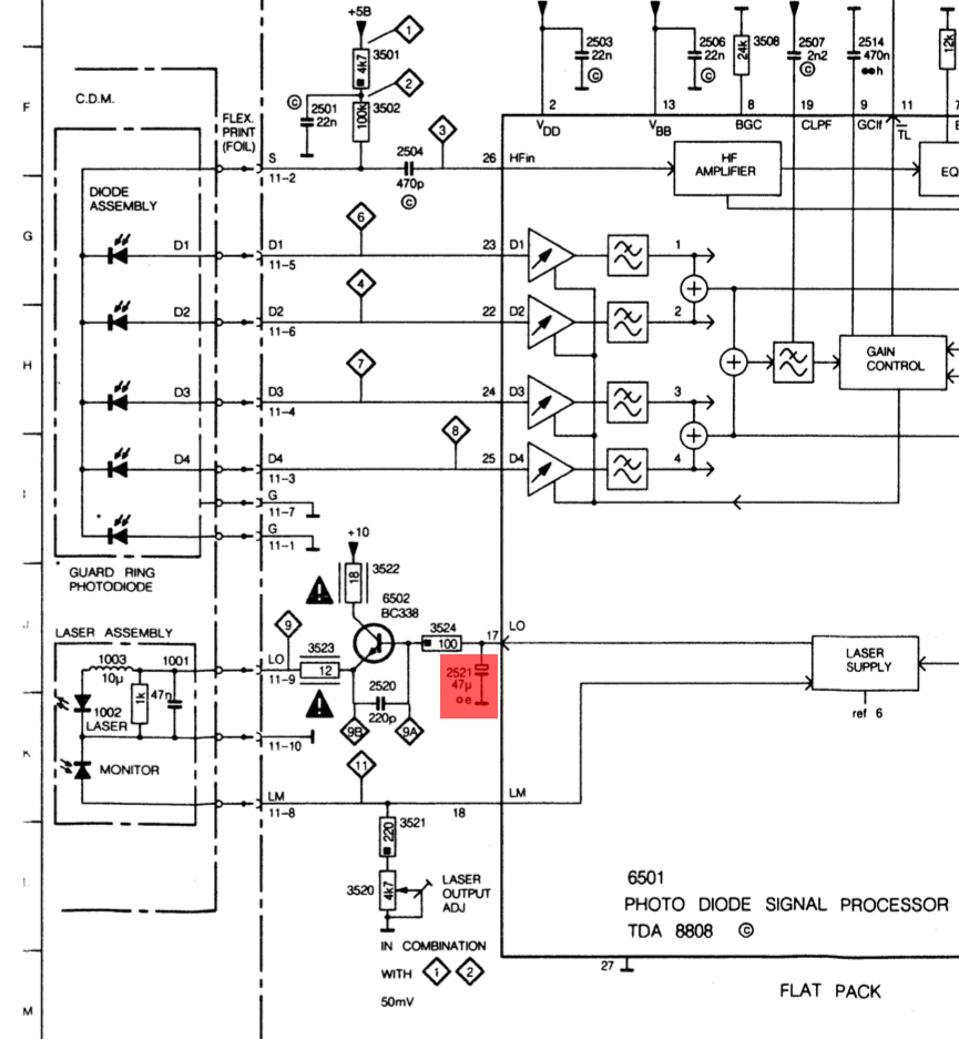

I don't understand this term in case of quality standart: "do not use oddball or boutique parts"
I think, you mean the marked cap here:
http://obrazki.elektroda.net/7_1269981790.jpg
also mentioned here:
http://www.diyaudio.com/forums/digital-source/181450-marantz-cd-75-se-mk2.html
In some models the value is 33uF, in others 22uF or 47uF.
This cap is in use at pin 17 both by TDA5708 and TDA8808, as I know.
The value isn't critical, but the voltage value. Not, because the voltage has a hugh value in this application. Rather low-voltage caps do have mostly short live time. Therefore I use still 63V versions - e. g. this 22uF/63V version:
http://www.exxelia.com/fichiers/produits/20090409_134615_promisic_co31_relsic_co33.pdf
(Order Code A711723)
also this version is suited:
http://www.exxelia.com/fichiers/produits/20090409_134505_prorelsic_125.pdf order code A701103
Additional I introduce a bypass MKT cap (Wima MKS 0,47uF, 1uF or 2u2).
BTW - this cap is a component of the APC circuit for the laser diode, mostly a RLD78 version from ROHM.
