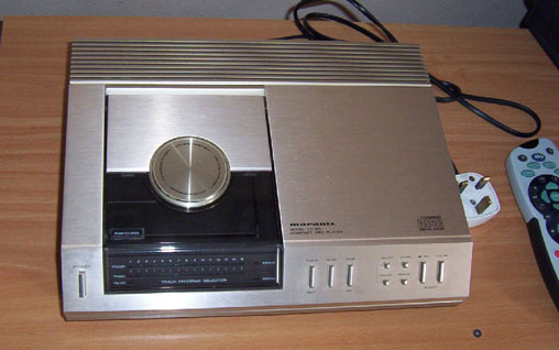

Success!! After resoldering the links I now have sound on left and right channels 🙂 The old lady still sounds better then the modern player I've got many thanks for your help, I'll try and get a picture uploaded for you, meanwhile..... I've now gone and got (from ebay) a Marantz CD73 which has a duff draw mechanism, the gears are ok as is the belt but when you press open nothing happens and I can't hear the motor which I suspect is duff. Are there any checks i can perform before trying to get a new motor?

Thanks for the info what do I need to check for this possible problem? as promise here's a pic of the Marantz CD63
