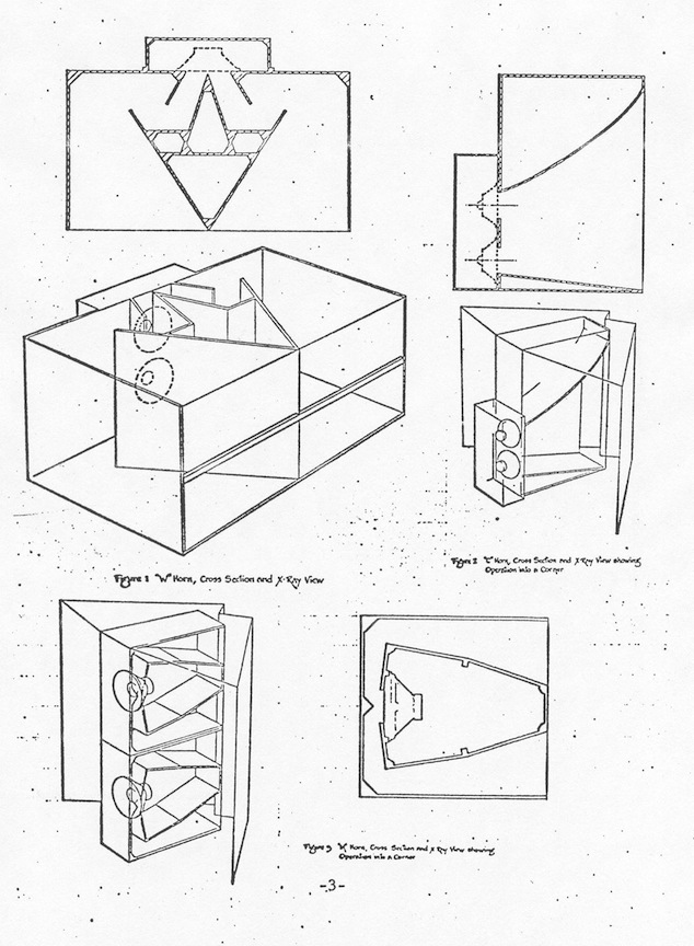

I thought there were multiple setups for the movie "Earthquake"
from wiki: Sensurround involved the installation of large, low frequency, horn-loaded speakers which contained specially designed 18-inch Cerwin-Vega Model 189 E drivers in custom black wood cabinets. Three horn configurations were available, Model-C (Corner), Model-W (Folded Bass Bin) and Model-M (Modular). The Model-C and -M horns required stacking in groups of four, increasing effective horn mouth size to achieve the low frequency target. They came with special extenders used to widen the mouths of the horns and take advantage of the theater walls to further increase low frequency extension. The Model-M horn had a dedicated "Mouth-Extender" available when it was used in the front of the theater. While installation was customized and varied in each theater, the Sensurround horns were typically placed beneath the screen in front and in the back corners of the theater. Often, rows or sections of seats would have to be removed to make room for the large Sensurround horns. In large theaters, up to 20 individual horns might be used along with custom-built bat wings and mouth extenders.
