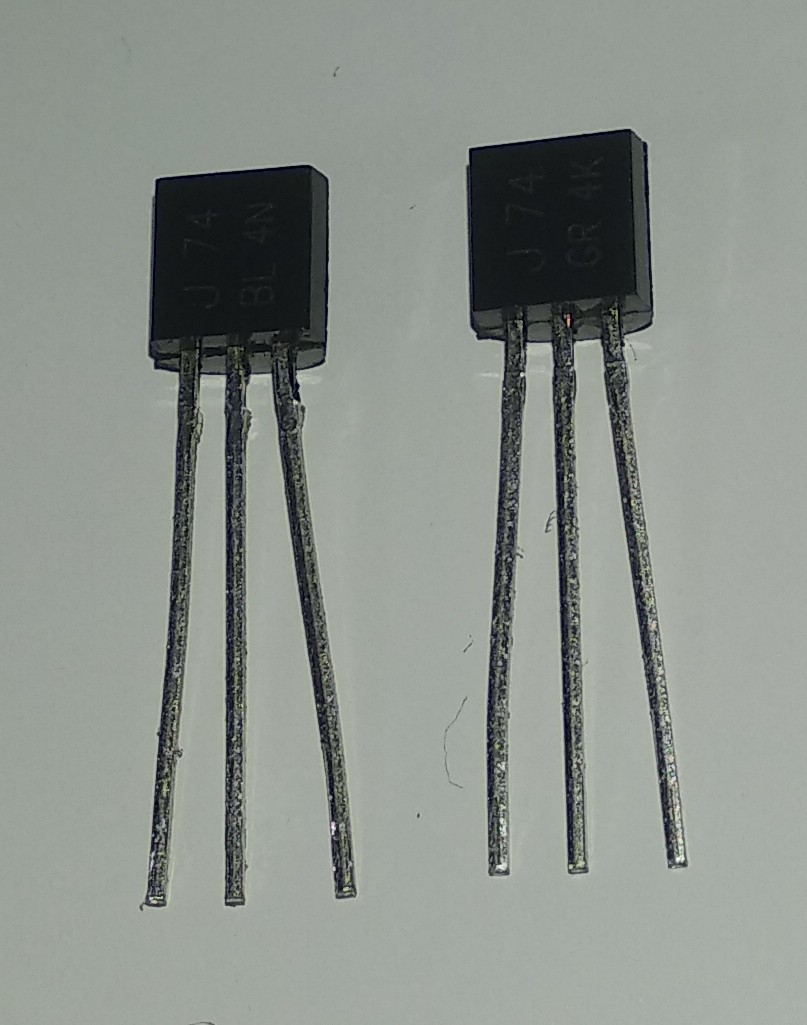

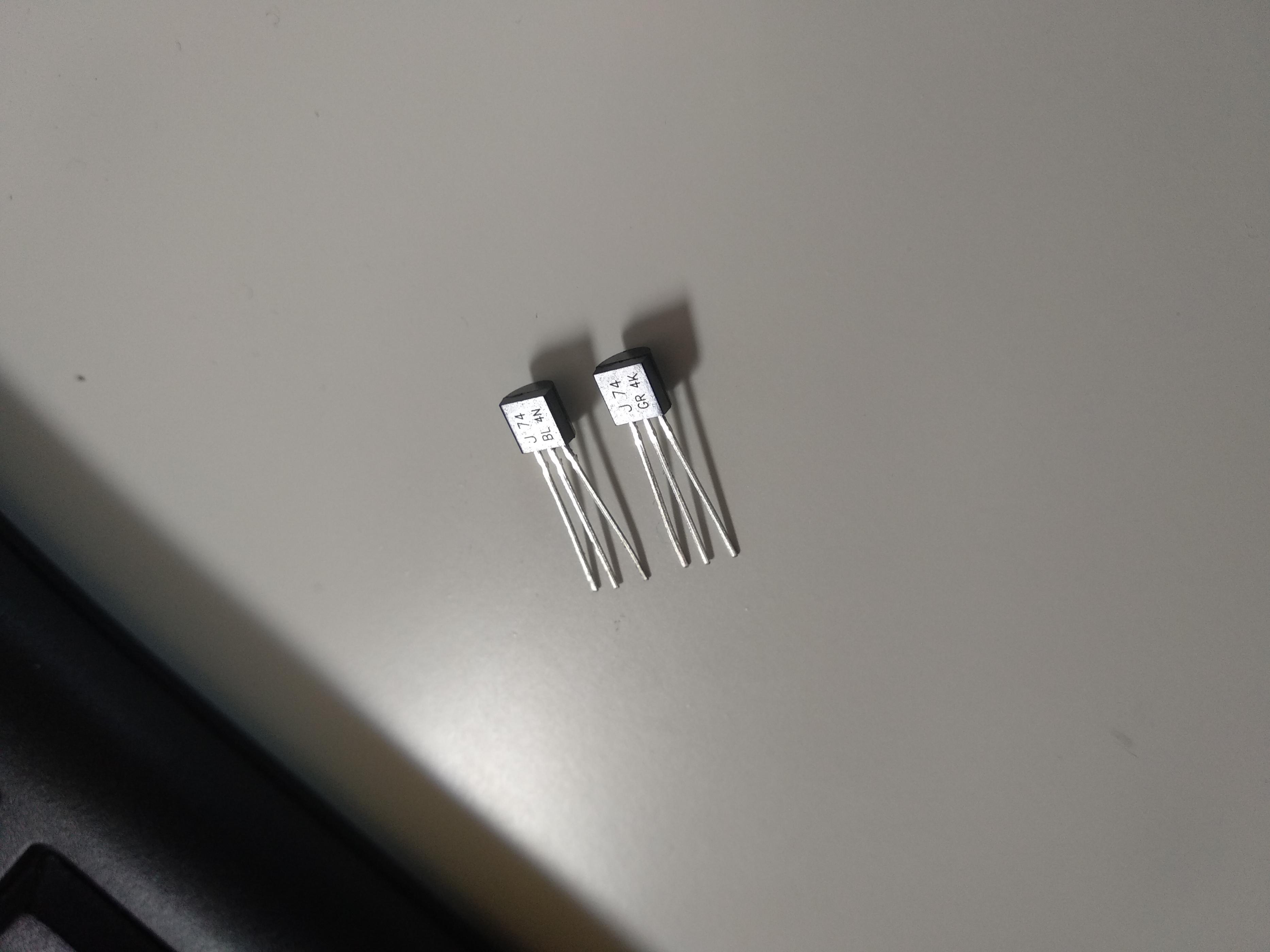

I have attached 3 images of the JFETs.
If you guys have any more ideas how can I test them if they are real, feel free to let me know!
