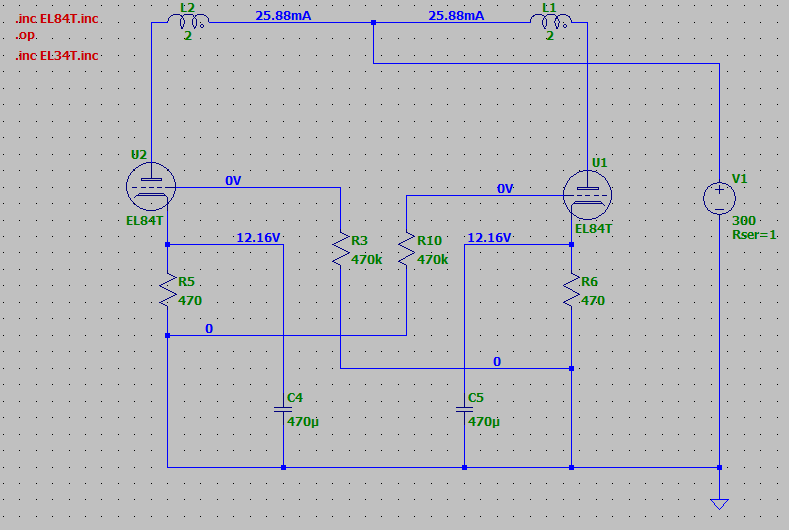

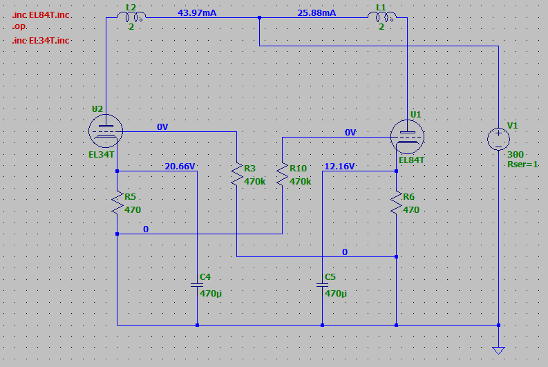

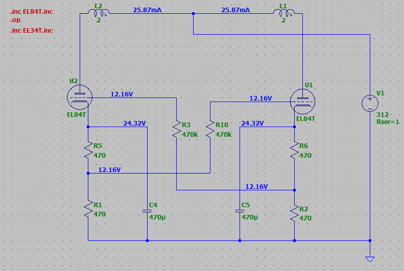

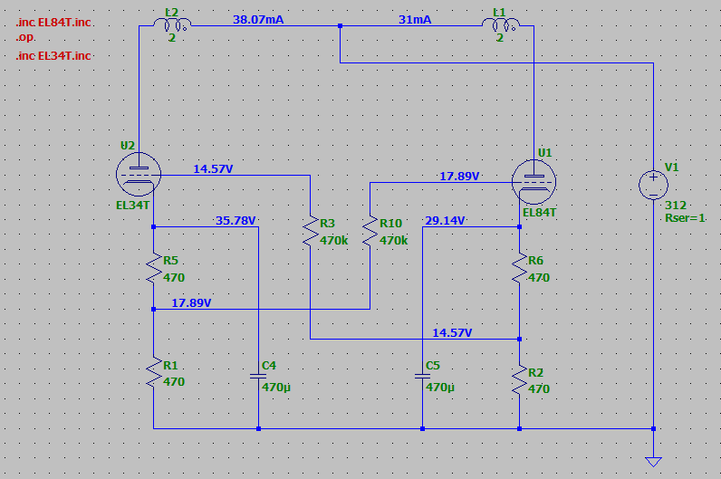

Here's a little spice "experiment".
To emulate a tube going into runaway, the left one is being replaced by a much stronger tube.
(Ayumi models for 6CB5 / EL84 and 6CA7 / EL34 used)
First: 2x EL84 in triode, 470ohm single cathode R, 300V B+
2nd: EL34 / EL84 in triode, 470ohm single cathode R, 300V B+
3rd: 2x EL84 in triode, 2x 470ohm garter, 312V B+ (to compensate for 12V drop in 2nd R)
4th: EL34 / EL84 in triode, 470ohm garter, 312V B+ (to compensate for 12V drop in 2nd R)
Result:
plate current rises from 25.9 mA to 44 mA without garter bias
plate current rises from 25.9 mA to 38 mA with garter bias
The effect is not big but in the right direction, mitigating the rise in current.
It also shows that the other tube suffers too when one goes bad.
