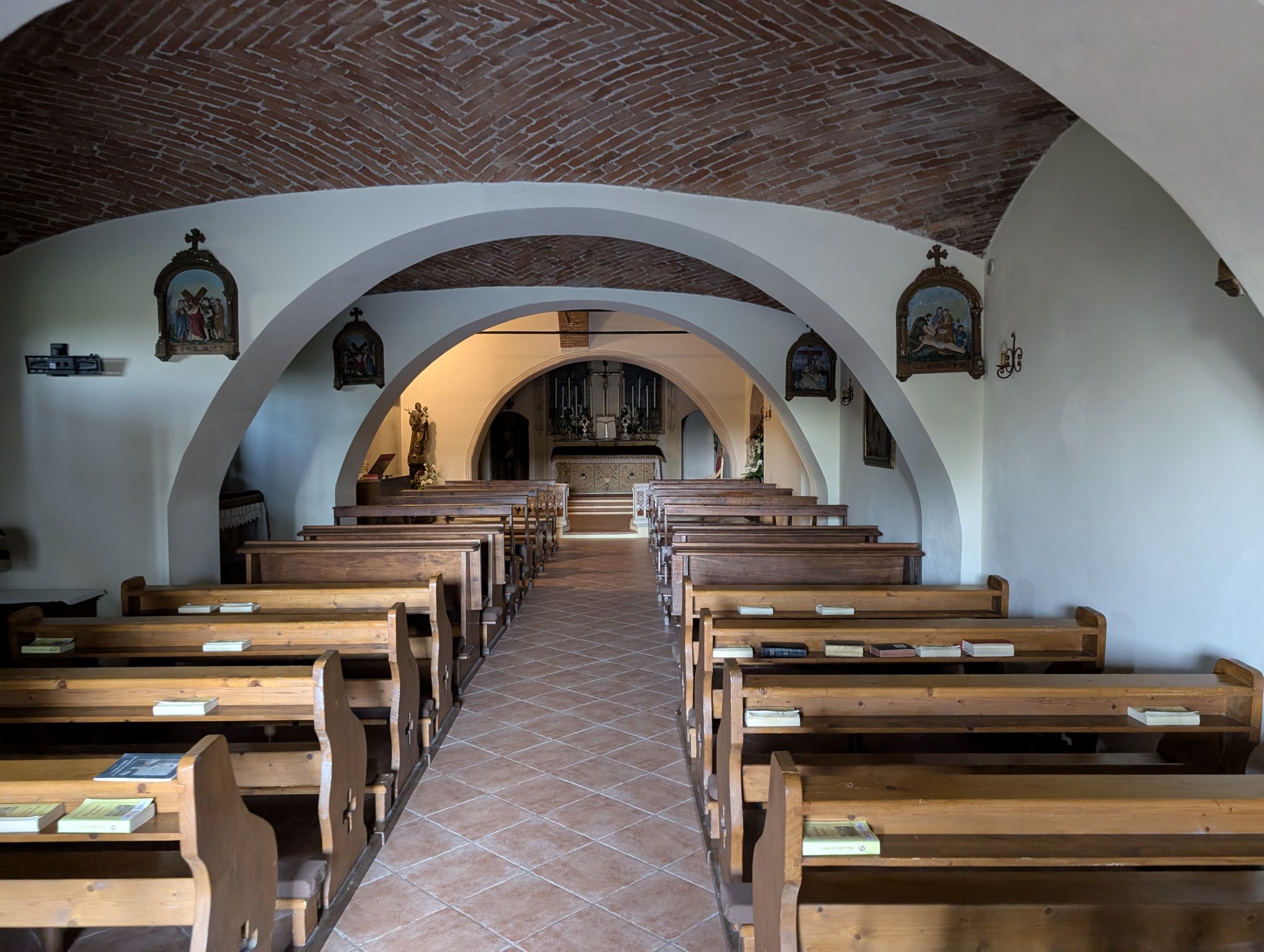

I agree rather nice church, lots of corners.
With corner loading or wedge the box right in a corner, firing straight up.
Exit the ports so they dont face the wall of course.
You get a lot of extra bass reinforcement with corner loading

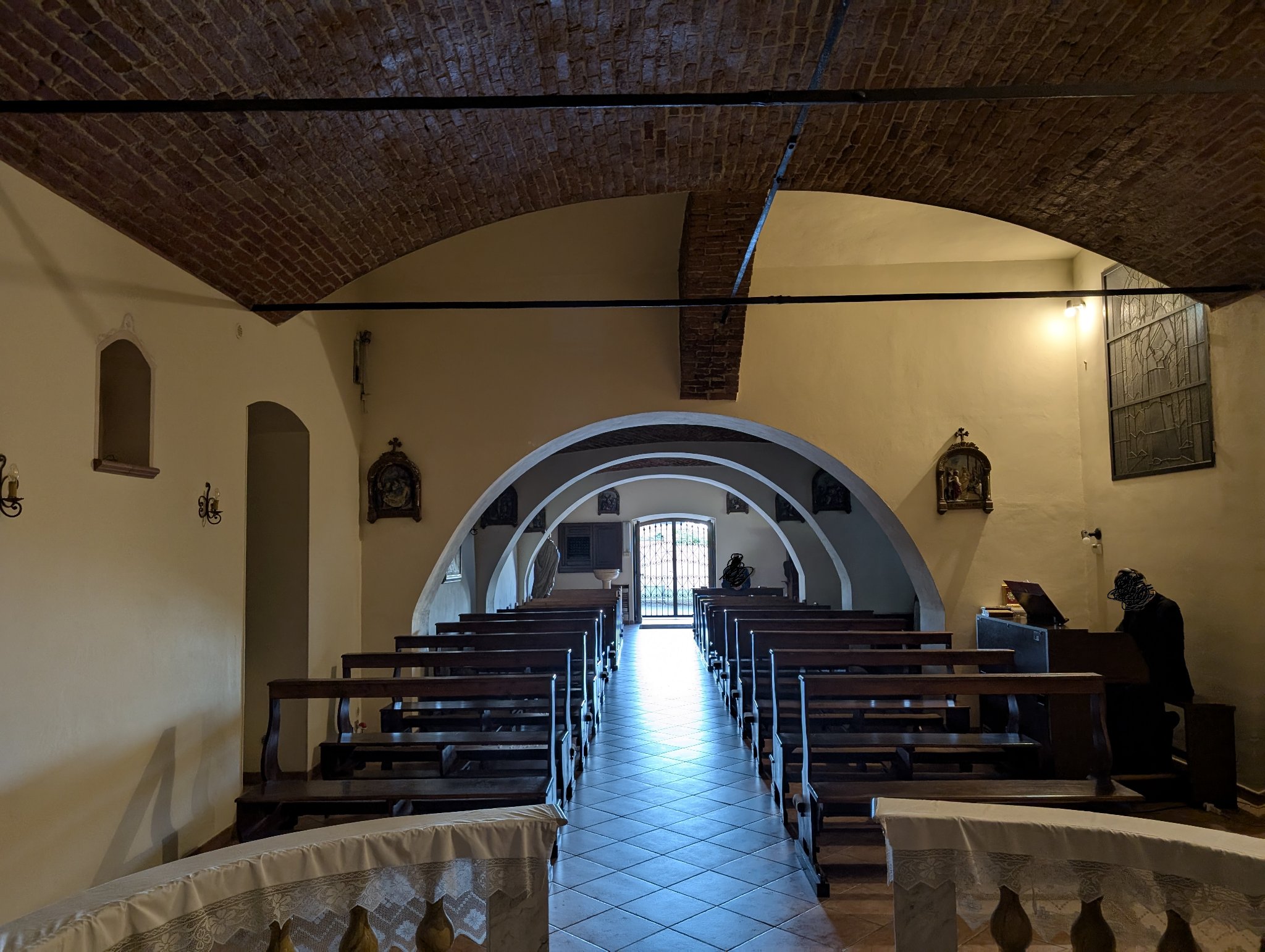

Working with a venue such as the chapel that is shown is just beyond my comprehension. Measuring... from where? Placement of sub? Same question. I would be spit balling since there are multiple places to sit as a listener, and I can't even imagine what the room modes would look like in such partially partitioned area the size of this. If I could just wave a magic wand, the sub would be in a subterrain position with a vent in the floor.

I may be stating the obvious, but that sort of enclosed space looks likely to get lots of room gain below ~50Hz, so the requirements probably don't have to be so extreme to achieve decent 16Hz output.
4 x 15" woofers in large sealed boxes would rattle the windows, and probably do it at quite low power, afaict. SB Audience drivers come to mind.

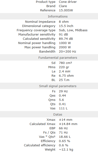

Yes, and they have a cool parameter search that includes T/S. So it's easy to filter out.I'm in the US, but this company has good stuff: https://en.toutlehautparleur.com/
I did a quick search for example, Fs<30Hz, BL>10, QTS<0.5.

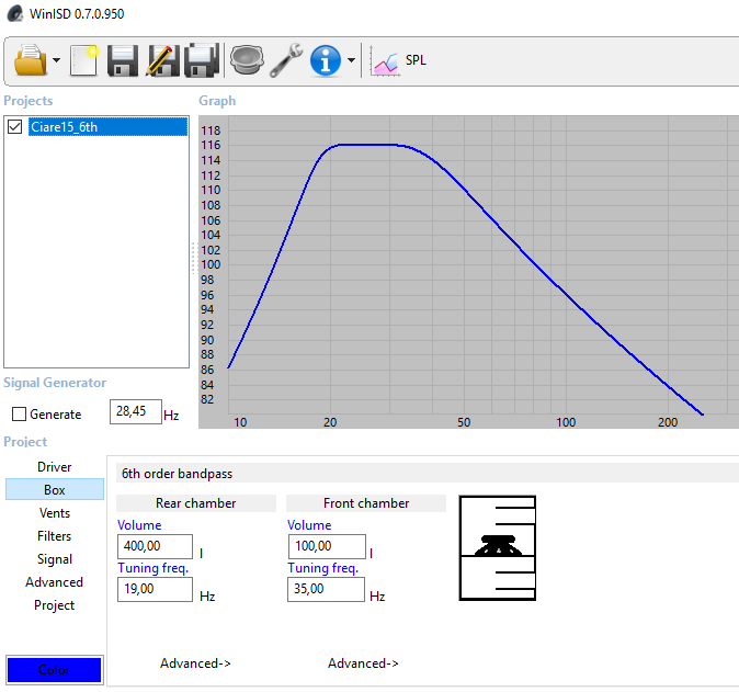

Found the Ciare 15.00SW for EU281.00 - it's interesting.
In a dual-chamber 6th order ported (big) enclosure, it responds from 18Hz to 42Hz (-3dB).
With 400W gives 116dB.
Just ideas...
