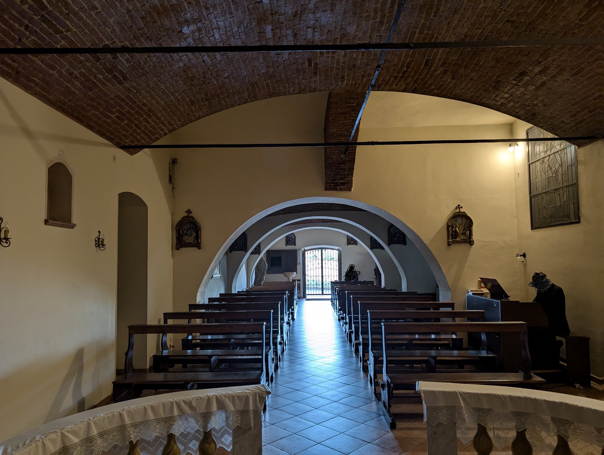

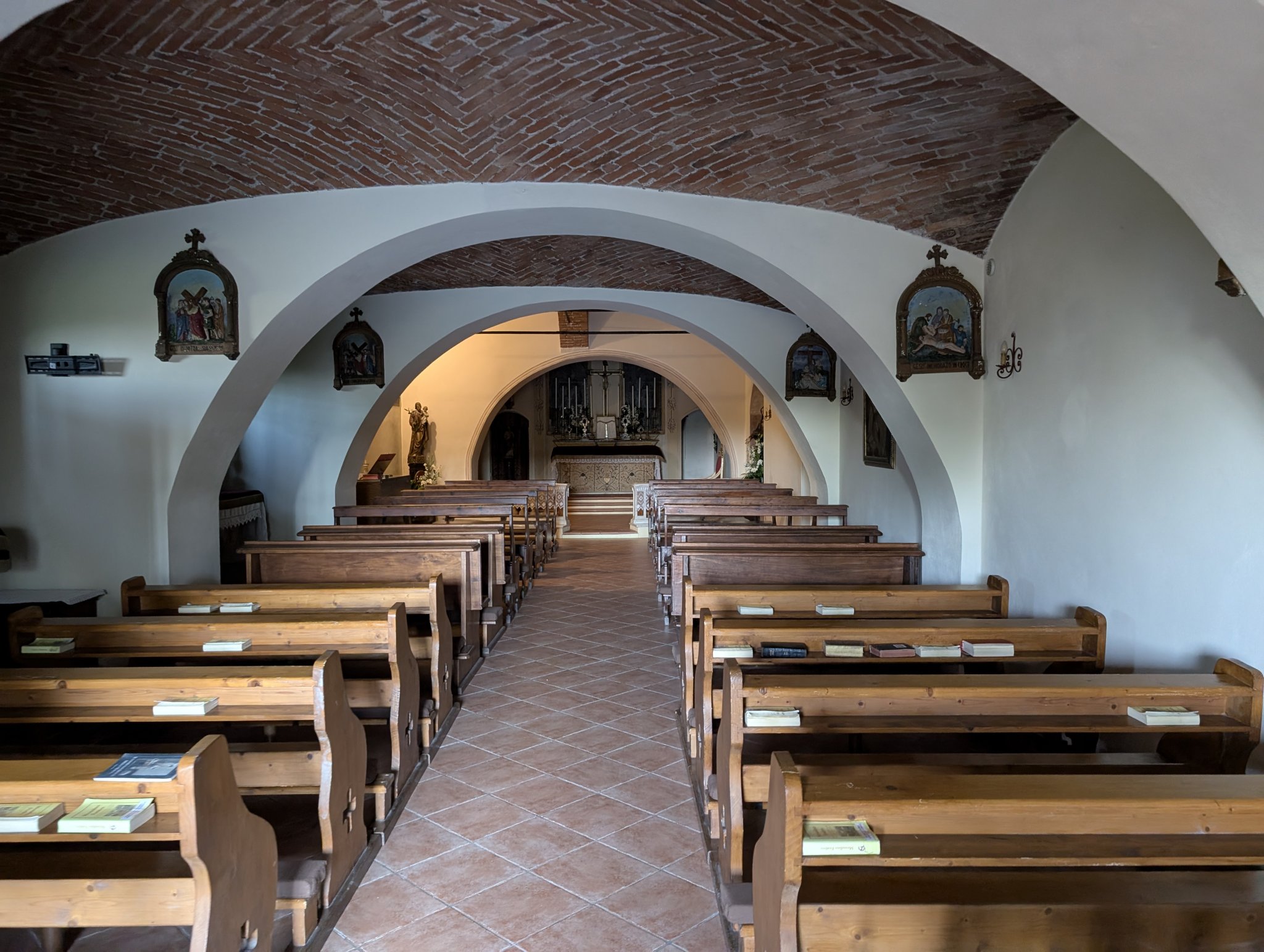

The room is a rather long, somewhat low rectangle of completely hard surfaces (though plenty of soft surface area when full of people) of about 5m wide by ~20m long, and varies from ~3-6m high, depending on where you are. Tile floor, plaster walls, all wooden pews (no cushions). There are several arches that come down/intrude quite far. I will get some pictures as soon as I can and post them here for better reference.

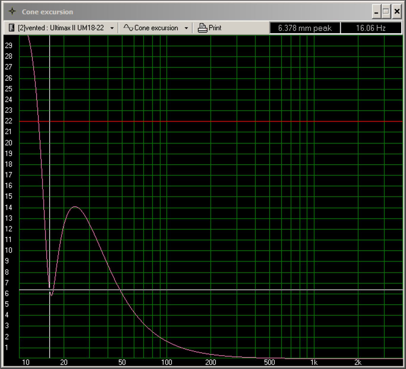

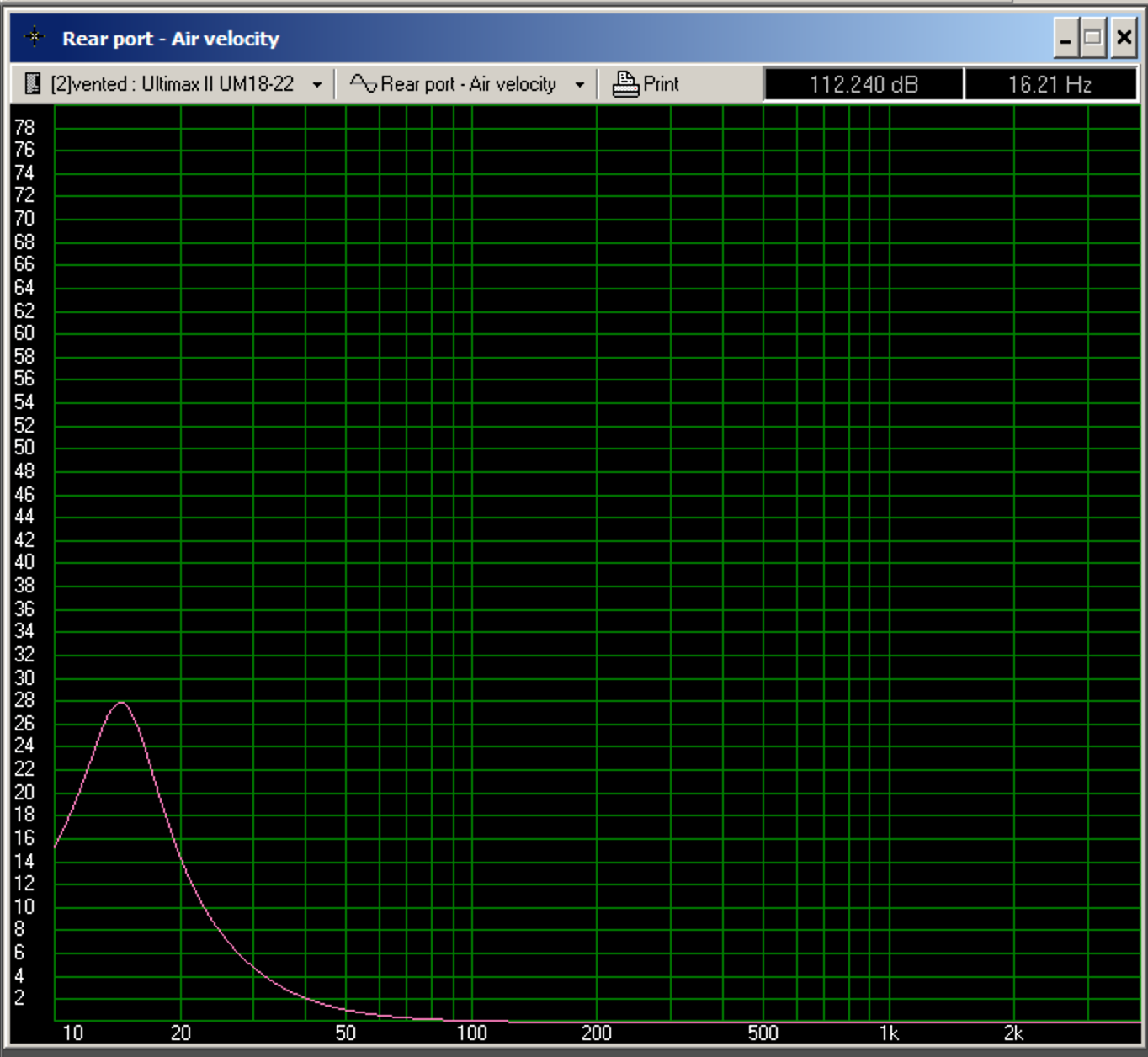

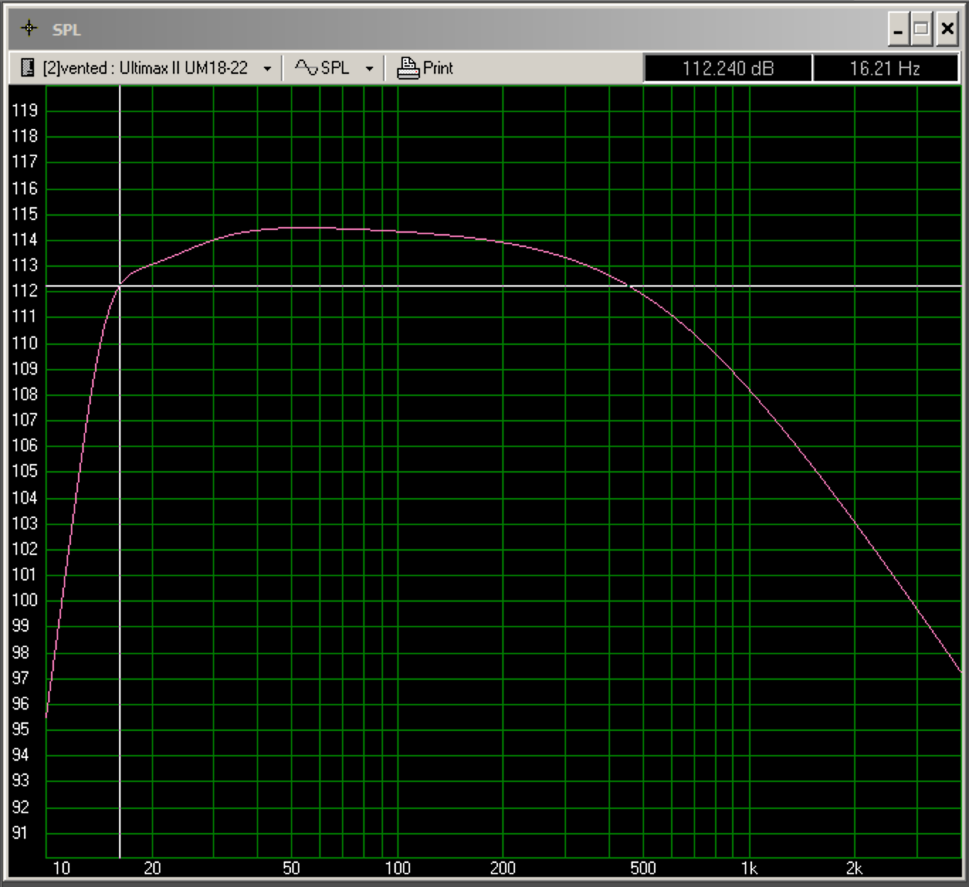

Dayton Ultimax II UM18-22 in a 500 litre box with three 10 cm diameter vents 47 cm long. At 400 watts, power and excursion will be well within limits. Soundimports.eu will have them at the end of June at about €450 so you have enough left over enough for lumber and a hefty amplifier.

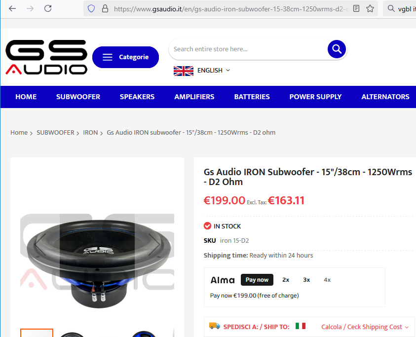

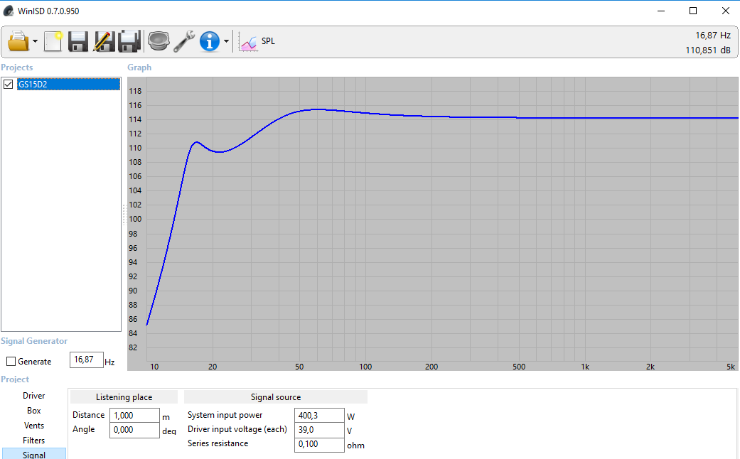

Another option is to use an italian local vendor (I don't have experience with their products, I just looked into their site).
GS Audio IRON 15" D2 for EU199.00 each. Just an example - you can search other options and post here, so we can simulate and comment.

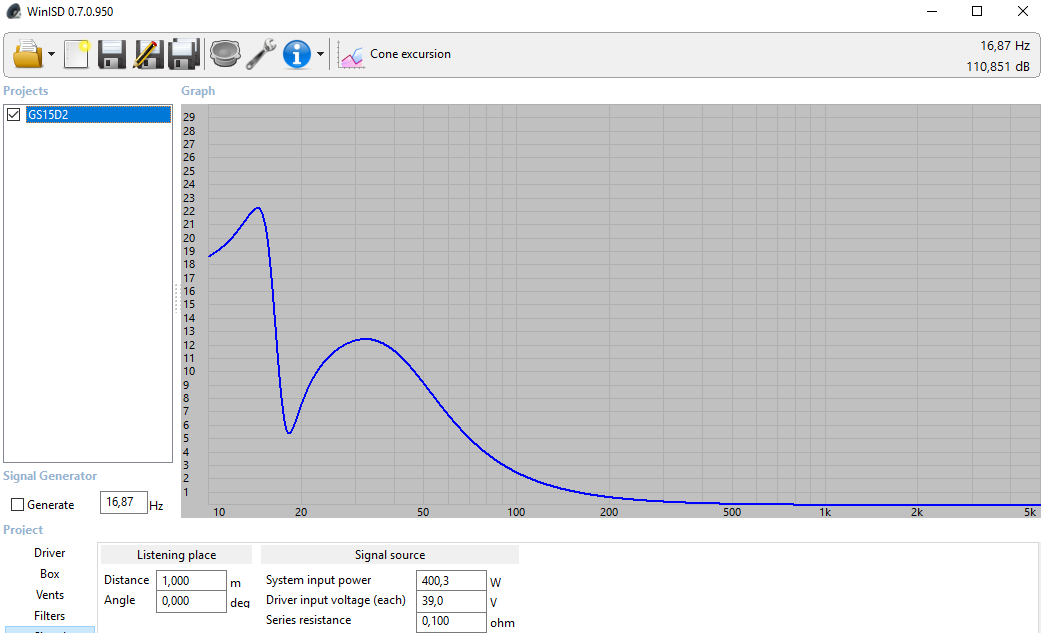

Using around 250-liter box and 400W you can have up to 110dB SPL at 16Hz. Round ported box tuned to 18Hz (5" diameter and 37cm long)
Two of these speakers will produce a lot of bass and it's very easy to build - just a rectangular box 50cm wide x 100cm tall x 60cm depth.
PS: Very beautiful chapel, by the way! Love these cosy european places.
XMAX = 36mm, so a lot of margin with 400W

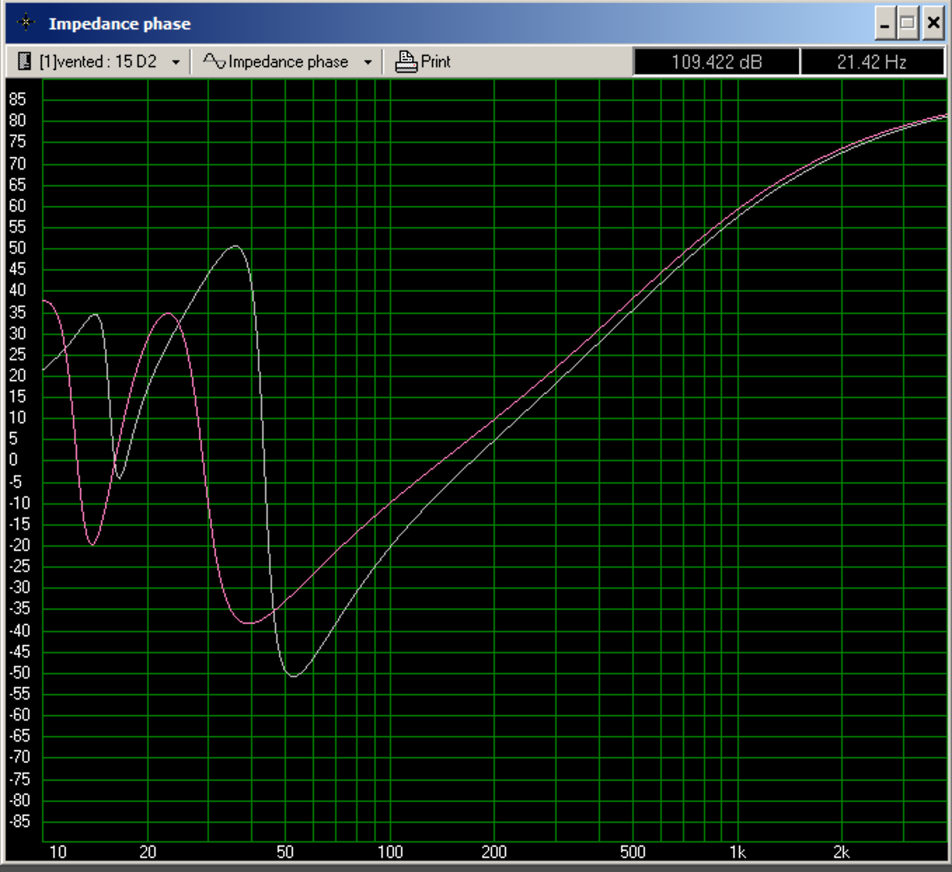

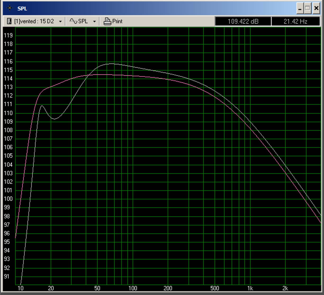

As a comparison, one GS vs one Dayton at 400 watts. Note the 18" is more efficient below 40 Hz, but at half the price of the Dayton two of the GS 15s would be louder across the band, and especially above 40 Hz at +6 dB minimum. Well done Ron! Of course you'd want two amplifiers, unless one happens to have a kilowatt-class amp which could drive 2 ohms just lying around. It's an interesting tradeoff. At least the cabinet size would be the same at 2x250 litres = 500 litres.
The impedance phase angle might be a concern: at +-50 degrees worst case the driving amplifiers could be in for a fun time.
