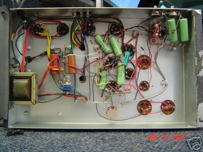

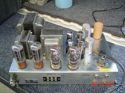

I was wandering if these amps make good projects. I am a beginner in building so I want to work with something that is already there to get my "Feet Wet".
This came out of an Organ. The only thing I know is that it came from an Allen organ dual input single output and uses 6550 output tubes. I am assuming this would be mono and I would need two to make it a stereo and a preamp.
can anyone help me out here.
Thanks Steve

It might well be quite a good amplifier. Since organs deliberately produce full power sine waves at low frequencies, the output transformer is probably quite good at LF. It might not be so good at HF. Finding another organ amplifier to make a stereo pair will be hard. Still,it would make an excellent learning project.
Or maybe it could make a nice subwoofer amp. (if indeed the LF response is suitable.) P-P 6550's should make a fair amount of power.
Allen organs tend to be upscale and very high quality. Overbuilt things even. Though they make home units, their main business is in church sound systems. That should be a pretty nice hunk of gear there. Don't know just how hifi it is, but it should be well built.

Interesting read, what it has done for me is raise my level of excitement. This is what I've been wanting to do since I got bite by the tube bug. I'm not an electrical engineer so I want to learn how to build one and what better way than to learn by modifiying a well built amp but not quite up to par. I will have to get the schematics. From reading in this forum I am assuming that at 90 watts this must be other than a class "A" and that means distortion. Am I correct? If this is true, will I be able to compensate or couold it be turned into a class "A".
