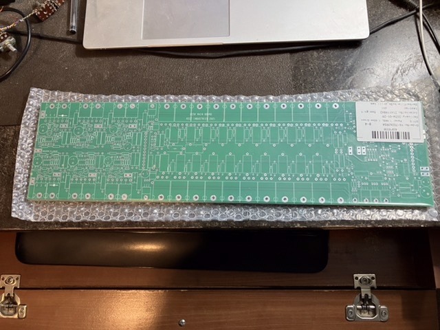

If I found somebody in the states who would make qty 15 18.5x4.8in 2 oz copper boards for $200 I’d use them (94.70 from JLC). Last quote from Sunstone gave me sticker shock. It had damn near doubled from when I was looking into it about 3 years prior. Design wasn’t done yet, but the size has been fixed since I acquired the heat sinks. It was only around $30 for the 5 1 oz. mock-ups I just bought to use for the drill templates. They were in a box with various protos and the big cap boards to mount rails of snap-ins to get aggregate shipping. Still keeping it way under the tariff limit.
