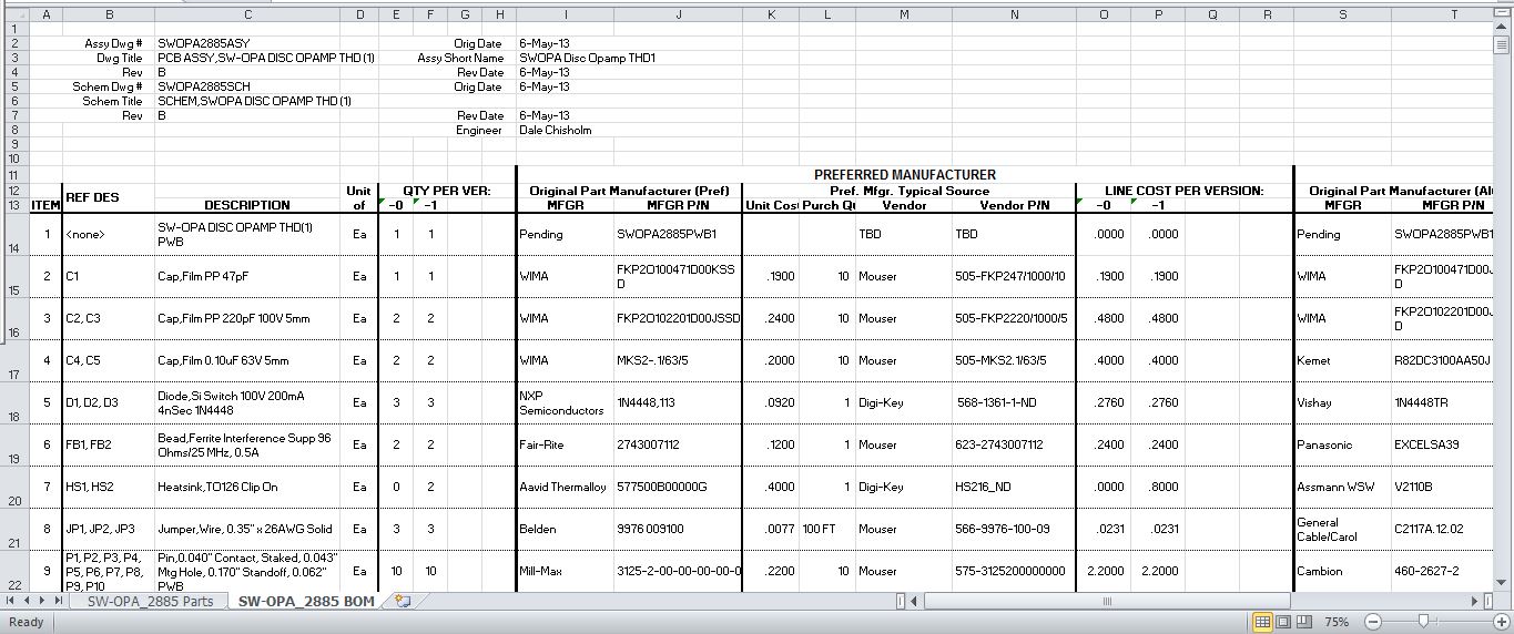

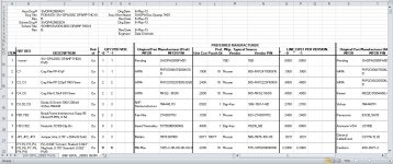

I use an Excel spreadsheet to help monitor parts requirements. I have attached a screenshot - there are real-life samples of the actual Excel file in the project documentation I posted to the "Discrete Opamp Open Design" thread a while back. The file shown in this image was taken from post #2909 at: http://www.diyaudio.com/forums/anal...screte-opamp-open-design-291.html#post3485352 ; there's another sample at :
http://www.diyaudio.com/forums/anal...screte-opamp-open-design-271.html#post3374536 . You'll have to download the archive file " Post2885_Docs_Edited_Part1_B.zip " from that post, and extract the Excel spreadsheet.
The spreadsheet is organized as two pages. The first is in "Parts List" (PL) format - one line for each component reference-designator in the project. As I develop a project's schematic and PWB layout I identify suitable components - and an alternative, if possible - and record the information in the spreadsheet's first page. You may think of this as the "Engineer's page", telling the principal characteristics of each part used in the design.
The second page is in "Bill of Materials" (BOM) format - one line for each component part number in the project. It shows the net requirements for each component - so-many 470 ohm, quarter watt resistors; so-many BC560 transistors; etc. You may think of it as the "Purchasing agent's page" (or "Storeroom clerk's page"). Consolidating the information from the first page onto the second page is a totally manual operation I perform when the design is close to complete and I'm getting ready to order parts. Yeah, it takes some concentration to avoid mistakes, and you must remember to update the second page whenever you make a change on the first page. (Some VBA whizz can probably write a program to automate the process. I'm a circuits guy at heart, not a programmer.) The same process can be used to consolidate the parts lists from several projects into a single BOM.
In this form it's fairly easy to pick off all the parts you want to order from a particular supplier, copy the relevant columns to another spreadsheet (or spreadsheet page) and use it to compose an order. Many suppliers have on-line order pages that can read an Excel spreadsheet directly, saving you the tedium of entering each line individually.
(The seminal origins of this spreadsheet are in what I considered the "best practices" of design documentation and configuration control at several former employers, adjusted for the typical practices of several small-time clients I did freelance work for. Like anything else you find on the internet, you are free to use, berate, modify, improve, simplify, enhance, praise, curse, bend, fold, spindle or mutilate this file to your heart's content. Karma is alive and well.)
I agree with the advice about purchasing in quantity. Unless it's a high-cost, or very specialized, item I never buy only one, and seldom purchase the exact quantity required for a project. Especially in development and prototyping stages you will need to deal with changes and mistakes, and a stash of useful parts can simplify the effort. (A couple months ago I got the pin order turned around on some PCB patterns for LP2950's. Fortunately I had ordered 5 of them to cover the 2 units I needed to build. As for the guy who published a datasheet showing the pins of a TO-92 package from the TOP view . . . . )
