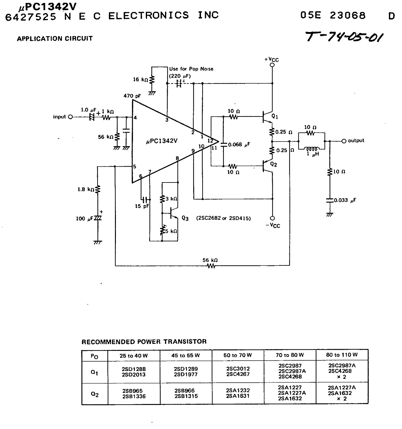

The upc requires additional output transistors to achieve any sort of power.

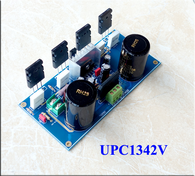

I'll try add a picture of the kit later if anyone can give me any idea of the performance of this chip compared to the prestigious 3886
You will need an external output pair to drive your speakers as the UPC is only a driver IC, not an output IC.
See attachment

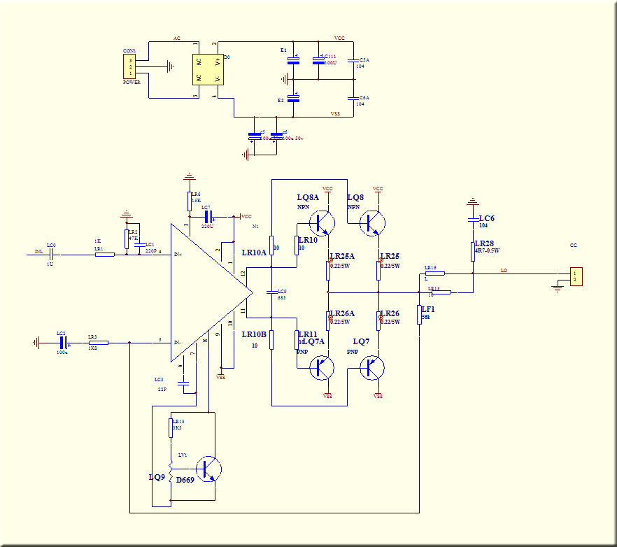

Just to clarify, I have a full kit, so I don't have any issues putting it together, in fact I'll add the diagram if anyone comes here in future looking for info.

I assume that it is the schematic from posting #6 you use?
First, a bit of work without the power connected.
You need to reduce the bias current to a minimum. You turn the bias current potentiometer such that you have a minimum of impedance between base and emitter of transistor D669.
You measure from each of the emitters of the four power transistors and to the output line with an Ohm-meter. You need close to 0.22 Ohm in all four cases. Most DMM cannot measure 0,22 Ohm precisely so first you short-circuit the measuring pins and read the value (we call it SC). Then, you remember that the reading when measuring from each emitter should be that value (SC) plus 0.22 Ohm.
Next, for all four power transistors you measure the impedance (with an Ohm-meter) base-emitter, emitter-collector and collector-base. Any reading below 1 KOhm may indicate a problem.
Ready to go?

It's the schematic from post 6 yeah, well that's what i got from the sale page.
Here's the PCB as I look at it, I just tried to do the first test you mentioned and realised the black multimeter probe is broken now! Its barely 3 months old too. I shacked together a substitute but I don't really trust to beyond continuity testing.
