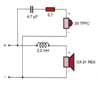

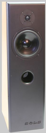

Here's the SEAS Njord kit, with 8" CA21REX bass and a fairly regular SEAS 25mm tweeter. A modern equivalent would be the SEAS CA22RNX.
... and a fairly regular SEAS 25mm tweeter.
There is nothing fairly regular about the 25TFFC tweeter.
A modern equivalent is very hard to find. Its early well
damped roll-off allows a single capacitor crossover.
rgds, sreten.

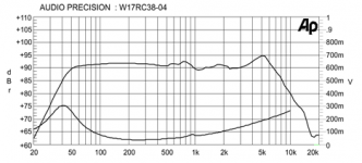

The FR plot of the woofer looks terrible, there's a huge peak and an awful mess after it just where you are suggesting to put the XO ?
Boys, the SEAS Njord is a rough and ready sort of speaker to my mind. I can do better, but I'm sticking to the theme here of an 8" paper bass on simple crossover. The CA21REX is quite a famous old high efficiency unit which found its way into a lot of speakers in various forms.

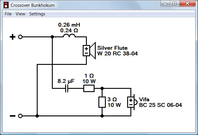

I looked up the Gemme Audio Tanto for interest. Uses the Vifa XT19 on a single small cap and a loud 4 ohm Silver Flute 6.5".

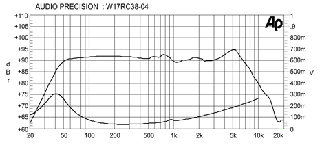

The 6.5" Silver Flute 4 ohm looks an unlikely candidate to run full range. That FR (and breakup) bump at 5kHz is bad news. See below.
You need a polycone with 6.5" if you are to have any hope of running it fullrange. TBH I don't see any difference between a bass with a simple inductor filter, or a bass with the inductance built into the voicecoil as Epos did.
Notice the review says the Tanto is suitable for acoustic music. Which is shorthand for saying it can't handle the complex stuff. What Lynn Olson calls a "Little Girl With A Guitar" speaker.

well.............
the tanto used the 8 ohm shielded.
Flattest of their 6.5", kind of wanders off after 1khz then peaks back up to average level at 5khz. I'm sure a waterfall would show a long trail there. But odougbo has had luck removing the dust cap and said it helps.
definitely not usable wide open nor even a 5khz crossover point.
but sitting on a slab floor, sealed 6.5" (F3 around 100hz) on a slab @5', crossed 24db to horn loaded dome, it passes the audiophile "girl and guitar tests" such as Jennifer Warnes "somewhere somebody" and Sarah McLachlan - Dirty Little Secret. Maybe could be a tad bit crispier I think due to the ferrofluid mucking thing up in the dome tweet.

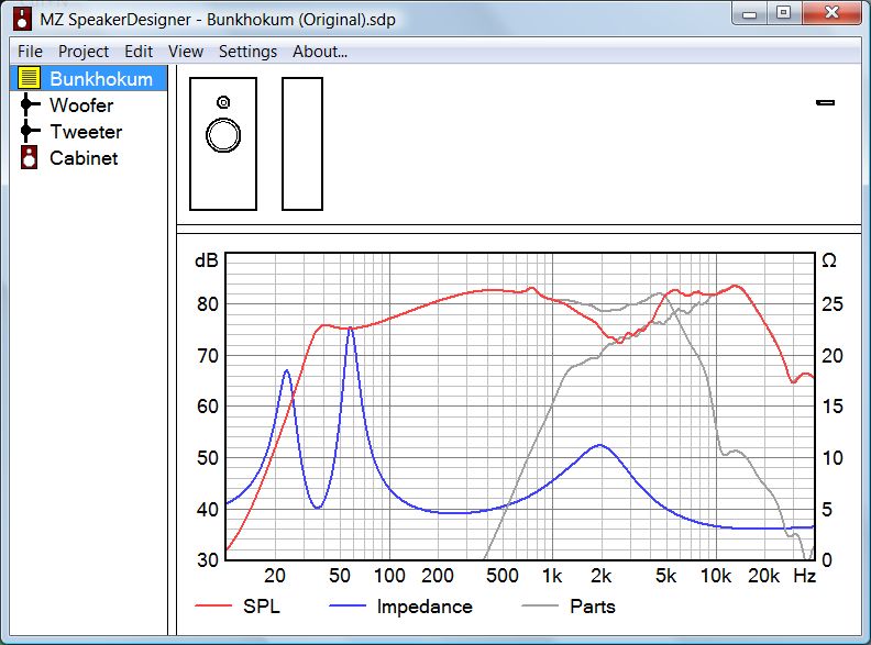

The 8 ohm Silver Flute does look a bit better. I was going by the stated review drivers.
This SEAS polycone (Le=0.25mH) looks quite good for a single, say, 0.6mH coil.
H1571-08 U18RNX/P
I have seen some designs done with that. But higher order tweeter. At least you could notch out the tweeter Fs resonance with a single cap. Works much better by all accounts.
I always think 6.5" bass is a difficult speaker to get sounding good.

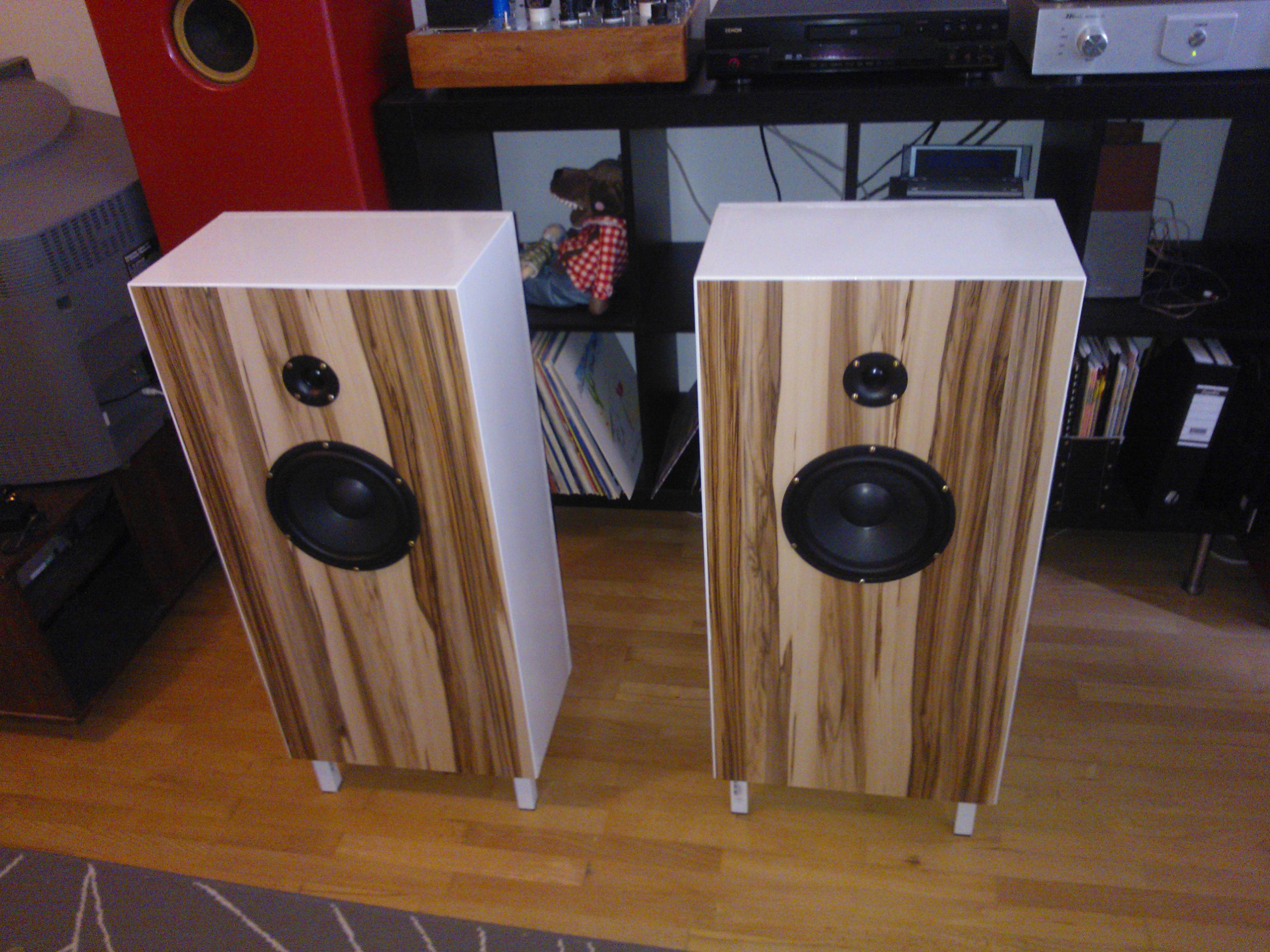

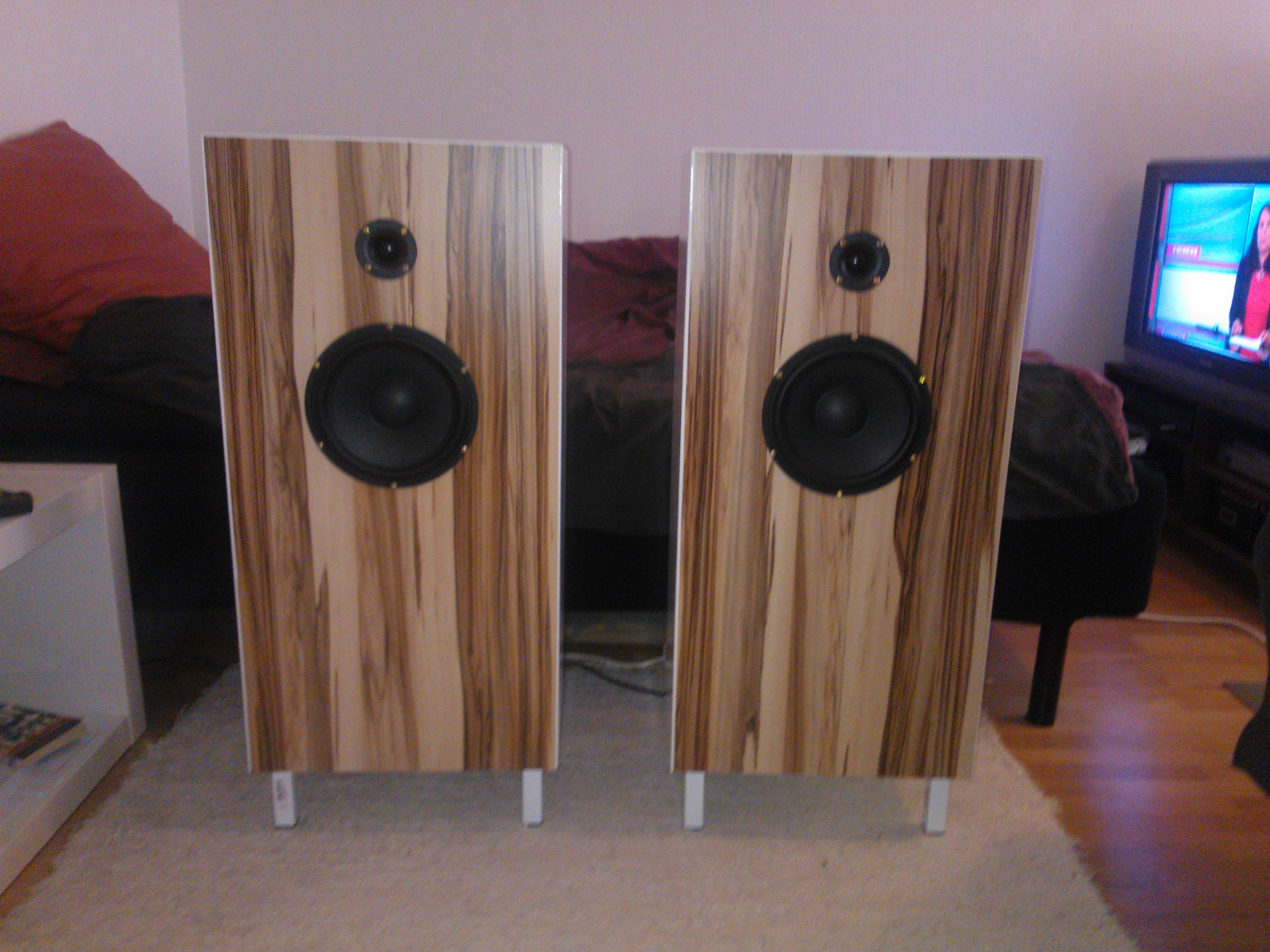

- orangutan lookalike...?
