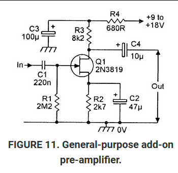

This is not a buffer (G=1V/V) but an amplifier (G~10V/V). May be overdriven when you strike the strings in strong way.One would think in a guitar - with zero DC to block - that would be the least of a problem. As in you could use a leaky cap in that spot, where within a tube amp, it coundnt function correctly, disrupting the bias of the stage that follows.

Besides this I am using real FET buffers for a long time.
The technical reason might well be the absence of the mid-range resonant peak - which may be shifted to much higher frequencies using a buffer. Depending on your personal taste you may add some dummy cap (100pF~1nF) parallel to the p.u. when using the buffer.I wonder what the technical reason would be for your observation? Obviously there's an inductor and capacitor involved and usually that means resonance or at least a filter of some sort. Or, could the buffer have limited the dynamic range somehow? My old Gibson EBO would put out peaks in volts when loaded to 1 Meg input on the digital sampling oscilloscope...

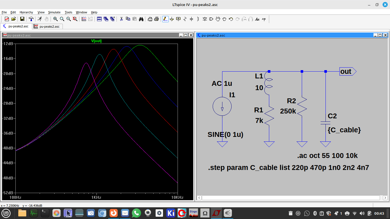

What's interesting about that is there's no "damping" resistor; no R in the RLC - save the coil winding resistance. It'd be interesting to see an empirical analysis of the pickup's FR for the different switch positions.I ended with a two pole six position rotary switch and six different capacitor values between 470 pF and 4.7 nF per PU instead of the stock tone control.
"What's interesting about that is there's no "damping" resistor; no R in the RLC - save the coil winding resistance."
In vintage designs you have the parallel res of the vol pot - often 250kOhms.
With L=7~10 H & Rcu =5~10kOhm you can simulate the resonant peaks depending on parallel caps.
.step param {c_name} list. Hopefully I'll remember that one day. Nice peaks!something like this
