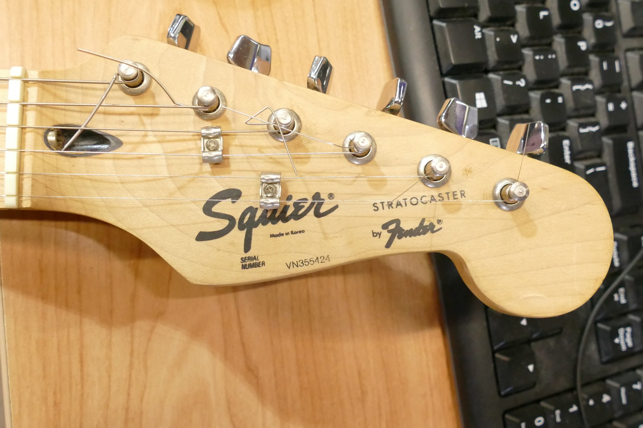

Squier is Fender's second tier brand. They have been made in various locations by several subcontractors over the years. The quality has varied from junk (the white Indonesian Strat that I had for about a year) to reasonably decent (this Korean Strat that I bought new sometime in the 80's). It did do a spontaneous unplanned random disassembly event many years ago that left a gash in my belly. For that it was sentenced to about 10 years in a box fully disassembled. See post #3629 here:
https://www.diyaudio.com/community/threads/what-did-you-last-repair.313739/page-182#post-7290844

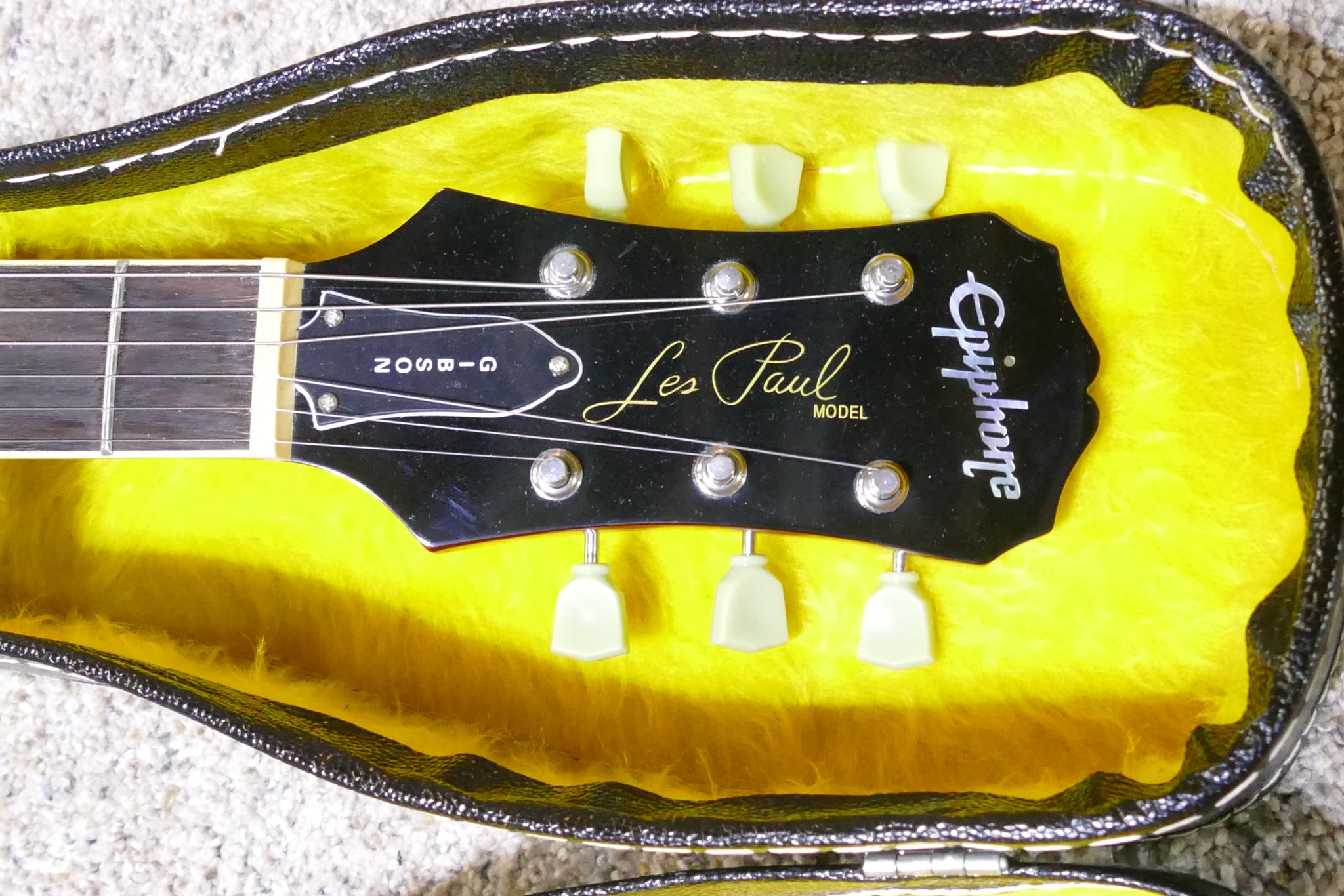

Epiphone is Gibson's second tier brand. They were bought by Gibson in the 90s maybe. They made some of the same guitars to the same specs as Gibson. My Les Paul wears both brand names. My wife bought me a guitar just like this one for my 50th birthday. It played fine through an amp but made a really annoying rattle when played without amplification. It rattled all the time you just didn't hear it when the amp was on. I resisted the temptation to rip it apart, so back to the music store we went. This one is its twin from the music store. It is a good, but heavy guitar. Most genuine Les Pauls are heavy due to the density of the Mahogany wood. Some cheap clones use cheap wood and are much lighter.

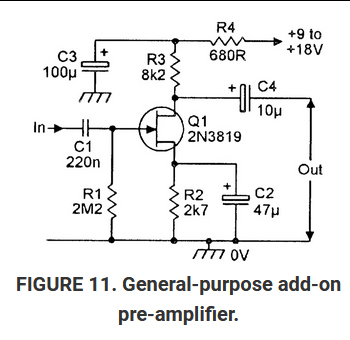

I'd replace a ceramic in a passive guitar tone control with a PIO or polyprop "just because" I happen to have them. But what you really want to do is put a buffer in, deal with the 9V battery placement, so as to unload the pickups from anything - that would make more of a difference than a cap type change. Perhaps something like -

I once had a similar buffer in my `78 Fender Jazz Bass. The outcome was a flat, boring, colourless sound. I think the cable capacitance is an essential contribution to a guitar's sound, so I'd not advocate that.
I wonder what the technical reason would be for your observation? Obviously there's an inductor and capacitor involved and usually that means resonance or at least a filter of some sort. Or, could the buffer have limited the dynamic range somehow? My old Gibson EBO would put out peaks in volts when loaded to 1 Meg input on the digital sampling oscilloscope...
