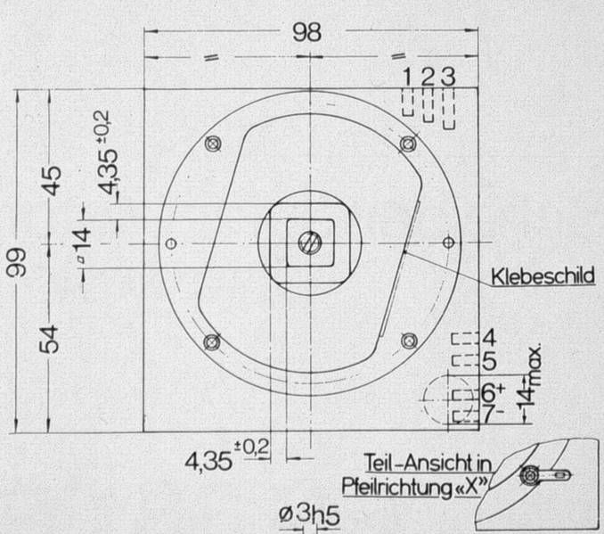

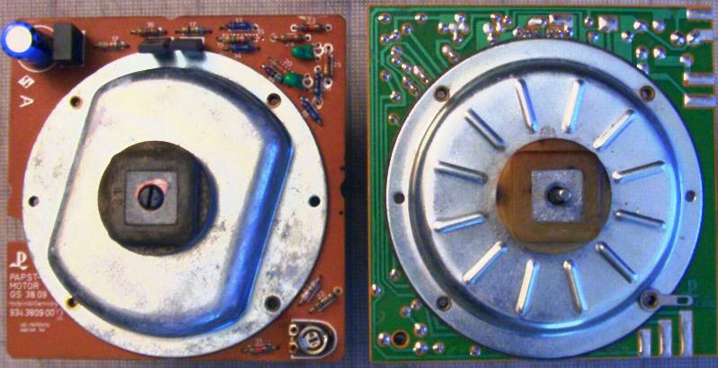

i do believe your Oracle Delphi has a Pabst GS3809 as motor.
Below you can see a top view and a bottom view of it; i have three samples of it, one used up, one in use and one unused/NOS. I used the used-up one and the unused one to take the photo.
This motor is fed with either DC 27V or AC 20V. It has three pins called 1 2 3 to connect the speed control fine adjustment for 33 and 45 rpm.
On the bottom of the pix, (component side, right lower corner, solder side / top view, left lower corner; both located at the center of the pix'es bottom edge)you see a varaible resistor on the PCB. This resistor is the coarse speed adjustment; if you toy around with it, you should be able to get the motor speed plus/minus adjustable with the two fine adjustments connected to 1 2 3. Se also posts below, ask if you have further QQ.
One remark, i have no idea how Oracle connected the motor; my info is from own experience with this thing and from the original Pabst data sheet.

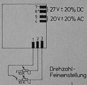

How variable resistors for speed control (fine) should be connected.
Power supply for DC, 24 to 27 Volt is pad6 (plus) and pad7 (minus) (why not a battery, the motor loves this and you'll love the sonics)
Power supply for AC. connect to pad4 and pad5.
Speed control: pad1 is common, pad2 is 33rpm and pad3 is 45rpm
