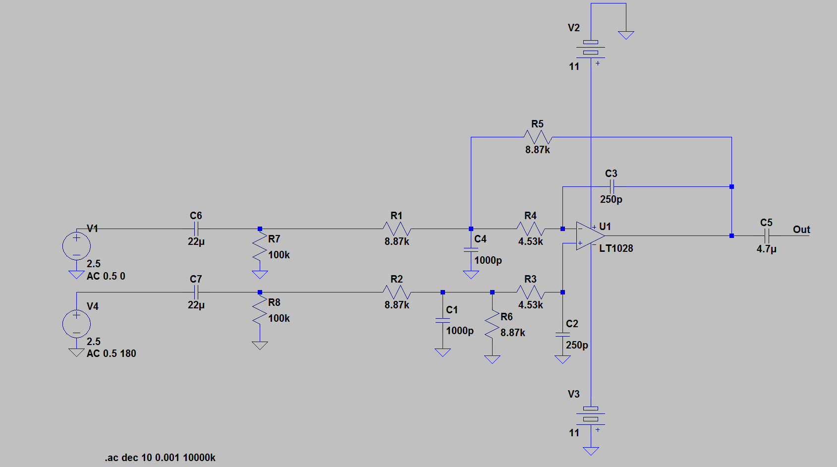

Hi all,
I have Opus DAC for with output filter based on simple schematic shown in attachment. The circuit was drawn in LTSpice, so it features LT1028, but in reality the Opamp is currently NE5534 - will be replaced with LME49710 or OPA134.
I was expecting that this setup will sound equal or better than old TDA1541, but it doesn't. It sounds a bit shallow and bright.
As improvement, I am considering some of the following:
1. Remove the 22uF capacitors on DAC output - this should be safe thing to do; even if + and - outputs from Wolfson do not have 100% same DC level, it shouldn't damage the filter; correct?
2. Increase the supply voltage from +/- 11V to +/- 15V and put Class A PS instead of Low Current Bipolar Supply; does this make any sense?
3. Remove the 4.7uF MKT from the output of the filter - again, even if there is an error on the Wolfson output, given the unity gain of the filter, there shouldn't be danger for the amplifier, right?
Thanks for help.
Boris

The resistor values are on the high side - noise will suffer.

Hi Russ,
Would you recommend to use those 22uF & 100k on Opus output with IVY?
Boris
No, they are not needed when using the IVY.
How about capacitor after IVY? Do you recommend one or it is not needed?
Boris
Not needed.
