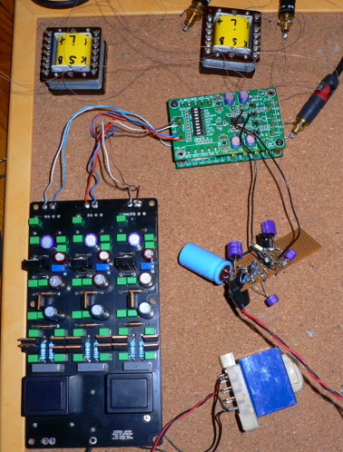

Hooked 'em up and they work. I only listened for a couple of minutes, but it sounds good! The guy I bought the trafos from sent a little PCB that had resistors and caps. I added a resistor across the output jack. So, the transformer should be seeing 600 ohms at each end.
Should I be using the G connection somehow from the DAC board? I know I could could connect it to the "center" tap of the primary (have a two primaries wired in series), but is there any reason to? Should I be worried about DC? I'm not using output caps on the OPUS, nor do I want to. In Jensen's most relevant app note, they use a pot to balance it. I'm not in favor of excessive complexity, but I don't want to magnetize the transformer cores either.

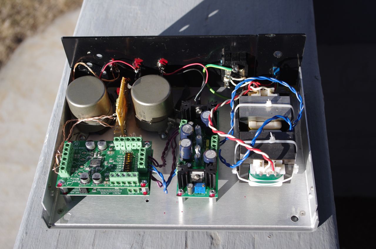

I hooked the G to the center taps and put it back together. Definitely a less "romantic" sound than running it SE through oil filled caps! The output level difference is less pronounced than I expected (based on the position of my volume knob, I didn't measure it). It does sound cleaner and faster, better defined. Probably a worthwhile upgrade for me. Others might be happier with the caps (which, FTR, were some little old motor runs).
