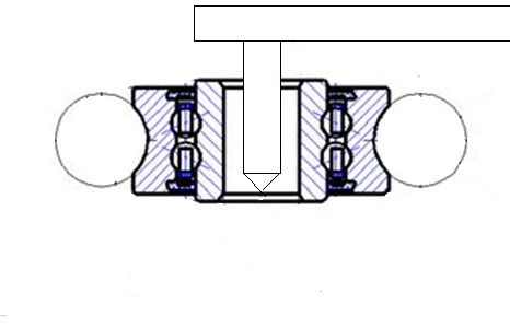

Here's another thought in my head. If I use two round rods in parallel on the horizontal plane, I can use two U-groove bearings gliding laterally without any vertical movement. And then I can place a dual-pivot housing with two spikes and an armwand.
I may misunderstand your intent, but it looks like the bearing would roll on one rod and slide on other.
Sheldon
If I place the spikes below the mid-point plane of the rods, then the mass is hung.
I can't visualize the teflon solution yet perhaps you can draw up something for me? Thank you and always appreciate the suggestions.

Sheldon: "I may misunderstand your intent, but it looks like the bearing would roll on one rod and slide on other."
You are right! Obviously my idea was not well thought out. D'oh! Thanks for the correction. The only way to make it roll smoothly without vertical movement is to have three bearings to create a triangle carriage for the vertical bearing. But by that point, it might get too complicated and very much simulated the Souther approach. Duh! 🙁
Back to the drawing board again!

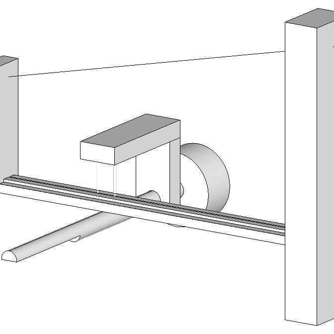

I disassembled a Nottingham unipivot arm once and saw the inner working of its design. Inside the bearing housing, there are two metal rods, below the single pivot point, that park on a ball bearing that allows the arm to move horizontally and vertically but inhibit azimuth movement. There are many hybrid unipivot arms out there that use a ball bearing to stabilize the azimuth, like the Basis Vector, Continuum Copperhead, Graham Phantom, etc.. but they all have only two contact points, whereas the Nottingham has three.
The one arm that is closest in design concept is the clever Simon Yorke tonearm (Now, there's a designer whom I really admire!) that uses no ball bearing at all but uses a teflon sleeve with a guiding plate. Check picture of the tonearm from the S-9 model record player. I think the SY design is much simpler and more elegant. I also like his Bauhaus styling. Sorry to be off topic again. My mind is always at tangents. 🙂
Maybe something like this, by having the two rods touching each other to avoid alignment problem or simply replace the two rods with one flat piece.
I follow your thinking.
Toying with the idea of a parallel tonearm,what about using your two bearings ,running on a triangular rod. Hanging from the bearing carrier ,making a T , two additional bearings on the vertical rod,with the armwand between them,like in radial tonearms? The main weight,will be below main bearings,and the arm will follow the ups and downs of warped discs.
