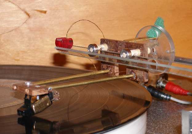

Ball Point Tube
Hi Doug,
What you been up to all week? I found a couple of dead ball point tubes. They are reasonably thin wall but made of brass. Shouldn't make too much difference. Cleaning out all the old ink is the worst part of the job. Acetone does a good job. You do need an eye dropper and an adapter so you can flush the tubes or some sort of syringe. Then I forced out the crimp they put in the tubes to hold the spring in position. Last was to find a bunch of scrap to build up a test carriage. Pretty much copied the Cantus design with some changes for convenience. What can I say, it works. Used a lot of care to eliminate drag in the bearings. If they are too tight fitting on their mounts, thy will not roll freely. The attached pic shows the junk yard special in all its glory. Used the bearings with the ceramic balls. Put it all together in a few hours. Tested it first with an old Shure cartridge. My care paid off or so I thought because all my groove skipping was gone. I didn't like the sound of that cartridge, but nothing new here. Carriage worked well. Then I put the Audio Technica Signet. Back came the great sound and the groove skips. Taking a clue from the Shure I wondered if it could be the stylus on the AT giving grief. Found 2 old Empire carts and one bent cantilever with what looked like a nice diamond in the junk from a yard sale. A little care and the bend went away. Mounted the first one. It was much better than the AT but I didn't like the sound. Tried the second one, a model 2000 E-3. BINGO. Sound was as good if not better than the Signet. The skipping problems were gone too. I'm delighted so far. It sure would be nice to know what is going on here. Now to do up a nice one.

Well done, Bill.
Looking at your image, I wondered what would happen if you replaced the two bearings with a long hollow water-tight float, and filled the V-shaped with a liquid of ideal viscosity. Could you make a floating carriage with in-built damping?
Fantasies aside, you're making this project increasingly difficult to ignore.
Terry

Terry: what makes the Cantus such a good arm is the restricted amount of motion it allows, sideways along the track and very little vertical. This means that more of the energy generated by the motion of the cantilever/coils can be turned into electrical energy. This is how Bo explained it to me. So you can see that a floating arm will have many issues. I expect that this is also why a good mechanical system should sound better than an air bearing. Best regards Moray James.

Moray, Thanks and sure. I would question whether the difference would truly be significant enough to notice and whether or not the difference would be discernible if the two tubes wide spaced were coated with super glue. They would have to be for any valid conclusions to be made. Find me some tubes to use. The brass pen refills cost a bit much and are far too messy to clean out for me to want to clean more of them.

Let me see what I can find. Not sure if I follow what you said so perhaps I was unclear. I meant that the two tubes would be side by side touching with a thin line of instant glue to bond them together as one piece so the will be stiffer and will damp each other. I will get back to you with my findings probably early next week. I have a bunch of work to do and I am tied up with that for the moment. You could simply leave the ink in the tubes and seal off the open ends with something yes a little more weight but the ink will damp the tube. Just a thought. Best regards Moray James.
PS can you show a picture of your counter weight on this latest version?

I wonder if that is really the case? I would have thought that, given the tiny mass and high compliance of the stylus+moving parts, the relatively large mass and moment of the cartridge+arm+counterweight would provide more than enough inertia to keep the cartridge body effectively still at audio frequencies. I guess it wouldn't be impossible to test that.
But I concede that my "floating boat" concept might run into a lot of snags!

I wonder though if the triangulation provided by the two tubes being separated and having a wide "wheelbase" is important to provide great stiffness in the horizontal plane? Any tendency to flex in the horizontal plane might promote tracking issues?
I don't suppose we have a detailed technical drawing anywhere of one of these arms?
There appears to be an alarming amount of unshielded audio wiring at the tail end of the arm in these arrangements. Do these arms assume the use of a balanced input pre-amp to cancel hum pickup, or do serious aficionados run their homes on filtered and regulated 12V DC?

Moray, The fancy counterweight is a scrap off the bench. It started life as the disk element which supports the arm and is immersed in silicone fluid in a WellTempered arm. It is Perspex about 1/4" thick and just happened to balance the cartridge, so I used it as is. Re leaving the ink in the tube for damping: UGGGHHHH, messy bessey, but it would work.
Terry, Needing nice flexible wire and wanting to use what was on hand I use approximately #32-34 enameled magnet wire. I make two twisted pairs of a not too tight a pitch. Twist one pair CW and the other ACW. Then I twist them together even looser. Strangely enough by paying close attention to ground loops and keeping them away from stray AC fields the hum pickup is pretty near nothing even at full amp gain. That's the story there, single ended all the way.

Moray,
Yes I followed you on the two tubes glued together. For my first go with thin tubes I wanted to stay with Bo's design for starters. See #472 for more details.

Regarding the stiffness issue, I think we are missing something. Since the back end of the armwand terminates in very free rolling bearings any force in the horizontal direction simply causes the carriage to move sideways instantly relieving the force. As long as the arm is stiff enough that it can support its own weight all is golden.
New subject: Being sick of trying to guess and set the VTF I hit on this idea last night. Set the counterweight so the stylus just grazes the record. Let it just hit the top of a small warp. Do this with the record playing. Jiiggle the headshell a bit to be sure the bearings are centered in their races. Now place a bit of plumbers wire solder previously cut to the weight you want for VTF on top of the head shell. The stylus tip drops into the groove and you can observe the amount of vertical deflection of the cantilever. I set the VTF easily at 1.75 grams and using a little used record it played straight through with no problems. Got to do some checks and maybe choose different VTF to accommodate some of my cherished but worn older disks. At this point it was time for sleep. A small light weight bin built into the top of the head shell to take solder or lead shot should clean up this one major (imho) problem with the CANTUS design. What's your take on this one plz.? I still want to follow up on the free vertical pivot idea sometime but the pressure is off.
