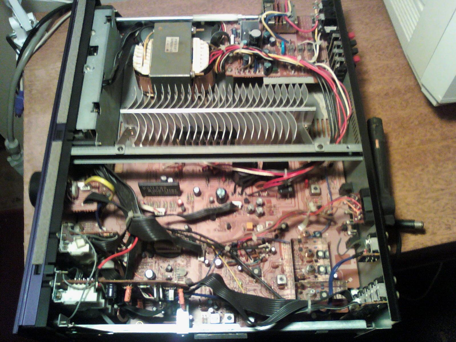

Added pictures.
I hope these pictures will help someone to help me.

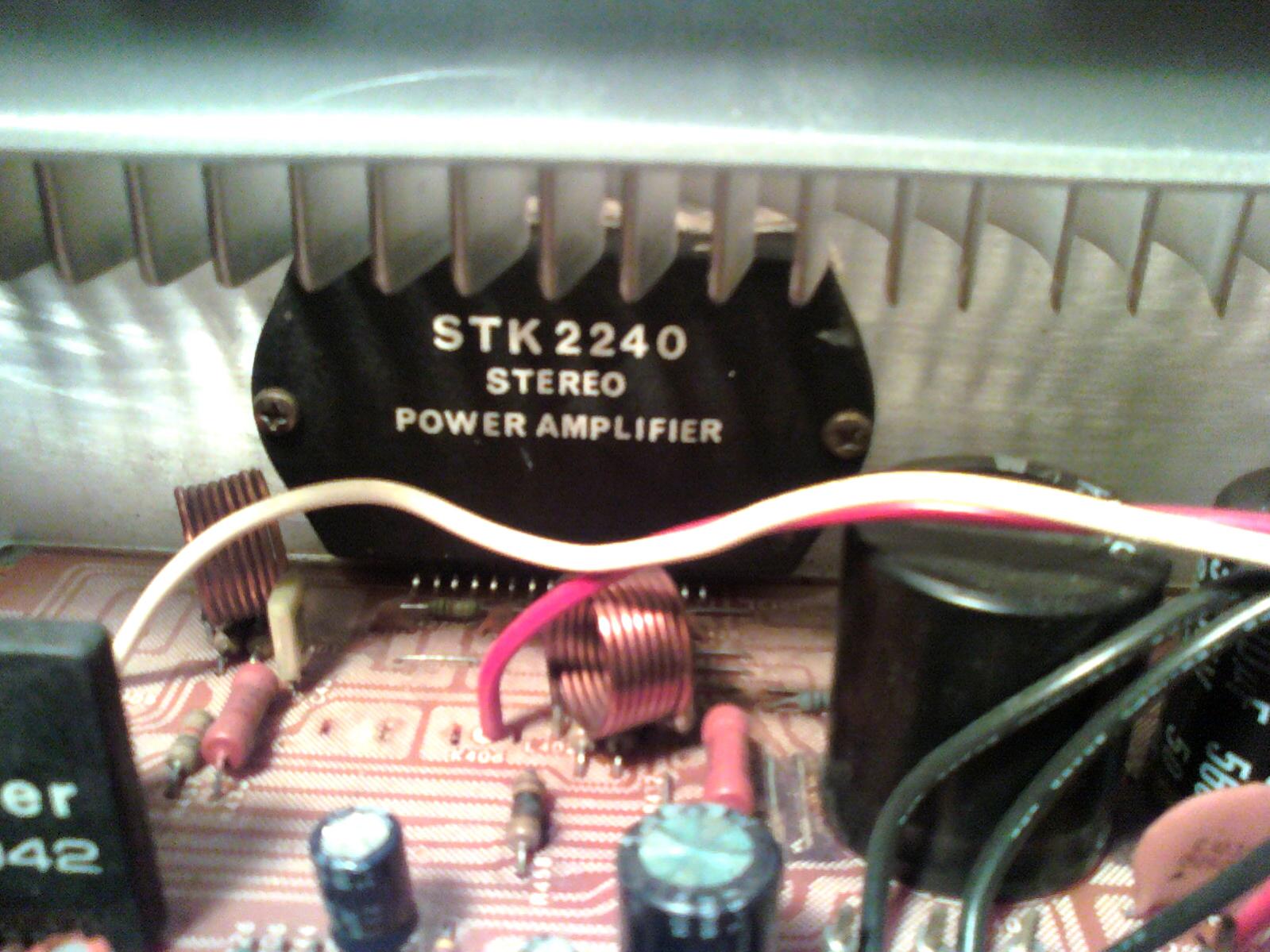

Jaycee the part number for the module on the heat sink is ( STK 2240 ) it is a Stereo Power Amplifier.

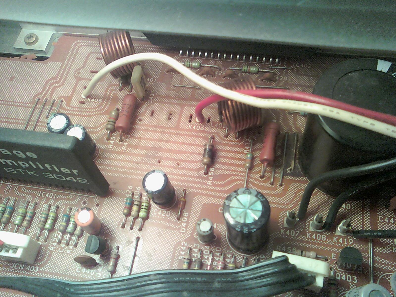

Mooly I can not tell if it goes to the STK 2240 or not, it doesn't look like it to me.
So I have taken two more pictures to see if that might help.

I meant the STK3042 actually as the print runs over in that direction ? If you can't visually trace the print just measure on low ohms (or diode check) from the "R458 marked end" and read down all the pins on the STK one at a time and see if it read short to any pin.

R458 is a 1K 1/2W carbon film resistor, same as R457 in the other channel.
