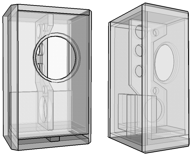

I had a Fritz Carbon 7 speaker that I liked that used Scanspeak drivers and was a similar size, so this kit seemed like a good place to start and is in the price range I want. Problem is, the plans call for a 1" MDF front baffle and the largest options I have near me are 3/4" MDF and 3/4" Baltic Birch.
My thoughts:
1. Build out of 3/4" MDF and hope for the best.
2. Use 3/4" Baltic birch for the whole cabinet or just the front baffle.
3. Build from MDF, and glue two 3/4" or 1/2" panels together to create a 1" front baffle.
I have zero experience building a speaker cabinet and would appreciate any ideas for the front baffle. Thank you!

Baltic birch. A better option than MDF anyway. I'd double up the 3/4 pieces for the front baffle. Be sure to champfer the inside edge of the woofer hole with either a 3/4" champfering or roundover bit.
You could do that with Baltic Birch as well, if you need the extra thickness for the woofer rebate.glue two 3/4" or 1/2" panels together to create a 1" front baffle.

The plan details are rather sketchy. the cabinet is only 9 inches wide and the speaker hole only leaves a little over an inch on each side of it.
From an engineering standpoint, there isn't going to be much resonance in a 9 inch wide piece of any thickness of plywood. How are you planning to attach the baffle to the sides of the box? Usually, the baffle is slightly recessed into the box. In this case, if the box is made out of normal 3/4 inch plywood, the speaker is right up against the box sides. Once you cut the hole, there is not much left of the baffle. MDF is dense and its heavy, but not very strong. It may crack in two near the edges of the speaker. I would recommend 1/2 inch plywood for the baffle and place a 3/4"x3" solid wood brace on edge running side to side between the woofer and tweeter. You may also want to think about increasing the width an extra inch or two to accommodate installing the baffle and rear of the box.
The drawing implies the baffle is inset flush with the sides, hence the 1" due to basically cutting it away to fit the driver and as I proved, 3/4" BB or marine grade is plenty sufficient WRT rigidity even completely cut away to the sides.

I'd leave the baffle 0.75" and add a brace or two.

Dont see bracing in that plan.
Most of the resonance issues are solved with bracing.
Baffle is on the small size, most the issues is larger side panels.
Stiffness is a different conversation if this was a huge enclosure for live sound drivers.
Even then more important, bracing would be a big part of that as well.
Either way one vertical brace I would see used for the large sides.
Very expensive wood goes so far, eventually they all need bracing.

Where is the bracing in that box?

Dave, based on the plan, there is no bracing 🙂 It would probably solve this issue, but since this is a first kit for me, I was not sure.

It needs at least one brace, vertical, from baffle to back (and top/bottom). Use it to brace the driver against the back.Make the brace about a third holes, add 2/3rds the panel material to the width.

I am inspired to focus on bracing.... a properly braced box can be made out of a plethora of materials, in just about any thickness.
