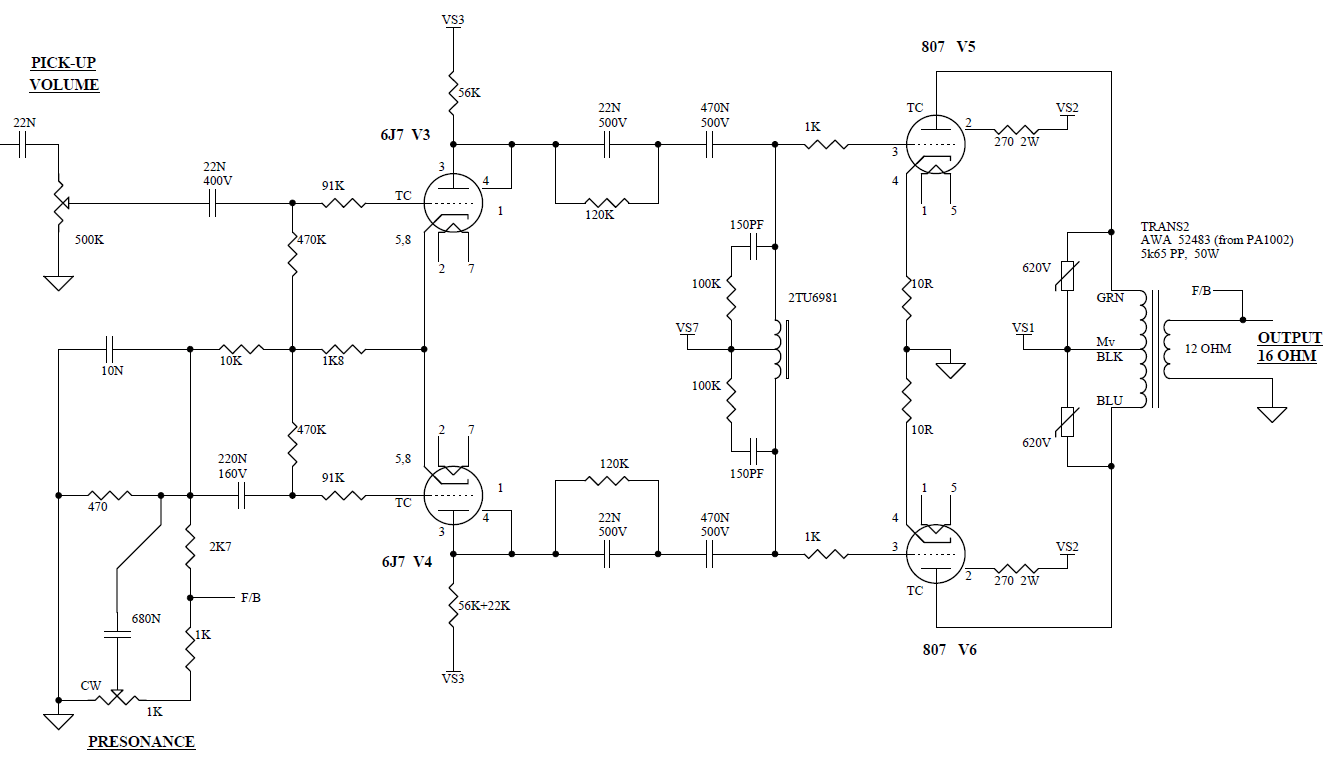

This relates to the renovation of a vintage 1940/50's PA amp with an 807 PP fixed bias output stage that included a rarely seen PP grid choke. The original amp didn't include feedback but I am aiming for a 'presonance' control that will need some frequency management of feedback to ensure stability, even though feedback level is circa 6dB max.
A draft schematic of the modified PI and output stages is shown below. The 2TU6981 PP grid choke provides a high impedance load to the PI stage without having to use relatively low valued grid leak resistors (ie. 100k). Each choke half has a high primary inductance of circa 600H at 40Hz, but also a 16kHz resonance from a circa 200pF winding shunt capacitance and a few hundred mH leakage inductance, followed by another resonance at 30kHz, as indicated by the impedance plot shown below. The choke inductance needed some modified PI stage output coupling cap management at the low frequency end otherwise it causes an LC related response peak with the PI stage output coupling cap at what was a noticeable 40-50Hz.
The renovation is nearly complete and the amp happily provides 40W clean in to a resistive load, and about 70W cranked. So now to the application of feedback for the presonance effect. The OPT is nicely interleaved so I am not expecting significant resonance effects from that aspect, and can include some HF phase compensation (across feedback resistor and using some series output inductance) if needed for such a low level of feedback. I need to add in a dominant open-loop HF filter which will be a capacitor across the PI stage anodes, but will get to that once I have the grid choke under control.

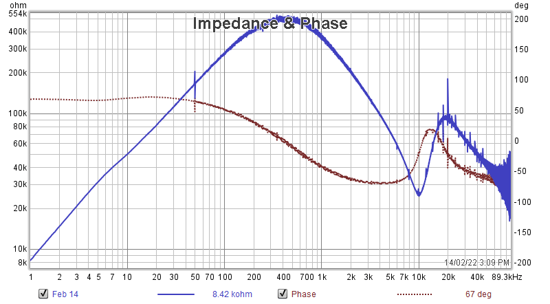

So back to the grid choke and how to tame its behaviour. I've just confirmed that there is a dominant 16kHz ringing on a low frequency squarewave signal through the amp. My initial guess is to shunt each choke half-winding with an RC to apply something like a 100kohm dampening above 10-15kHz, as that seems the simplest way forward. Happy to hear of any other options to try and mollify the resonance effects of this grid choke (apart from ditching it 🙄). I should get to this on the bench in the next few days to see how much influence the RC can be, and how much HF roll-off I need for feedback stability.

Gotta ask, how married are you to this scheme? Are modern schemes with feedback taken from the OPT primaries, etc. open for consideration? Otherwise, the classic long-loop feedback schemes are a hard slog if the complications of the high intrinsic output (source) impedance to an actual real-world complex load are included.
Of course you know all this. You're possibly trying to raise the quality of discourse, and it's greatly appreciated.

AWA has such a magical pre-war Radiotron ring to it. Wish I could help, but you're into four poles (minimum) and a critical load dependence. My only possible thoughts are to try to make things into manageable single poles (brute force, of course), which isn't helpful. Zobels?

A local Fdbk approach would seem the simplest brute force approach.
But if you want to tangle with the xfmr "demons" inside, you could try positive current Fdbks from the output tubes cathodes ( low value current sense resistors with an attenuator) back to the driver cathodes WITH some series resonant LC traps in line with them. (same freq. as xfmr resonance). Fdbk levels adjusted to give enough boost to flatten the original resonance. The phase of the pos. Fdbks would then adjust in phase automatically on either side of the xfmr resonance. One could tailor the comps. width with a high value resistor across the traps, but too low an R here would begin to remove OT primary R as well (neg. resistance effect), likely making resonance matters worse (sharper resonance).
For initial measurement simplicity I'll re-do the choke half-winding impedance plot but with a shunt RC on each half. and do some forward path gain frequency plots without feedback (with and without shunt RC, and with and without a PI output shunt C) to get a better view of the likely level of feedback that could be applied before encroaching on instability conditions due to the presonance control. That should keep me busy for awhile.
My building partner, iain42, is tackling something similar currently. He'd built a pair of replica Brooks (model 10s ?) using custom wound supposed replica chokes and OPTs, and had plenty of stability issues. Disappointed, he's gutted them for a new attempt, reusing the existing iron, power supplies, valves (mostly), etc. But he has the luxury of an extra gain stage. Would an extra stage fall within your game rules?
We're going to have a differential input stage of 6SL7 RC coupled to push-pull 6SN7 cathode followers with the choke in the 6SN7's cathodes to ground, and some small resistance to bring the total R up to 1K Ohm to bias the 6SN7s. Grids of the 2A3 output valves are then direct coupled to the 6SN7 cathodes; individual output valve cathode bias resistors and bypass caps, etc. This scheme is to keep the choke at as low as possible a circuit impedance (brute force), but also a low DC resistance to ground for the ancient 2A3s' grid current. It does require one more gain stage than you currently have.....

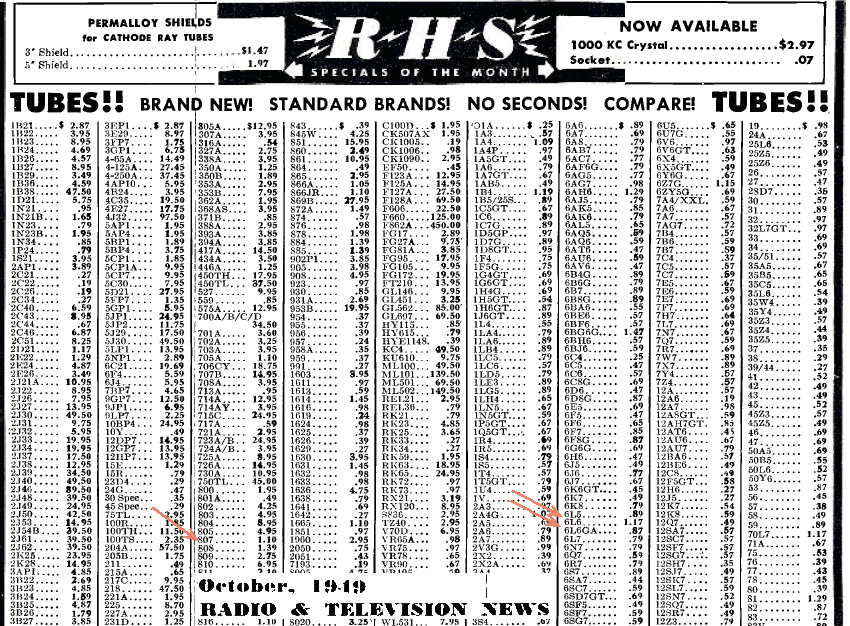

807's were just so cheap and plentiful after WW2
They musta got a Special Deal. Maybe the currents of war left an eddy of 807 downunder. I have my finger in 1949 just now and prices are real darn similar. More variation between dealers than between type numbers.
I would put <50k across each half of the winding, to spoil the Q. To avoid loading the midband maybe 200pFd in series.
I'm pretty sure AWA was very linked to many Aussie defence contracts, so plausible that they had quite a stock of 807's to call on. Our local RTV&H magazine isn't too flush with valve price comparisons - in 1947 the 807 was 16/6, and a 1954 advert had 807 at 20 to 25/- (shilling) but sadly no 6L6 price comparisons.
I just tried 100k+82pF and 100k+150pF as shunt RC's across each half of the grid choke. The R certainly dampens the original 30kHz resonance and has some effect on the original 16kHz, with the resonance frequencies lowered from the added C. An RC is certainly easy to add/tweak so for now I'll turn to looking at the open loop response of the PI and output stage (I'll bypass the two preamp stages to simplify interpreting the responses).

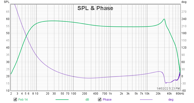

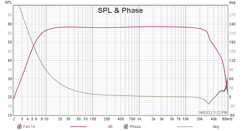

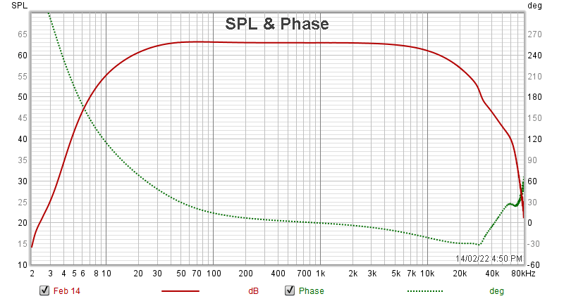

Quick progress. With no feedback, the frequency response of the PI and output stage at 1W is shown in the attached "1G7053 16ohm 1W spectrum PI input baseline.png".
The other three plots are with the presonance circuitry fitted and a nominal 6dB of feedback (updated schematic - plots indicate circa 5dB but I nudged a pot). The presonance pot provides about 5dB treble boost in full CW position, and about 5dB of treble cut in CCW position. The 30kHz resonance of the grid choke shows through when treble is suppressed by more feedback in CCW position. That 30kHz resonance is mollified by 2dB when the 100k/82pF RC networks are added, but the resonance is not overtly significant.
I'm thinking my initial testing that showed up a strong 16kHz resonance had a bad connection somewhere - doh. Anyway I still need to check for stability across a broad range of loads to see if that resonance flares up, and check if the treble/cut frequency corner is ok.
Price for New, just manufactured tubes must have been similar, basically same guts and materials so same or close production price.
BUT there was A TON of surplus military tubes around, bought by lot at Government Auction for peanuts , then resold.

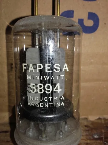

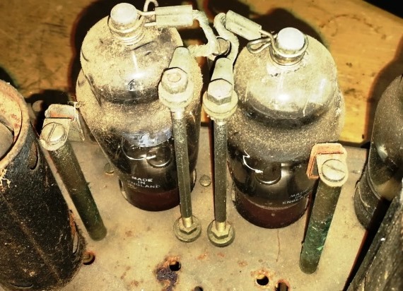

When I started making amps in 1969, 6L6 were hard to find in Argentina and VERY expensive, besides we are an "European" Country, not a US type, so 6L6 was almost unused, 6V6 completely unknown , popular tubes were EL34 and EL84, of which we even had a local Factory (Philips=FAPESA) so no big deal.
While I could buy NIB 807, military surplus, for a very low price.
A Fapesa-Philips-Miniwatt tube, locally made:
