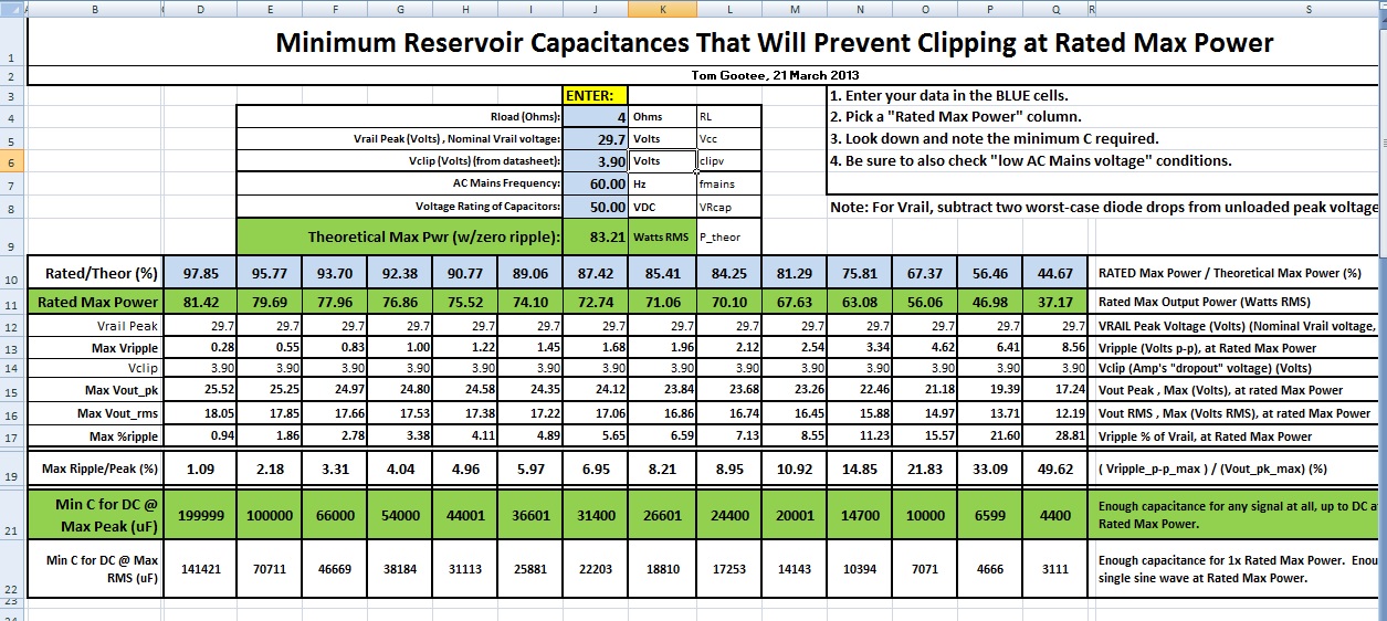

I saw 20,000uf was recommended earlier in the thread for each rail. With about 10,000uf on my filter caps, the music keeps playing for a second or 2 after power is cut until the caps drain. It surely would not take a full second to recharge the caps to necessitate such high capacitance?
Once the rail voltages, speaker impedance, mains frequency, and the type of amplifier circuit are decided upon, he total capacitance per rail determines the rated max output power.
With more capacitance, the amp can play louder before it runs into the onset of clipping.
Also, with more capacitance there is a lower ripple voltage amplitude, which improves the sound quality, with how much improvement being dependent on the PSR (power supply rejection) characteristics of the amp.
If you have Excel, download the spreadsheet from the post at:
http://www.diyaudio.com/forums/power-supplies/240955-resevoir-capacitors-chip-amps.html#post3599692
If not, the formula is also posted there. Or, post your DC rail voltage and speaker impedance rating and I can post a snapshot of the results. The spreadsheet shows a range of capacitance values and the rated max output power for each one.
Attached is an example. In that example, boosting the capacitance from 10000 to 20000 per rail increases the rated max power from 56 Watts to 67.6 Watts, and going to 44000 uF would give you 75.5 Watts.
