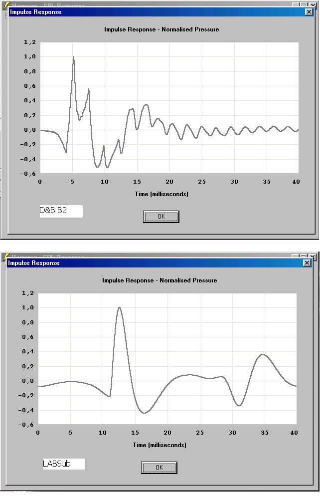

Hornresps new impulseresponse calculations has really opened up a new field in the discussion about "fast" vs "slow".

auplater said:
BINGO!!
All the talk about uncontrolled resonances, etc... is mindless w/o mentioning the room and location of the sub(s)... since most any room has all sorts of resonances and reflections impacting the reproduction. In fact, the room resonance profile defines the bass reproduction, the speakers only provide the drive for these modes.
In most instances, the room dominates the reproduction quality below say 100 hz, so fast and slow applied to the drivers doesn't seem to apply much. So deal with the room modes (through placement, multiple sources, etc.) and bass quality will be dramatically enhanced. Chasing driver characteristics pretty much misses the point, imo

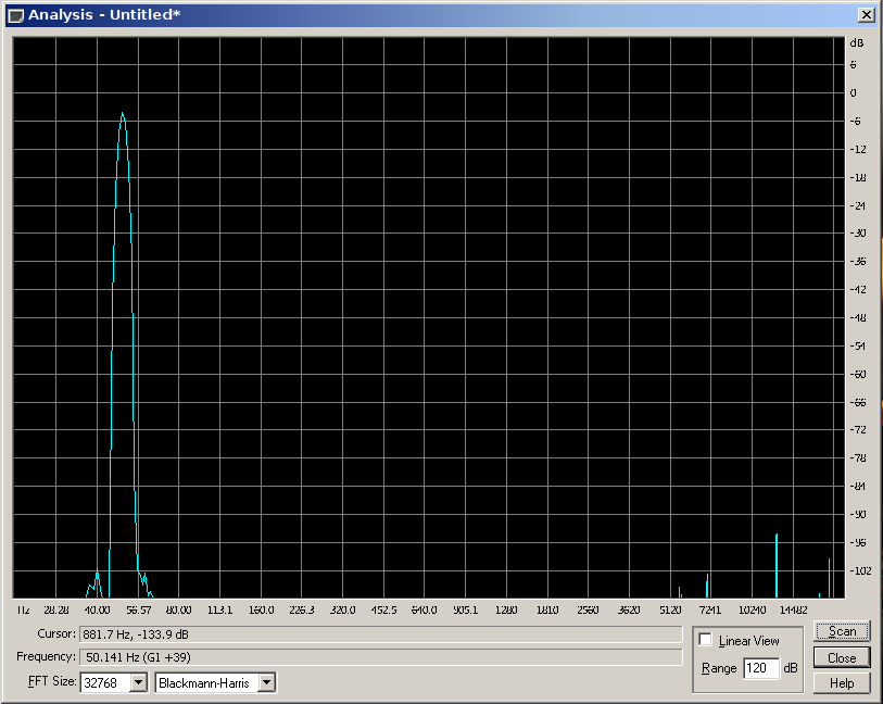

planet10 said:
Fast is just a bad term to use. Simply, a fast woofer has good hi-frequency response. Put a low pass filter on it, and it is no longer fast.
That's right. Have a look at this. First pic is a spectral response of a continuous 40Hz sinewave. No big deal. Second pic is for 1 second silence, 1 second 40Hz, 1 second silence. The 40Hz starts and stops on the zero crossing. Notice the tone burst has a lot more high frequency content even though it is still nominally a 40Hz sinewave. A "fast" woofer going doof-doof-doof needs more high frequency response to sound "fast"

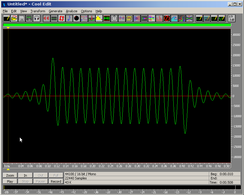

This what happens to a 50Hz tone burst when you put it through a 52Hz low pass filter e.g. port. Your fast woofer gets kinda slow.
Images created with CoolEdit 96 running on wine on Ubuntu. That's why the fonts are a bit scratchy.
