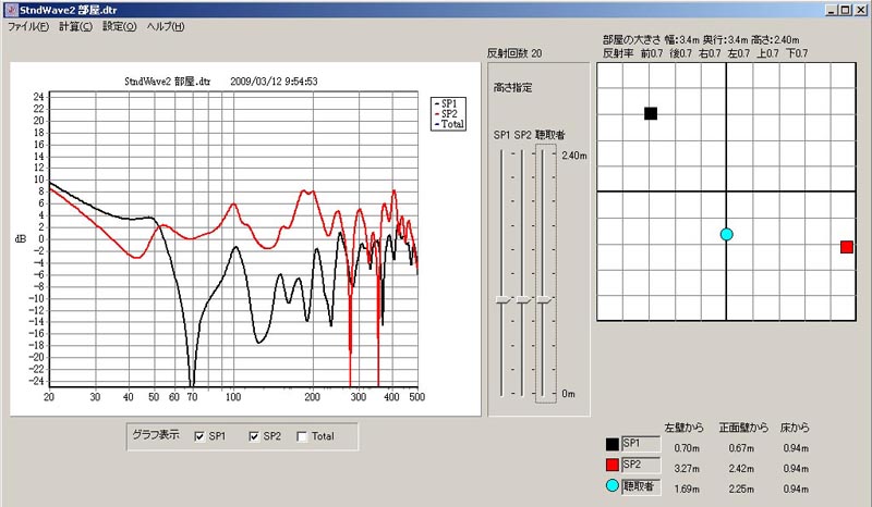

I'm a recent new member of this forum.
I hope this kind of information could be useful for you;
Recently I have studied a subwoofer integration to my desktop audio system.
The target was to create earphones-like very tight and clear super bass (down to 30 Hz flat).
Although the circumstances maybe much different from your listening style, I believe the basic theories could be applicable also to you.
I�fve found bellows are very important besides the unit design;
1) Standing wave effect (sound reflections from walls) in the room should be reduced.
For that:
- Find the best position of the subwoofer anywhere in the room
- or install it very near from you (delay control necessary)
(see attached figure)
2) Equalize the output and phase delay accurately based on measurements at the actual listening position.
3) Digital signal processing is quite useful for the adjustments
4) Relatively small sealed enclosures for the main speakers (maybe 2 �c 3 L for Alpair 6)
5) A sealed enclosure could be better also for the subwoofer (or duct stuffing)
For details, please see my own Blog
http://lean-audio.blogspot.com/
