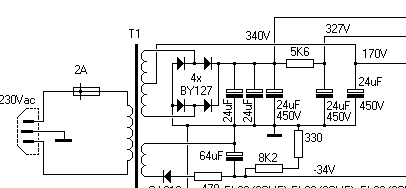

The typical power supply circuit I think you are referring to is below, as was used by Philips back in the 1960's. The screen supply feed uses the CT and the two bridge diodes connected to 0V. That screen supply could use a CLC filter, with the L being a low current rating and hence add a few volts DCR drop, as well as significant ripple reduction.
I reckon a choke could even be inserted in the CT feed to make a choke input filter for the screen and hence provide a significantly lower screen/preamp voltage assuming the choke was large enough to maintain continuous conduction. I can see that continuous choke conduction would force one of those two bridge diodes to always be on, but that should cover the time when the other two bridge diodes provide commutation charging for the plate supply cap-input filter. But there could be some quirks in operation, such as if choke current were to reach zero, but maybe an extra steering diode in the choke feed could prevent any quirky reverse current situation.

Yes, this excerpt is the PSU of a Philips EL6425 and the like and exactly what I'm intending (besides the capacitance values). So I could place a single choke either between CT and the capacitor to regulate the screen voltage (does this work at all?) or between the bridge's negative terminal and gnd to regulate both voltages?

I'm less sure of operation with a choke in the negative arm of the bridge rectifier to the filter cap negs. With all diodes alternately conducting, the screen supply cap is charging through the same duration as the anode supply cap. However the voltage waveform across the choke would not be the same compared to the typical situation where the screen supply and the anode supply were being charged through their own separate chokes. An LTSpice sim may be enlightening, and then a test circuit with variac.
