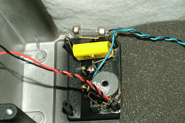

Optimus Pro Lx5ii replacement crossover. Is there a direct replacement I can just buy to replace it with better components

Welcome to the forum!
You are showing the crossover for the Linaeum tweeter.
It is a very simple crossover circuit with a good quality film capacitor and a ferrite cored inductor, along with a lamp to protect the tweeter from overload.
EDIT: I presume you are considering building this crossover from components rather than buying it at auction?
I've attached the crossover schematic (minus the tweeter protection lamp, which would be connected between the capacitor and the tweeter).
The crossover frequency is around 2 kHz.
Is this helpful?
