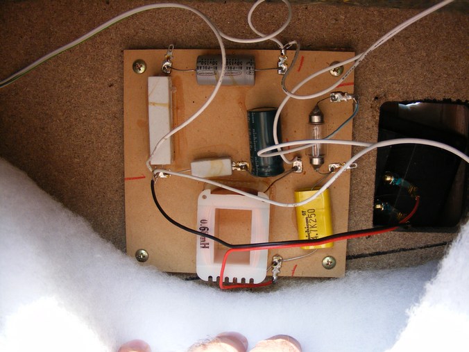

I cracked one of the speakers open to check said fuse only to find that it is intact! Ok, lets check for leaky caps... nothing - it all looks good. What could be the problem here?
Do these tweeters go bad? I don't really understand how; I mean, they are a ribbon, magnets, and wiring - what component could fail?
Here is a picture of the circuit board. I have a digital multimeter, how can I test this circuit to check which component (if any) is defective?

those dipole tweeters have actualy voice coils, except they are arranged in line, etched from copper foil
check those with ohm meter

I placed the multimeter's probes on the spade connectors for the dipole tweeter. I set the digital multimeter selector to the 20M OHM range and got .2 on the readout.
I'm guessing this means that the tweeter is shot as I should get a reading of 6 with the selector set to 200 OHM right?

Hi masofshad,
yes, at range 200 ohms the tweeter should measure close to 6 ohms. If it reads 0.2 ohms, than its shorted. If it reads 0.2 Mohms, than its open/burned. In any case its not a good sign.
I took some of those apart, but was not able to put them back!
Yes, they are glued together. Time to get new tweeters.

It is very unusual for a tweeter to fail by going short,
it is nearly always a terminal open circuit failure.

adason said:If it reads 0.2 Mohms, than its open/burned.
Yup, it's 0.2 Mohms!

Indeed, it's open.
I think I'm going to take a stab and cutting it open with my deremel!!
