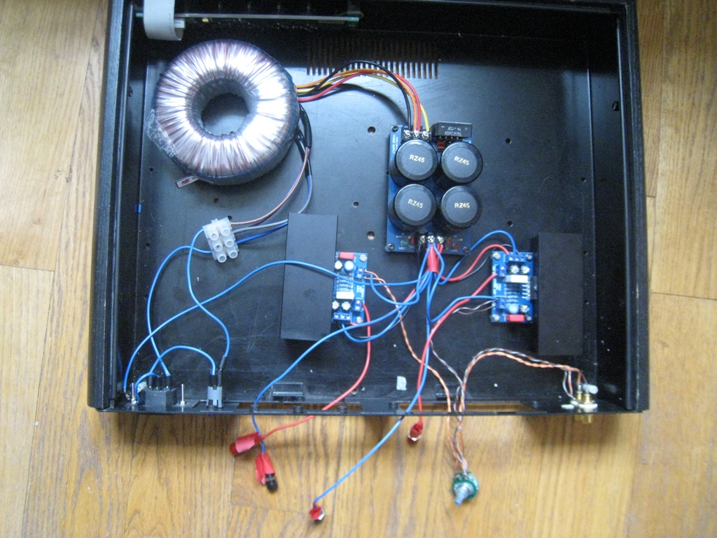

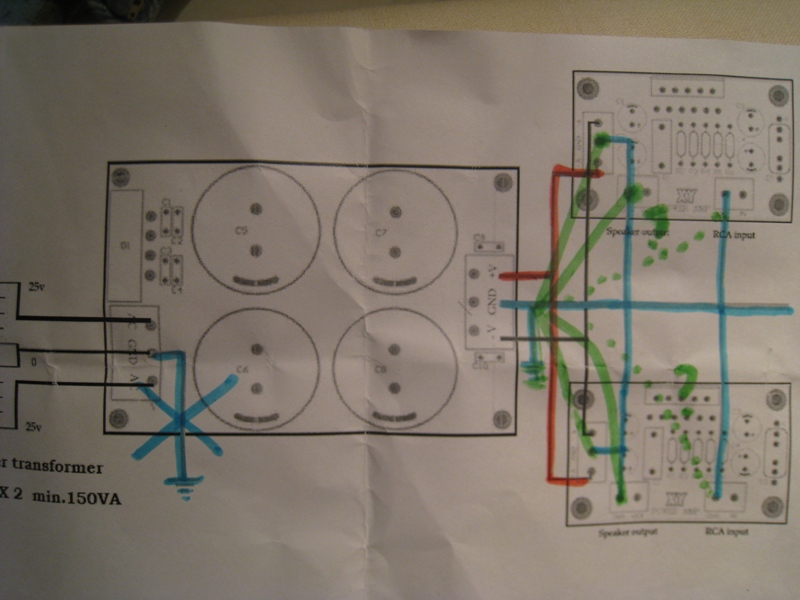

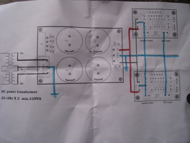

Optimum Gainclone grounding arrangement
small NP0 ceramic 2.5mm (0.1inch) pitch maybe 47pF.
Do not extend the short legs. Bend the earth lug up close to the signal pin and solder the cap across the gap.
You can also solder a 2M2 here, to give a ground reference to the input pin when the RCA socket is empty.
