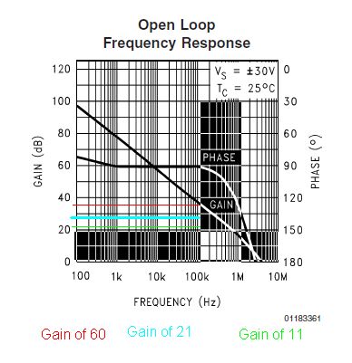

My question is one of interest to my amp designs,
What is the optimum gain setting for a chip amp?
How can one determine with electrical testing?
Or does this gain more affect the dampening of the amplifier?
It is also specific to speaker types and loading?
Obviously, too much will give rise to phase shifts at high frequencies. Too little is also unstable to the amp. The LM3886 chart attached shows acceptable application from gains of 11 (green) to 60 (red line) for the audio range of 5hz to 100khz. Cyan line is the typical noted 21 gain (blackjack!).
in an unrelated thread... Ratza noted
"Put a step/rectangular signal at the input and the oscilloscope on the output. I doubt you'll like the oscillations. What do you think about the open loop frequency graph at the page 16? Phase margin will be only 30 degrees."
But, I have a hard time using pulse waves to determine amplifier optimums. The wave is DC with high frequency and the bends, both outside the bounds of the normal audio bandwidth. The ringing in the transitions may be more related to the power supply rails keep up the instantaneous current draw of the amplifier.
I have tested gains of 21 (26.4 db) and 11 (20.8db), but find musically that the lower gain provides better control over speakers with the LM4766 chip amp (tested Klipsch, Hartley 300's, and custom built Seas). I also choose gain of 11 because my old school sound craft preamp put out +/-6 volts. The lm4766 chip actually has a little better phase margin, flat to 200khz @ gain of 30db compared to the lm3886.
For this range of gains, is the optimum related to chip type?
Digest this and let's see how one would best approach a test plan...

As you decrease or increase the gain, the amplifier performance will deteriorate one way or another. When you reach the limits it will become unstable. With the LM series that is usually the case below 10x (20 dB) or above 50x (34 dB). The recommended 21x (26,4 dB) is nearly in the middle and probably the best technical compromise. Some Forum members claim that listening tests show the best results with the 33,35x (30,4 dB) setting used on the Gaincard.

I didn't say that it sounds bad with low gain. The trouble is that at fast transients it tends to oscillate and from what I've seen it also runs warmer (the oscillations might be one possible source). When I made the tests at work a couple of years ago, I tried gains of 13 (12k/1k), 23 (22k/1k) and 28 (27k/1k). From what I remember the sine was perfect in all cases, but rectangular showed the problems. The oscillations were damped, but the amplitude was too big for my taste.

SOA depends on the supply voltage, the output current and the temperature. It is independent of the gain.
The overall gain should ideally be set so that you can achieve the nominal output power with the weakest source you have. Usually one tries to get away with as few gain stages as possible to maintain complexity and cost low. You would e. g. add another gain stage aka preamplifier when the necessary gain becomes so high that a single stage's own input noise becomes audible at the output. (A problem of a certain chipamp kit with preamp from China that is sold on ebay. The preamp's gain is so high that people usually complain about hiss.) In such a case you cascade several gain stages and choose the gain of each stage so that its own input noise after amplification remains below the noise floor.
