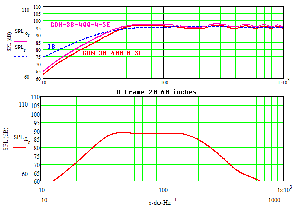

Here are the drivers that perform well in isobaric TL:
GDN-38-400-8-SE
GDN-38-400-4-SE
available in aluminum basket too
I'll be testing them in 1:10 isobaric TL but with custom 16Ohms version.
